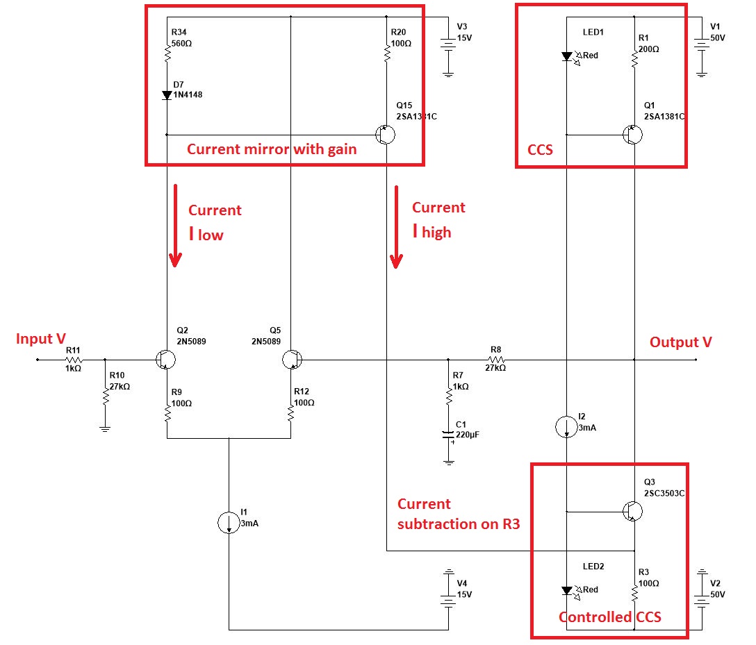

Current drive
Hi David,
I started thinking in this direction as well.

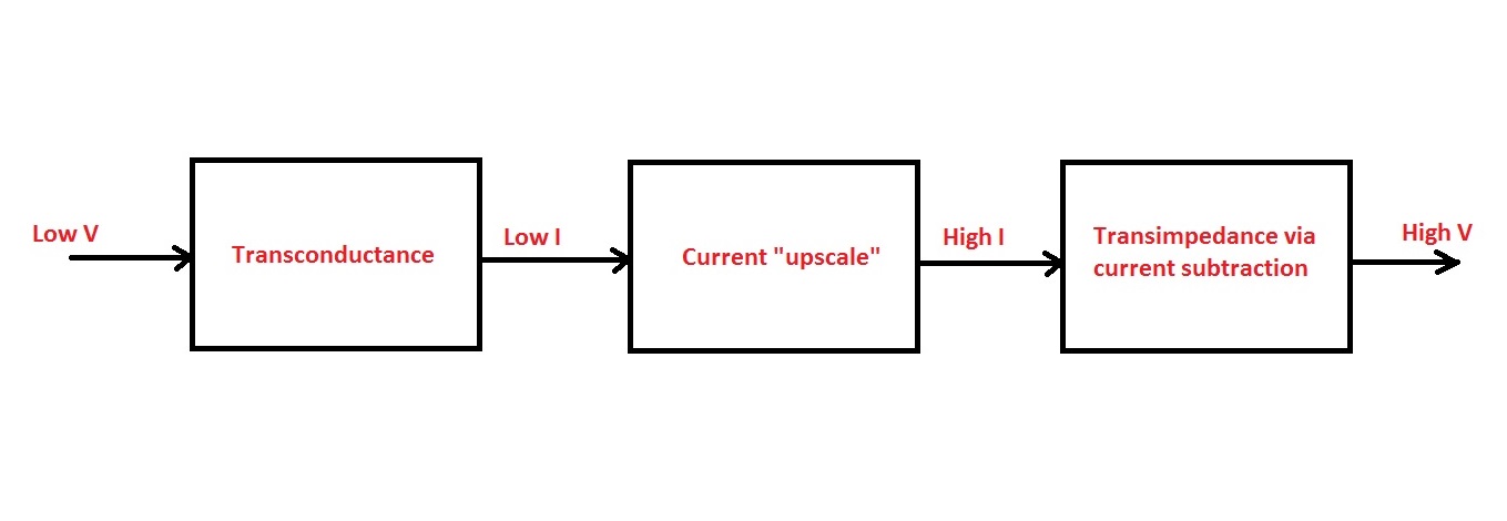

It's already more than a year since I'm using current drive for the front-end (voltage amplification) designs.
Attached are a few pictures to explain the approach.
The biggest source of non-linearity is transconductance stage at the input - although there may be some better implementations - trying to keep it simple here. All the further operations with current are excellent, including the transimpedance stage - simple linear conversion, subtracting the current through a single resistor.
The whole thing demonstrates very good phase response, requiring very light and simple compensation (a few pF lead and 10-20pF shunt at the output), as well as rather low open loop distortion levels.
I've got many working design options now - driving the output CCSs at both shoulders and even driving them at 4 points - that's my favorite X4 I'll show you later.
Coming back to the topic - I'm thinking about using a similar kind of approach for the output stage - you're just giving me more inspiration now 😀
What do you think?
Valery

I find basic theory pushes ideas that don't look like a classical "Blameless" circuit.
My interest is not to create a different circuit just for the sake of novelty but the easiness of a Blameless copy has perhaps meant other options have not been studied carefully.
I am interested in what an optimized amp would be if we started with a blank paper.
The usual Miller compensation around the VAS/TIS lowers the output impedance.
The comparative nonlinearity of the Vbe/Ic curve compared to the Ib/Ic curve, that you noted, would imply that current drive is more linear and the lower impedance may not be helpful.

Valery, can you explain (for beginners like me... 🙂) whats the main difference when the
signal/substraction is kept in a form of voltage and when in form of current?
I mean there is voltage and current in every solution? What does it mean that the signal is rather a current?
For example in your schematic: Q15 is a standard common E amplifier stage,
when can one say that it's output is a voltage or a current one? Thanks!

It's a matter of impedance.
Low output Z, high input Z = voltage transfer
High output Z, low input Z = current transfer
And for the sake of completeness:
Output Z equals input Z = power transfer
In the case of Q15, I'd say we're talking at least a few kOhms of Z_out vs. <100 ohms of Z_in at R3 || Q3_E.

...I think what you envision is... common emitter OP devices driven by common emitter CCS's.
Smart deduction😉
In fact I became interested in CE output devices both for feedback optimization and also for efficiency.
And once I started to consider a CE OPS then the conventional wisdom of EF OPS is not much use so I started to consider how best to drive such a CE OPS.
I have already made preliminary explorations of this idea, mainly because it can solve the bias/thermal compensations issues encountered in a classical OPS: the beta does vary with temperature, but it is a far cry from the exponential dependency of the collector current...
Yes, exactly so.
What halted me is the beta non-linearity of usual power devices, but otherwise, it could be a worthwhile solution
Still better than the exponential Vbe dependency.

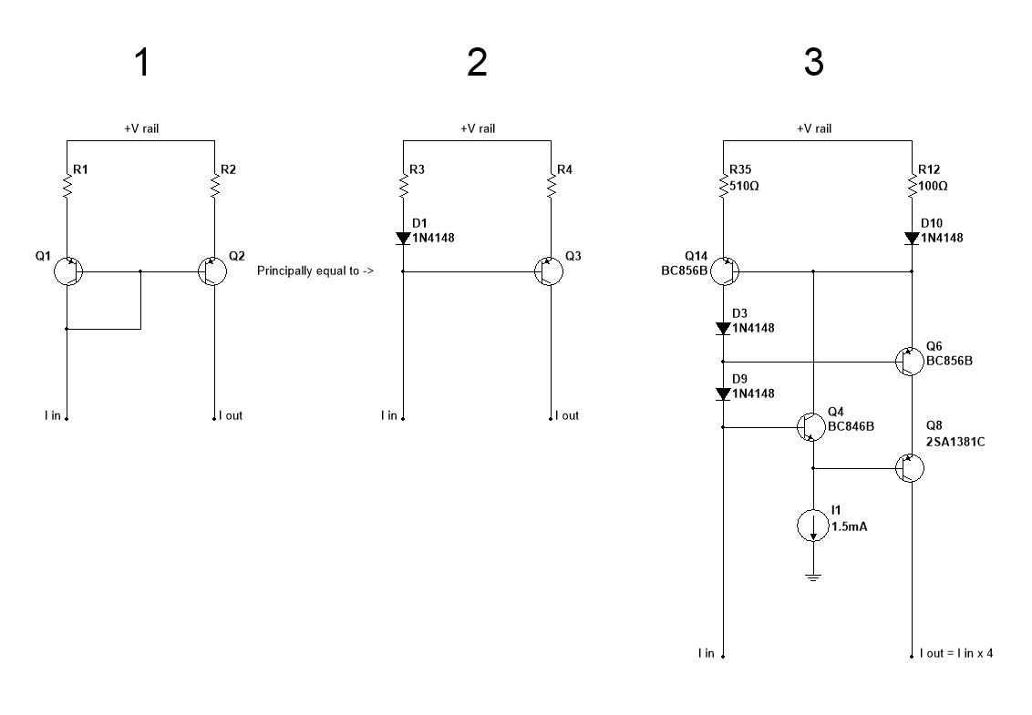

Cortez - just a bit more of explanation - Q15 is NOT a standard common E amplifier stage here. Because of D7, that makes a big difference for this arrangement.
See attached. Circuit 1 is a standard simple current mirror. Circuit 2 is its equivalent, where Q1 is replaced with the diode (D1). This is a simple current mirror as well. Now - we can make it multiplying current, if we use emitter resistors with different values. Providing a rather linear current gain.
David - simplified schematic, attached in post #3 is just for principle demonstration. The key thing I'm sure - the amplifier is going to be organized, as outlined on picture 1 in that post (with the boxes).
Practical implementation, thinking from scratch, most likely would be:
- Complimentary pair as a transconductance stage and NFB junction point (probably a jFET pair);
- Sophisticated highly linear current conveyor;
- Highly linear transimpedance stage at the output.
Circuit 3, attached here, is a sophisticated current conveyor component, I have designed for one of my recent low-distortion amplifiers. It's an enhanced Wilson mirror, combined with an improved Hawksford cascode.
Precise, fast, highly linear, also demonstrating excellent overload behavior (soft clipping).
Now, the question is - do we need a buffer at the output for having the output impedance low enough? Probably yes. However, assuming certain amount of global NFB, its configuration requires more thinking and test simulations.
Valery

...phase response...
Hi Valery
Surely the phase is directly determined by the amplitude response, in other words, the system is minimum phase?
So the phase response can't be any better than any other similar circuit with the same "frequency response".
- Highly linear transimpedance...
A bit late here so I will respond in more detail tomorrow.
But one possibility is to build a two section amplifier, with an IPS and a "Power VAS" (for want of a better term) and drive the speakers from that final CE.
Kind of a power amp version of a rail-to-rail op-amp, similar to the way the Blameless is a power version of an old op-amp.
I have already had a few ideas for a complementary JFET front end, looks excellent.
So my interest is how to connect that front end to a power second section that is basically complementary rail referenced CEs, preceded by EF buffers.
