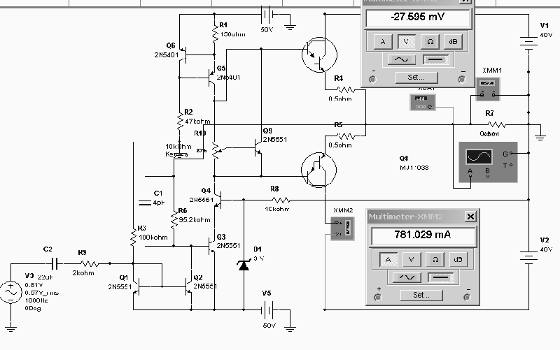

From LM359(Norton OP AMP) PDF,I design this power AMP.
1.It use all NPN type tranistror.
2.The THD is low and even harmonious much more than odd harmonious. At Vout=4Vrms( 8ohm 1Khz) THD=0.1% and even harmonious(2KHz) is -43dB,odd harmonious(3KHz) is -67dB.
3.I think it is a CFB amp.

Good circuit 😉

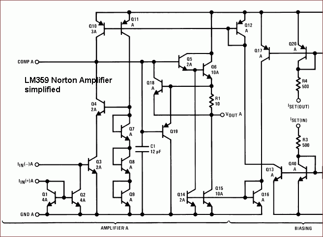

Norton is interesting.
We can get VERY FAST amplifiers like this.
I attach the LM359 circuit diagram.
