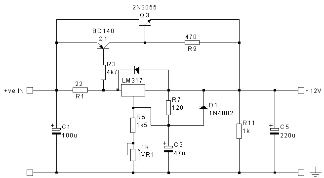

wanna build agood regulated linear ps. for a small car amp. which
iuse it here at home, the ICs inside works directly from a 12v.
source, iwanna current boost the lm317 regulator using the
common 2N3055 pass transistor,
idid a search & found this one attached, iuse a 12-0-12 center
tapped 10A trans. with 15A bridge rectifier ,have about 30,000
or more as needed filter capacitance ,ijust wanna make sure that
the ps. would give about 6A continously for the amp.
so how much current this schematic would produce?
any mods. needed to achieve the requireds?
thanks alot guys..

It should work. But watch out for the power being dissipated in the 2N3055. If you use a standard full wave bridge you'll get about 30 volts from your transformer, with 12 volts output at 6 amps, the transistor will give off (30-12)*6 = 108 watts of heat, which is not practical. Consider parallelling a bunch of output transistors.
A full wave centre tap (2 diodes) instead might work.

Consider using a Darlinton
I would switch to a Darlington transistor you can then decrease the drive current. Also, the LM317 and LM337 and be biased with a zenner. The regulator will also work at 1/4 National recomended biasing with out losing regulation. Of course you could just use a 7812.

the transformer iuse is 12-0-12 , so after rectification iwould get
about 18v. , as i use only the +12 & the ground not the both rails.
so what do u think now?
