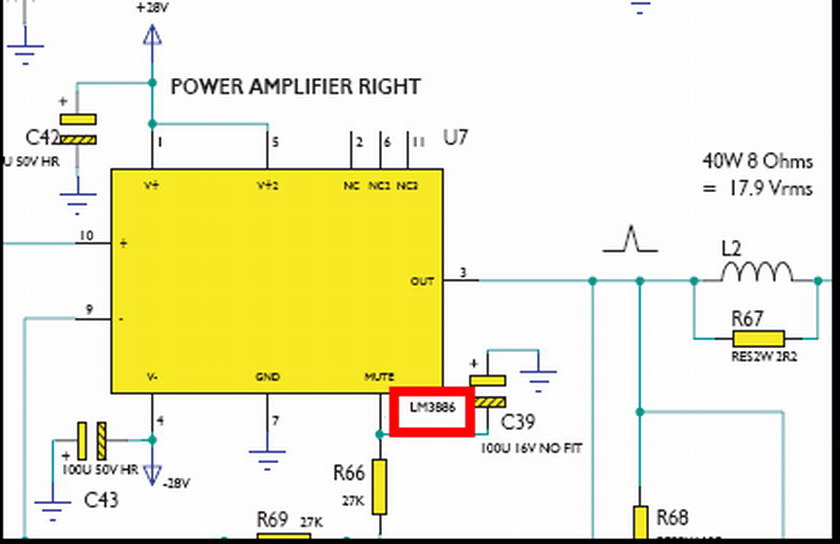

Schematic?
Of course would be interesting for all of us.
Pictures?
Inside pictures?
regards,
Carlos
Model 340 looks alike a Gainclone..this one you are talking about i am deeply curious to know something about the circuit... Doctor Self's circuit i think.
