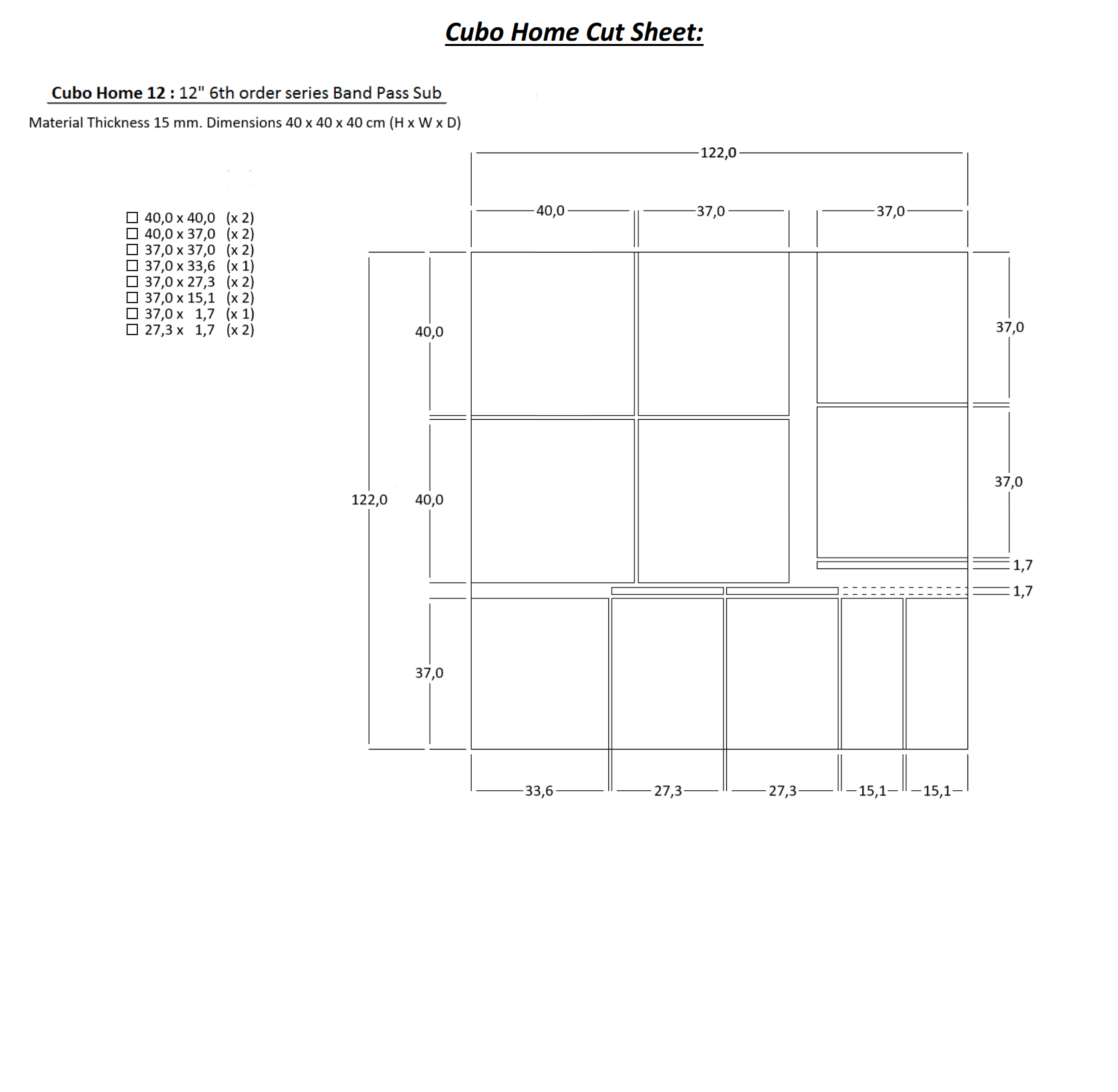

Metric Construction: Cut from half a sheet of 15 mm MDF (122 cm x 122 cm), no angled cuts.
Imperial Construction: Cut from half a sheet of 5/8" MDF (4' x 4'), no angled cuts.

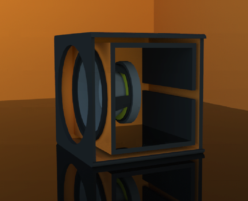

Front-firing:

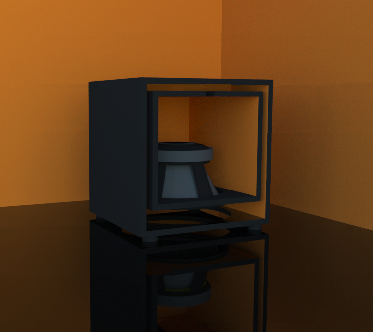

Down-firing:

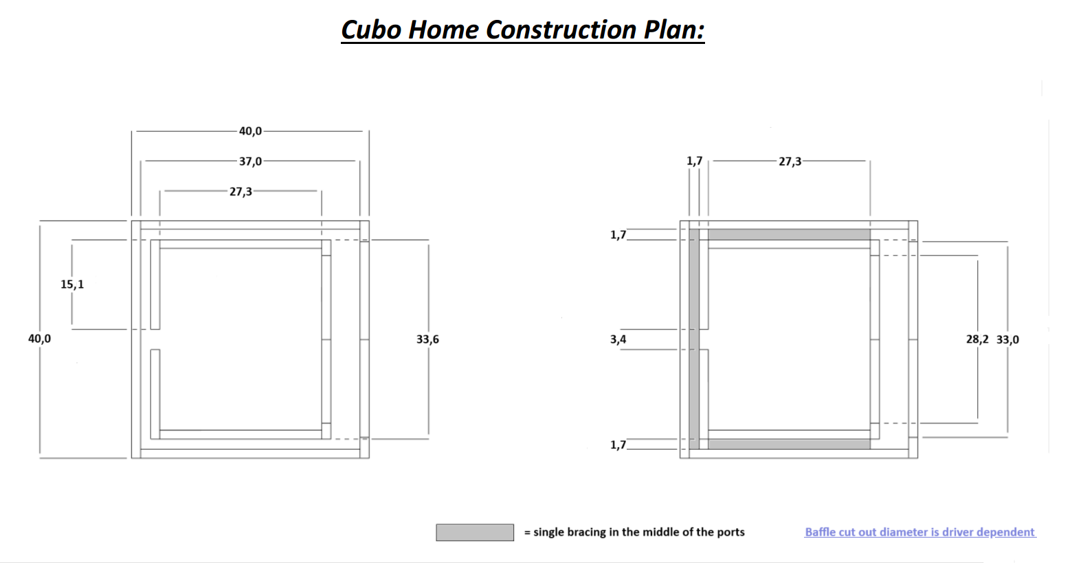

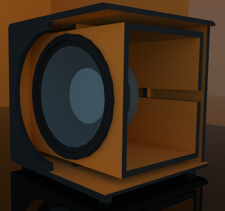

Bracing/ detail:
Metric Construction Plan:
Metric Cut Sheet:

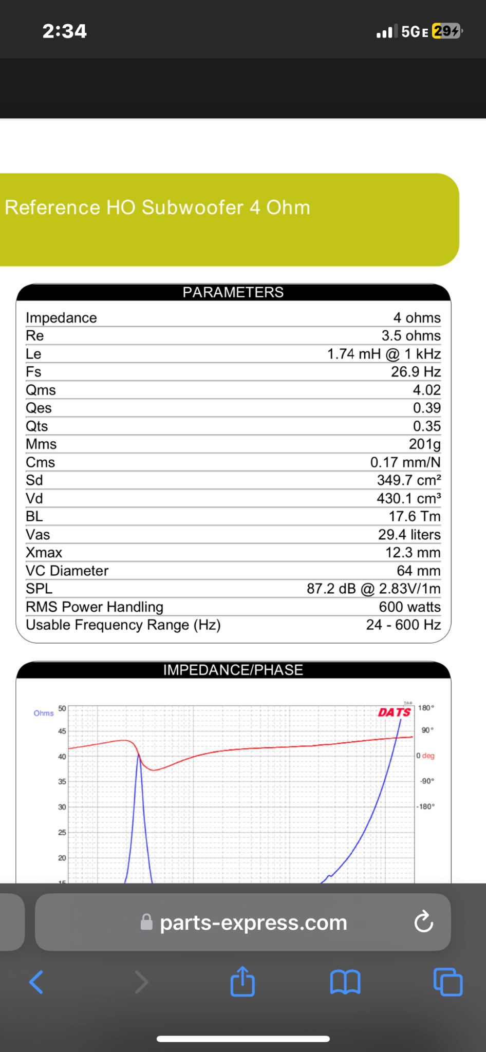

How big is the port ? Maybe this will work 🤷🏼
https://www.parts-express.com/pedocs/specs/295-462-dayton-audio-rss265ho-4-specifications-46173.pdf
