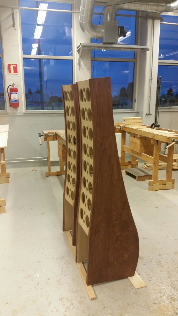

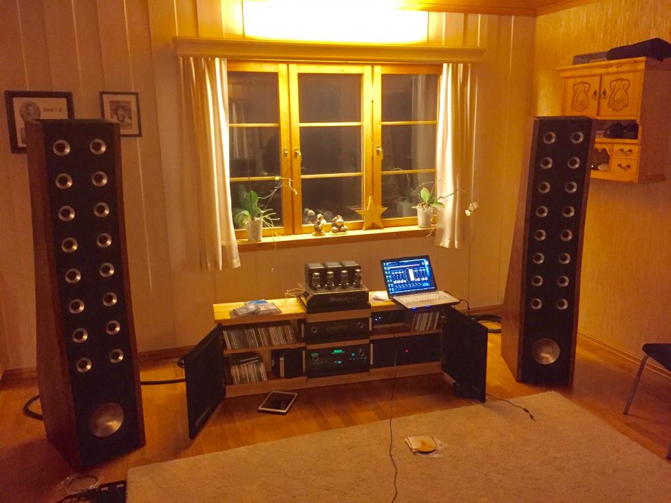

Just for amuse/confusment 🙂
A (very) old line source project that turned into something different:
A curved open3-way active MTM+SUB baffle Radius is approx 5,4meter
We intend to place the holy listening chair between origo (circle's center) and speaker where the listening window height is 50 cm.

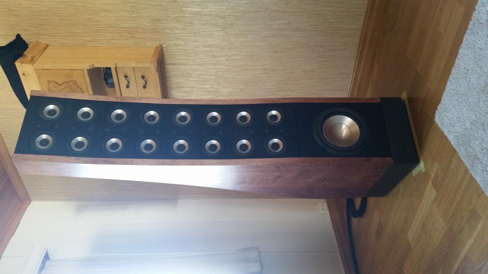

Finished
The CuBa luckily proved to achieve its goals.
Crossover is MiniDSP 4 HD together with Dirac Live amplified by Anaview.
The listening window is tuned (by dirac mic) to approx 0,5 height.
Crossover got the much preferable Harsch topology.
Visiting listeners says that dynamics are similar to big horns, but completely without any stressed notes. Sound space are wide, deep and detailed.
When you leave the listening chair, the optimal scene and micro details flattens out. The single 10" Seas ROY got enough capacity for all types of music, but a 15" sub-woofer will add additional tactile drama.

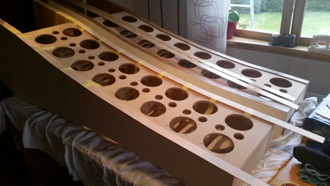

The concept with full directivety and equal distance tempted us to start another project, but not an open baffle this time, but a curved closed array.
A new thread will follow by soon. (The 16 tweeters are not visible on the pictures as they are hidden behind a thin fabric)

Thank you guys! The next thread about curved array will be named "Bendit".
Maybe "sector array" is a better description as the line is a part of a circle (R=5,2m)?
