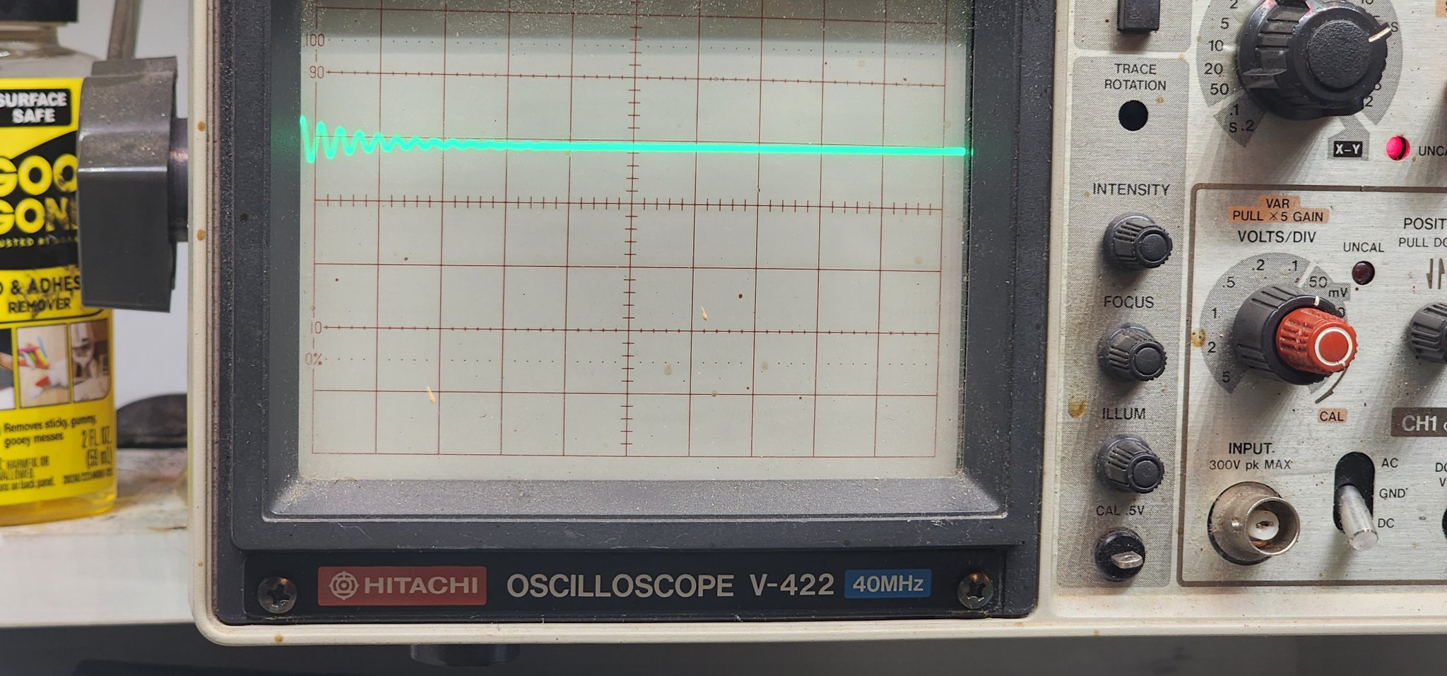

Everything seems to be working but I'm not getting any signal for some reason. All I see on the source of the lowside is a 2.12khz squarewave no matter what the input signal.

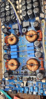

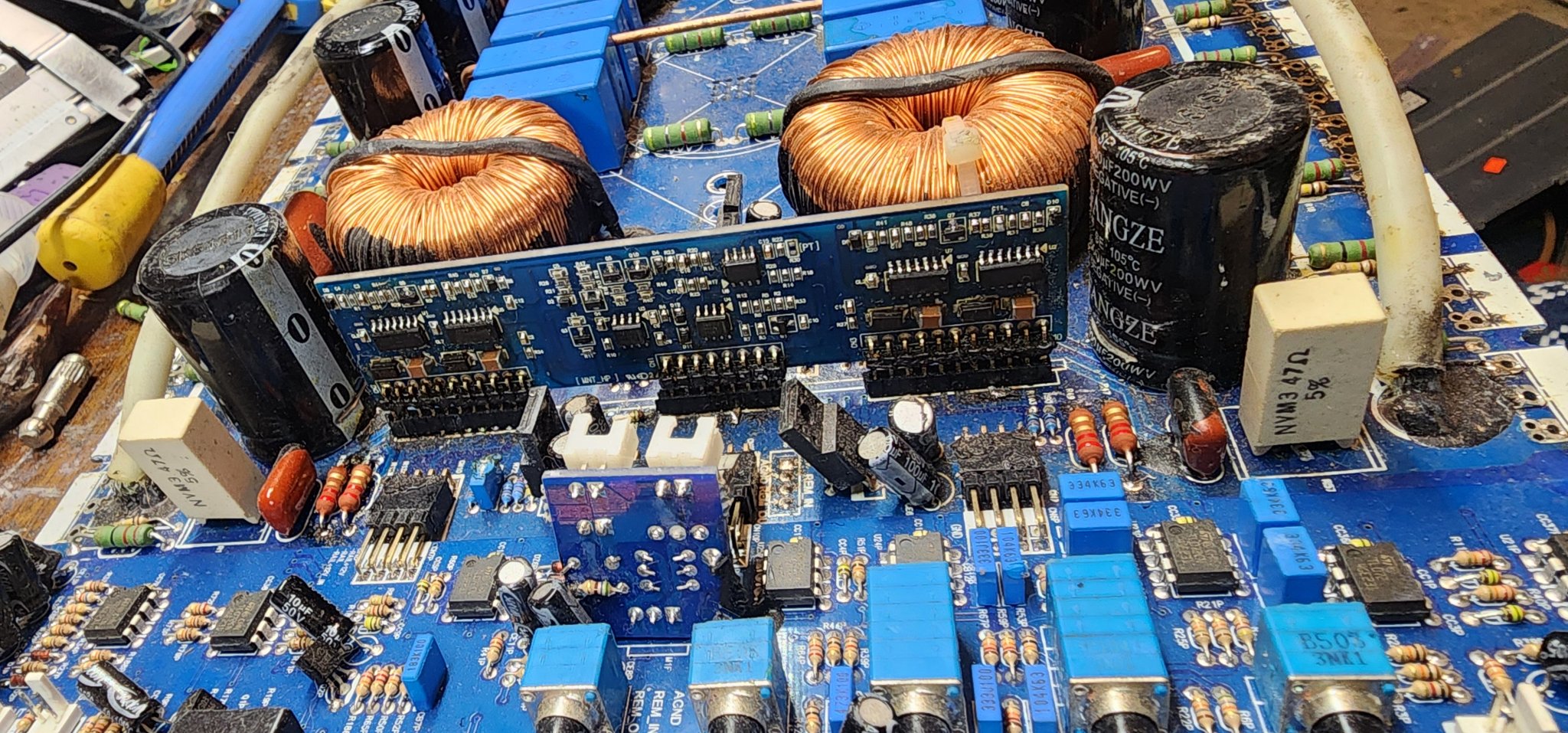

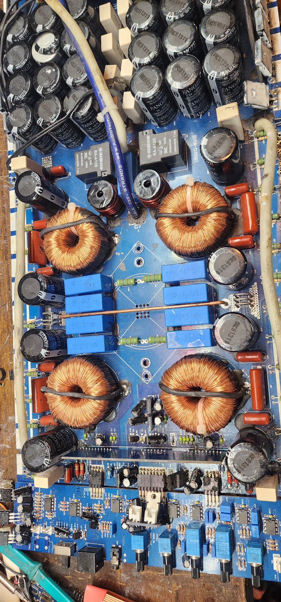

The amp now fires up and everything seems to be working bur when I let off of the remote I instantly have 10.5v on the drain of the lowside and the gate and source of the highside. It goes from a few mv to 10.5v
This is without the driver card in.
Measuring DCV across the gate and source of the high-side FET with your multimeter, while monitoring the voltage with your scope on the low-side drain, do you ever read more than a fraction of a volt on the meter?
With the meter across the gate and source of the high-side FET, do you still see the 10v DC on the drain of the low-side FET?
FETs still out of the circuit?
If you load the drain of the low-side FETs, does it prevent the 10v from building? Start with a light load, like a 1k resistor.
Yes the fets are out.
Something interesting I noticed is that it happens with just the remote and ground hooked up it just jumps from .1mv to 600mv but it does change.
To load it put a 1k resistor between the lowside drain and what?
Speaker negative if this isn't a bridged (H-bridge, full bridge) configuration.
If it is, to a secondary ground.
Try lower values.
Is the muting/shutdown input (SD pins on the driver board) following the same pulse?
How is that scope image different than what you had before?
Scope settings?
Scope settings?
