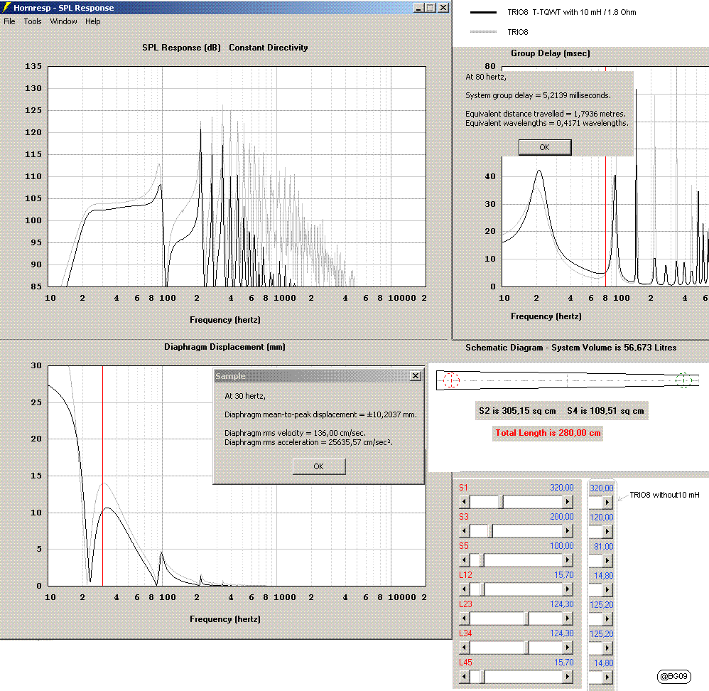

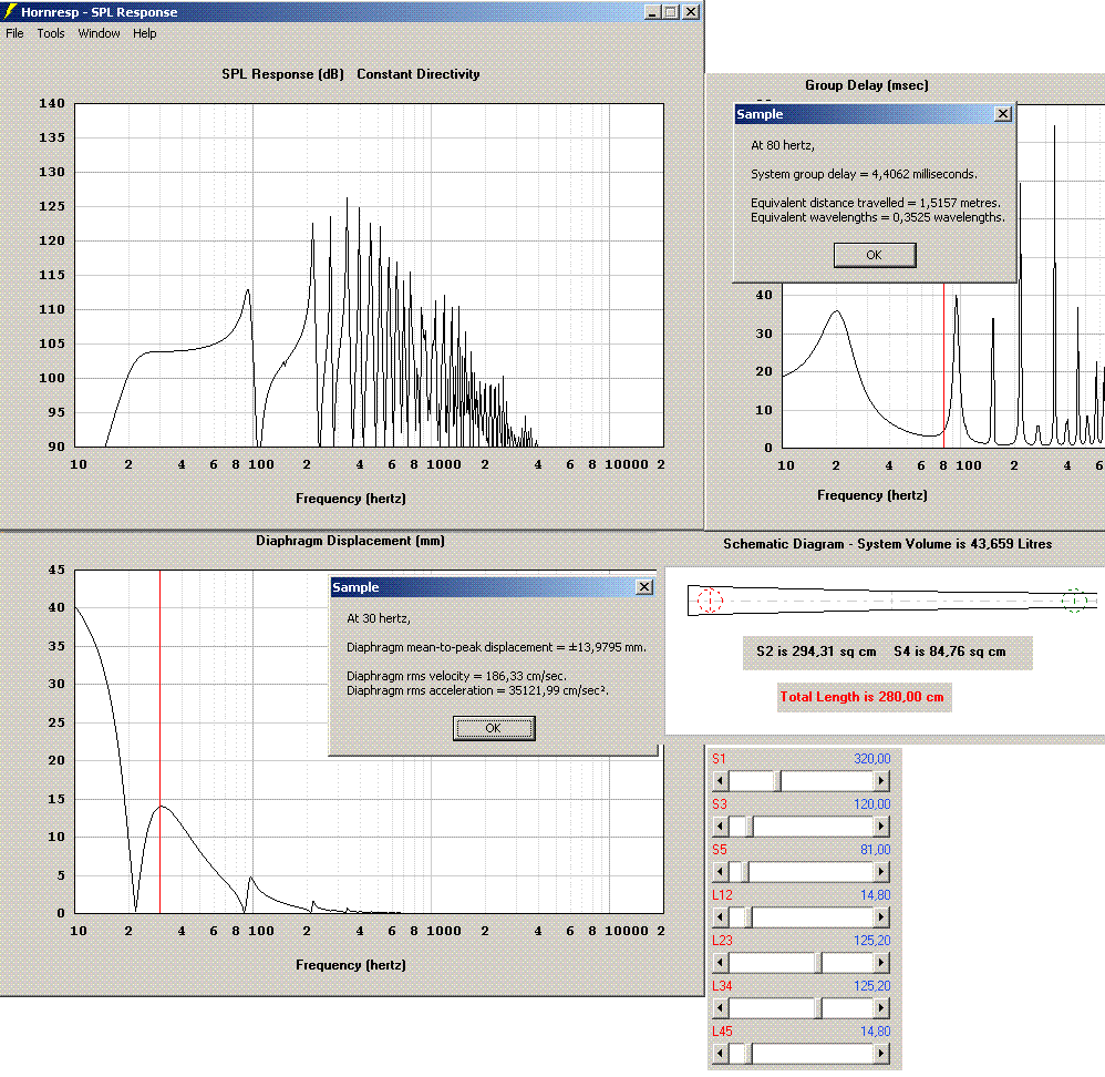

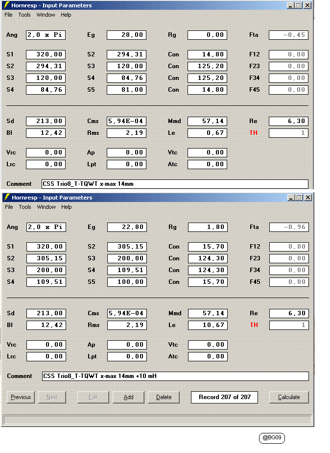

..What alignment? What cabinet volume? What lowest frequency is practically achievable?..
A T-TQWT in about 40-60 L is possible with a FR stretched down towards 20 Hz. See the simulations: 1(3)-3(3).
b

Bjorno you know what you are doing!
That's a beautiful example of effiecient use of a driver and an enclosure.
Mark

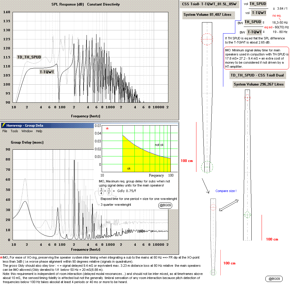

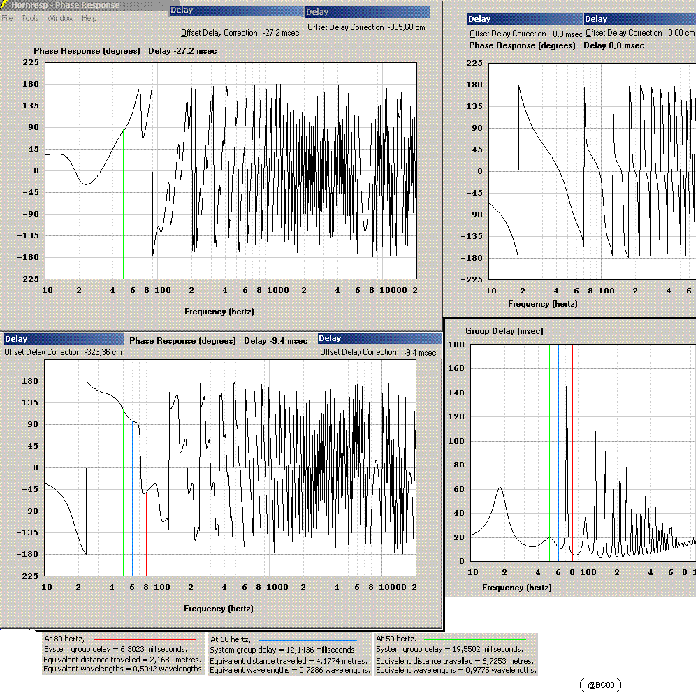

Hi all,
FYI: Some sub designs for use in homes seems to follow a motto I've found is valid : Up climbs the SPL but down goes the SQ . This if used as a single sub unit and not masked by other sub(s).
I have nothing against TH:s in general but from what I've experienced from studying designs here at DIYaudio:
Most shown TH designs must be amplitude equalized, often at an extra cost if not already provided built in by the sub amp.
Obviously its often necessary to signal delay the mains too, causing even more money to be added for the total implementation cost for this TH type.
That of course if not using an amplifier with built in user defined signal delay time capabilities.
Most aware users (IME,IMO) have the intention to integrate with expected good timing(phase) performance at the XO point.
b
Comparing GM reffered DIY-SPUD :
http://www.hometheatershack.com/forums/diy-subwoofers/16807-tapped-horn-build-th-spud.html
with my T-TQWT: 1(2)-2(2)
I have nothing against TH:s in general............
Greets!
Too often true.
Well, as DSL's designs and 'geitmans' TH has proven, proper damping, XO point/slope plus room loading solves all but the time delay issues, so combined with the large size there's no 'free lunch' for the extra gain.
Still, as you know I agree that the T-TQWT (aka BP-TQWT) is a better choice overall for most consumer apps, with the even simpler tapped straight pipe fine for most music and HTs that otherwise would be OK with the restricted gain/Fb of a B0$3 or PC 'sub', though AV folks in general seem to prefer being able to see their big 'bada$$' sub driver(s) pumping away in simple sealed or vented cabs, so a 'tough sell' to those who would potentially benefit most.

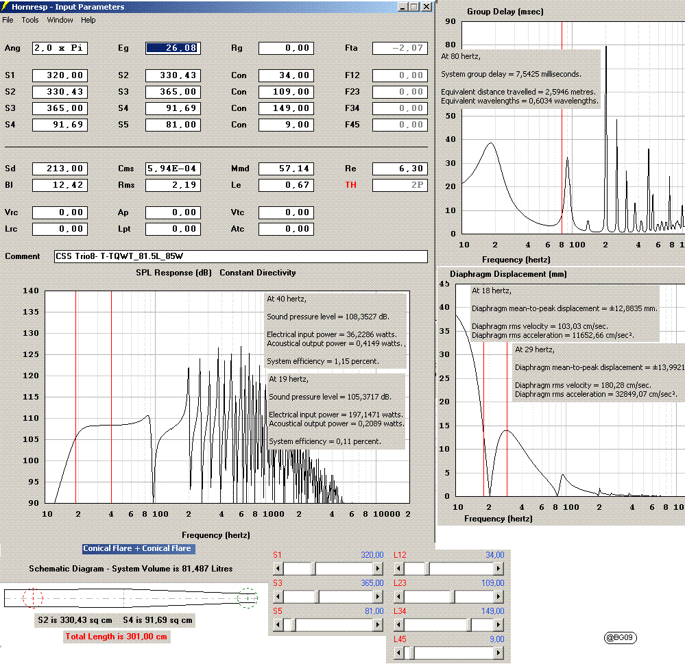

GM, bjorno - do you have any guidelines for designing the T-TQWT? Fiddling in hornresp it seems a multitude of different path length and compression ratio combinations can fit a bandwidth.
This is true since its net Vb is what sets the gain BW same as a BR. I use some old rule-of-thumb based on compression horn theory, but with the advent of MJK's excellent Classic TL Alignment Tables, you can easily design them. FWIW, I'm fond of 10:1 compression (taper) ratio, but for more slender one fold designs a lower one is perfectly acceptable.

Thanks GM. I've had a fiddle with the calculator/tables. I notice the alignments are designed to produce a quarter wave at driver Fs. And I'm not sure how to usefully translate the alignments to a tapped layout - using an L34 that will actually fit the driver in increases the ripple well past what's there when simulating it as a regular TL using hornresp's combined response option.
