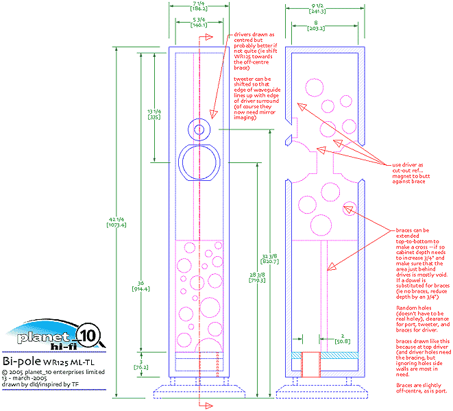

Tim is successfully using the weird bezeled Fostex, if you just plan on letting the WR125 run full out it doesn't take much tweeter to fill in the top octave.
It may be sacriledge, but in our 1st crack at this puppy, we are going to waveguide load the ApexJr 50 cent tweeter. If we decide that doesn't cut it we will upgrade to the Audax gold dome version. In this ap, as general guidline, the smaller the tweeter the better.
I'll let you guys know how it works out when Scott brings the boxes down. (BTW i'd be happy to toss in a pr of Ts with any pair of WR125 purchased -- i note no one has mentioned the price drop in the WR125 -- at least the 8 ohm version)

The cab volumes were calculated around the WR125ST although the WR125S should work also. I like the way the WR125ST behaves with tube power, however, an interesting side benefit of the XBL^2 motor is it's stable impedance. You could parallel a pair of WR125S and be able to call it 8 ohm nominal as the low impedance point is still well above 4 ohms.

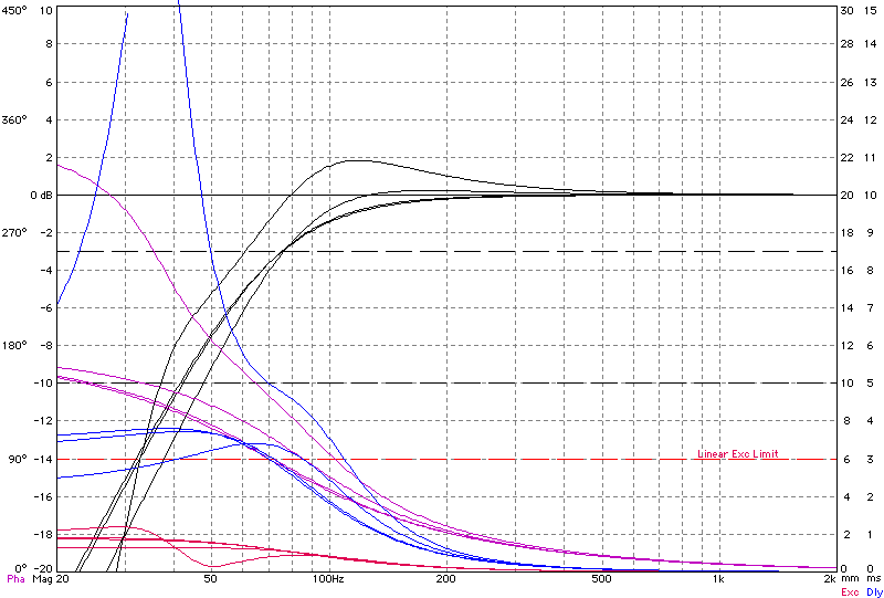

Can someone please tell me the correct volume for a sealed bipolar WR125S? I've used two calculators and they're giving me different answers (28 vs 52L).
I entered the specs in WinISD myself, so I may have made an error.
The answer may depend on what your goal is. Do you have a specific F3 point in mind? The volume numbers you've posted produce nearly the same F3 point however the smaller box will give you a rise approaching 100Hz before it rolls off.

Timn8ter said:The volume numbers you've posted produce nearly the same F3 point however the smaller box will give you a rise approaching 100Hz before it rolls off.
I don't get it. I used this calculator http://www.mhsoft.nl/spk_calc.asp#sealed
and WinISD and specified a Q of .707 for each. How the heck do they give such a different result?
I happen to have a pair of 50L cabs with no plan, so that interests me. I'd love to stretch f3 down to 60 Hz but OTOH I'd prefer a sealed box.
I don't know what to tell you about the on-line calculator but I can say that the 50L sealed box should perform nicely and give you extension to 80Hz which still allows enough wiggle room to roll to a sub. Should work well.
