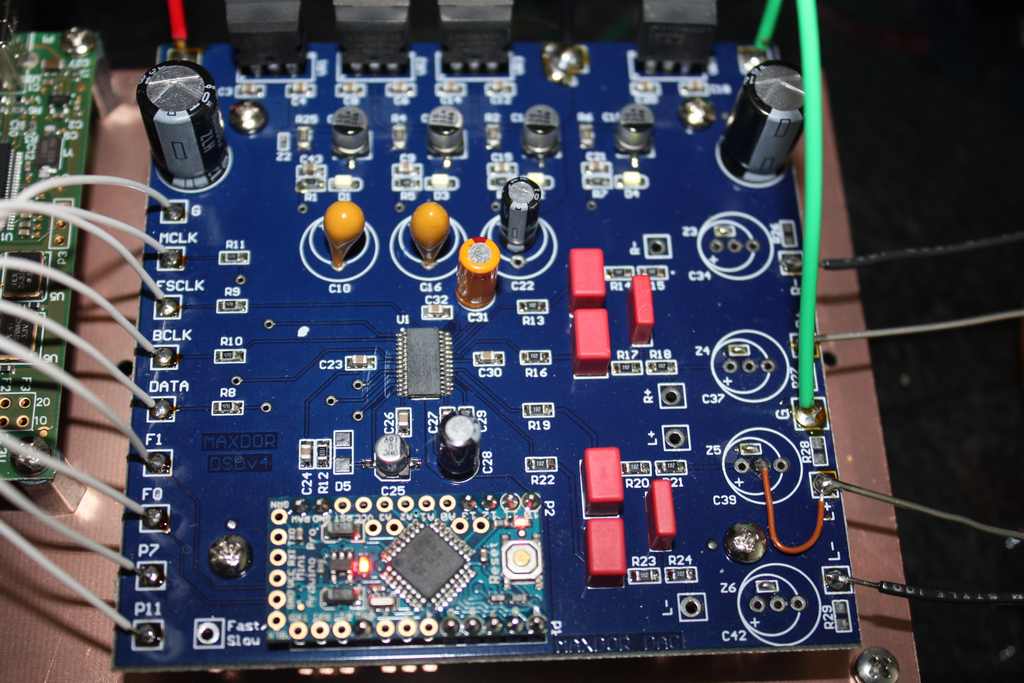

Does the cs4398 support DSD256? The Lampizator board seems using this chip,
