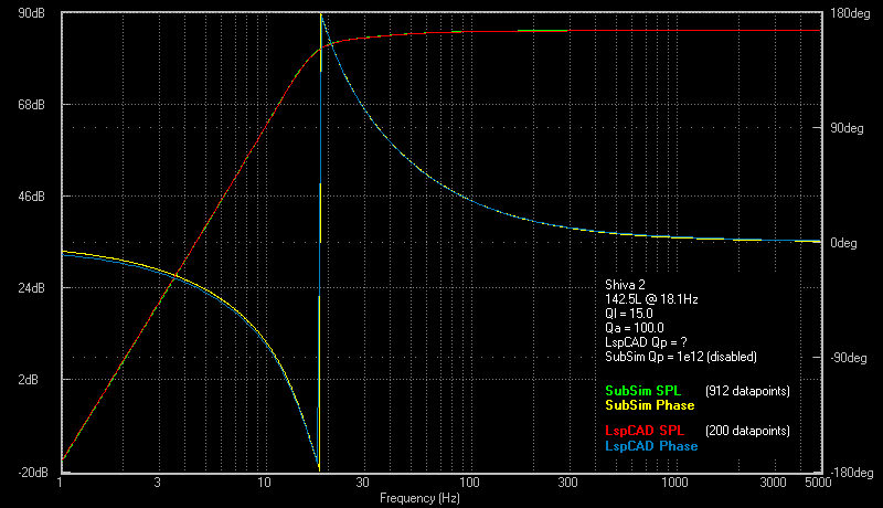

Stay Away From Those Free Programs
Hold on a minute, not all freeware programs are as bad as you might think. Here is a screenshot of outputs from both LspCAD (a significantly better program than BB) and Subwoofer Simulator (another freeware). As you can see, the outputs are practically equal. Give SubSim the default sound speed and air density of LspCAD and this screenshot should look even better still.
Bass Box is good, but not that good to justify its price tag. It doesn't even model motor/suspension non-linearities, which makes it no better than any of the freeware programs. BB does have 'wizards' etc. to show for it, but again not worth the retail price.
Can BB do what these programs do? For free? 😀

Bass Box pro offers cone displacement
The freeware programs mentioned here offer cone displacement as well. (SubSim displays one-way peak, not RMS, excursions)
maximum acoustic power, and, maximum electric input power.
I was refering to this feature of BB when I mentioned its inability to model non-linearities. BB is based on small-signal models, which means its excursion-power-limited curves are optimistic at best.
Stay Away From WinSD
Don't be so hard on winISD 😀 The release candidate will surely be a good one 🙂

The above-mentioned freeware programs can do that too. One may specify his/her power/voltage, driver(s), box, room acoustics/dimensions, calculation options and so on and see the results. They are totally customizable
The point I was trying to bring across is that BB does not have accurate Max Acoustic Power and Max Electric Power curves because its internal models are only of the small-signal type. So it does not matter if you put RMS, short term, program or music power -- the results are not accurate. This makes BB no better than any freeware tool. To accurately calculate max output/input curves, non-linearties must be considered -- something BB is incapable of doing... At least not yet 🙂
I think there is confusion here. A simulator is a simulator -- BB or any other program cannot discriminate between drivers, boxes etc. It does not know a pro, car or home driver from another. These programs are basically input/ouput machines 😎
Over and out 🙂

Some time ago I made a program that could consider braces, ports, wall thickness, driver displacements etc. It used to be shown in my site. But I can't remember if I ever did share it to the DIY community, I can't even remember where I put itI have to keep this in mind for the next SubSim version.

That's why I double check my programs before I release them. And when I finally share them, I ask users to point out possible errors and make suggestions.
Requiring up to millions of lines of code, a program can never be 100% bug-free. Take Windows for example
😀 (SubSim is nothing by comparison; weighing in at just over 17,000 code lines).
