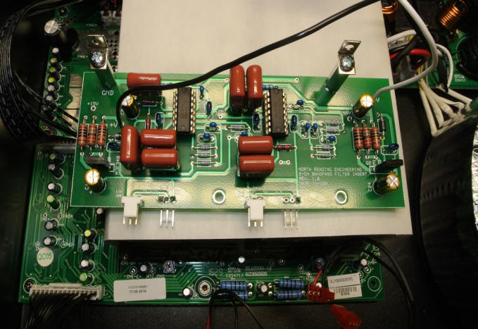

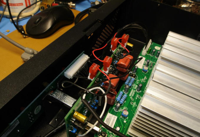

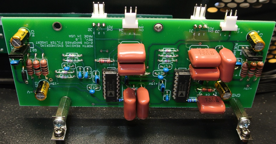

A few photos of the active filter board and its installation in the amp, this case an XLi1500.

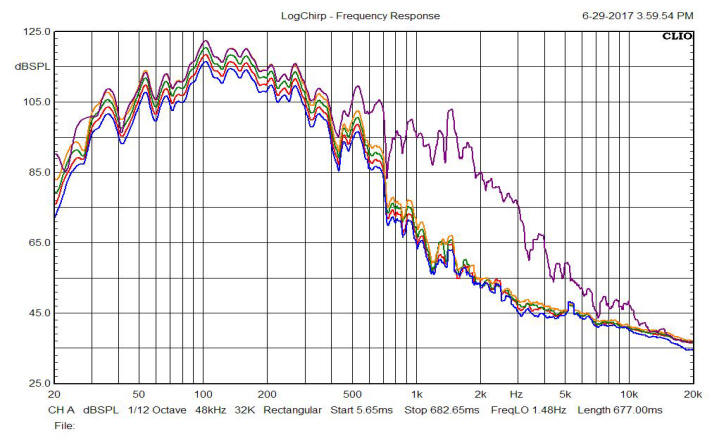

Plots shown below:
1. Response with filter set for bass horn applications (blue curve, no filter).

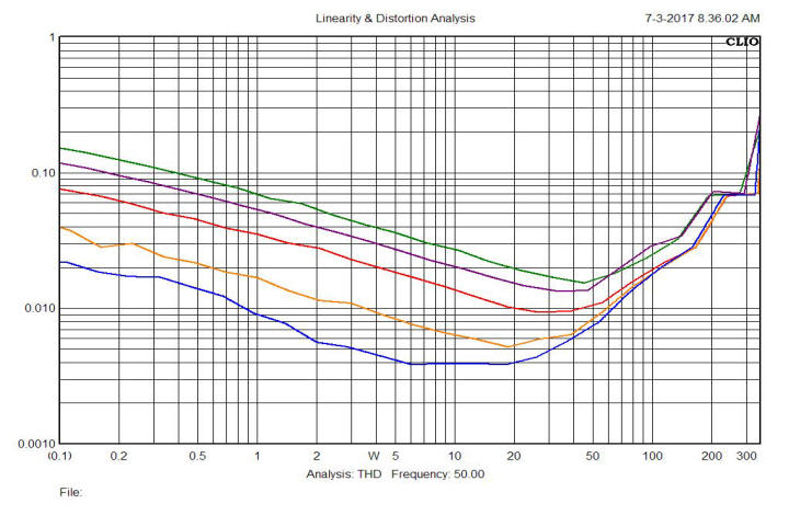

2. %THD as a function of power over range of pass-band frequencies, top to bottom 400, 300, 200, 100, 50Hz.

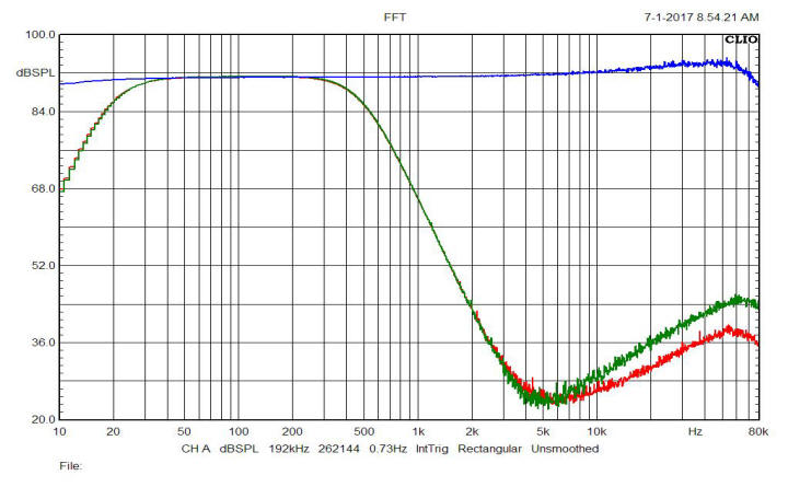

3. Measured response on Klipschorn bass unit with and without the filter active. Bass horn responses taken over a range of front panel pot settings.
