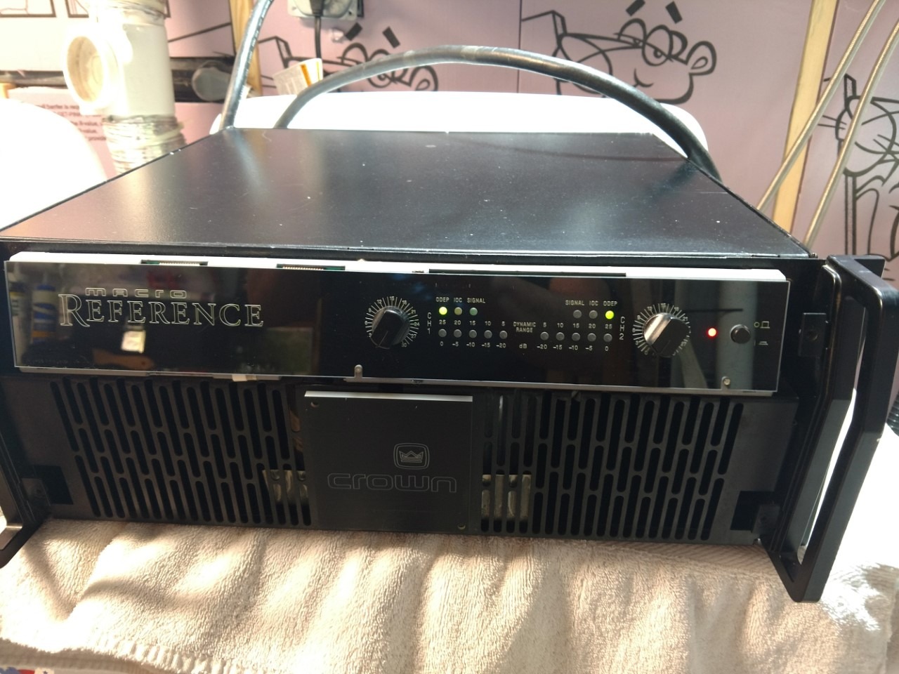

I picked up a Crown Macro Reference amp and the right channel was in protection. I put all new outputs and drivers in it and cleaned everything up and it now works as advertised..... SORT OF..... The power meters work fine but the Logo/Lighting on the front panel is out and I thought the switch just needed to be switched but after taking off the outer face and flipping the switch, it still doesn't work. The switch is fine and all the connectors are connected but that's as far as I can go without having a schematic to follow. By any chance does anybody HAVE or KNOW where i can find a copy of the power supply schematic?
At least it's out of protection and will operate normally.
