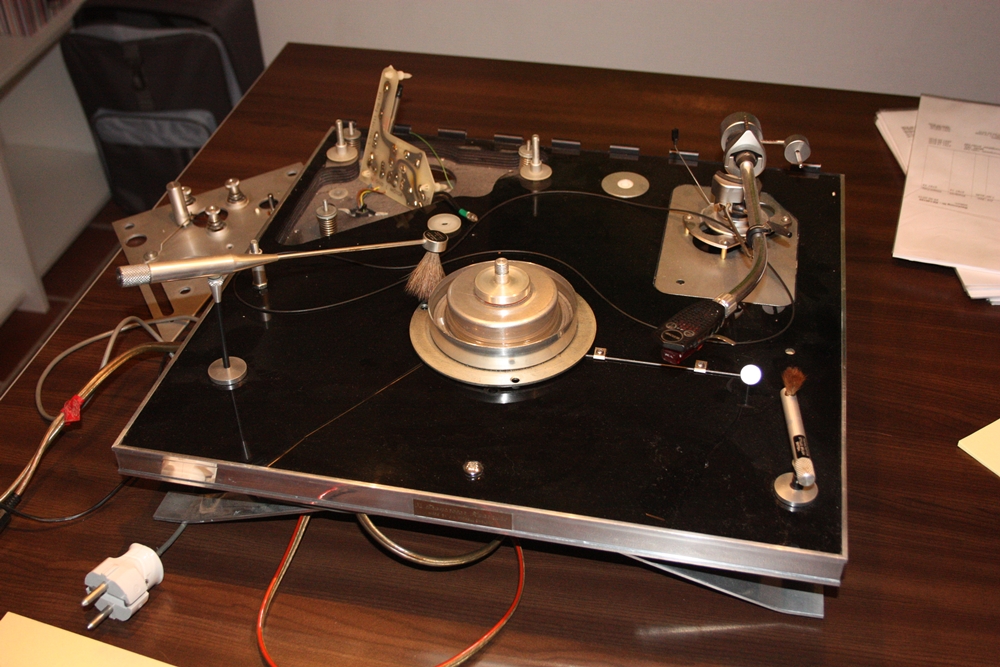

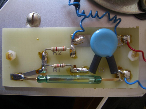

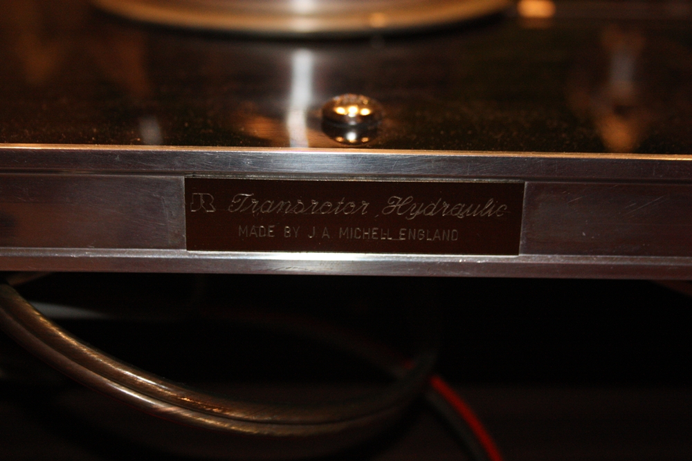

CROUZET-Motor for Transrotor Turntable Model "Hydraulic" - Replacement?
The 115 VAC Crouzet uni-directional synchronous motor without type number has only one phase (only two instead normally four leads and no phase shift cap necessary)
The "ON" direction isn't clear - both directions are possible. To get always the right direction, an internal mechanism is present to determine the right direction.

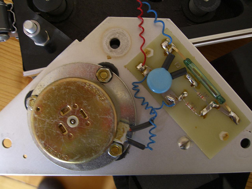

It is, as you say, a synchronous motor. Probably 24 pole. If it does 250rpm, then it's definitely 24 pole. If so, you could replace it with the ubiquitous Philips/Premotec motor now distributed by McLennan. You'll need to add a phasing capacitor, but that's hardly a problem. Your more important problem is whether the shaft diameter is the same.
I know McLennan - it is a good delivery source for the motors inside by different models from Linn (LP-12 and AXIS). There are 250 RPM necessary.

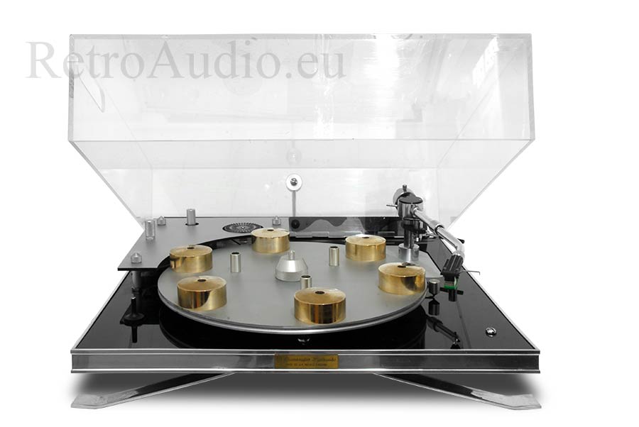

The motor here runs with approximately 580-610 RPM, because the belt is on the outsite of the platter edge (see photo and the milled groove for the belt) and not at a small inner platter like Linn.

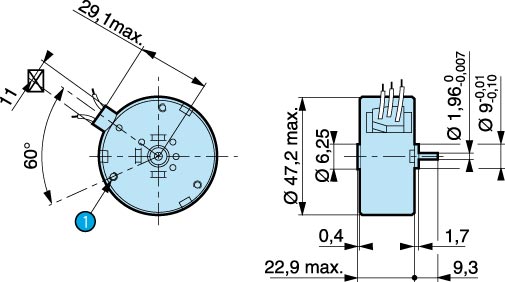

I have discover the right order code of Crouzet: "82 330 582" (82330582)
and some informations about data and some delivery sources:
http://www.crouzet.com/FILIALES/catalogue_web/pdf/ENG/ndb15_eng.pdf
Crouzet | Steuergeräte | Antriebstechnik | AC Motoren | Eine Phase, 240V_6153648_Normal Module |82 330 582
Crouzet Automatismes - Micro-motors - Synchronous motors - Direct drive single direction synchronous motors - 82330582-0.42 Watts
Crouzet Automatismes - Mikromotoren - Synchronmotoren - Ferritsynchronmotoren, 1 Drehrichtung - 82330582-0,42 W
Antriebstechnik & Automatisierung - Ferritsynchronmotor, Rechtslauf, 8 mNm, 82330582 82330582

But now new questions come to me:

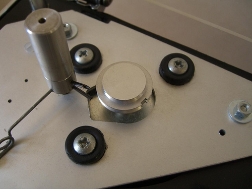

How do I remove the pressing part (motor pulley carrier) sitting on the shaft?
And which tools I need for repressing this part on the new motor?
In the attachement photos from this motor modell inside in the "Golden Shadow"
Removing a pulley isn't usually too difficult. It's doing it without bending the motor shaft that's tricky. Of course, if you know you won't use the motor again, that's not a problem. People used to use spoons as levers, but I never liked that technique. What might work nicely would be some improvised jacks. An M4 threaded spacer with a hexagonal headed bolt going into it would expand as the bolt was undone. If you had three of these evenly spaced under the pulley, you could ease it off by undoing each of the bolts a little at a time.
For putting pulleys onto motors, I've used my drilling machine. Put a piece of steel under the motor shaft (to support it), and a larger piece of wood to hold the motor square, adjust the chuck so that the jaws disapppear inside, and then use the chuck to drive the pulley gently onto the motor shaft.
