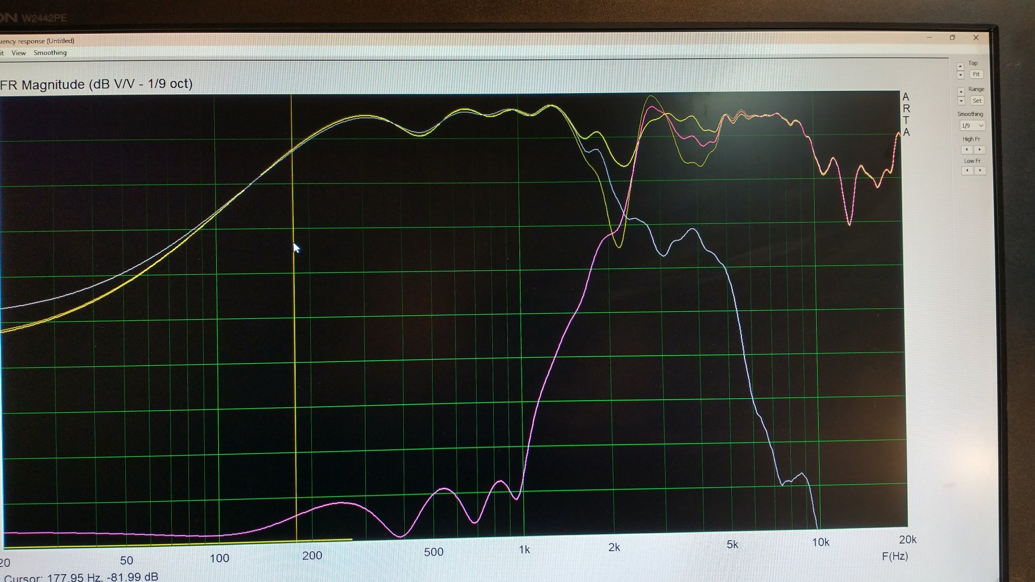

Wow. Some of that is beyond my understanding, but thanks anyway. I've simulated and tried a few different options and I think the result looks ok. Measurements are indoors with plenty of reflections. Mic is placed at horn level. 12dB/18dB for bas/horn. Impedance correction on both (r-c).
4 graphs: overall, with horn reversed, bass alone and horn alone.
Ok for rock and roll?
( The highs drop a lot, but I can live with that og correct it with EQ)
Assuming your vertical axis is 5 dB/division, it looks like you're down around 5 or 6 dB at the cross point. If that's the case, it might be worth adjusting the crossover a bit. If the vertical scale is something else, let us know.

Summation is poor in the acoustical crossover region, without knowing the measurement distance (determining the baked-in hypotenuse length offset..) and the vertical scale, hard to tell how poor.Ok for rock and roll?
The 4kHz woofer peak flattens the horn dip, but the response would be better off without it.

Maybe my description was bad, but I have 2 woofers. One over the horn and one under. Therefore I placed mic between the woofers at horn level. I do see some rather large differences in response when I move the mic up and down. I assume it's better to measure at a larger distance (outdoors), to minimize the difference in distance to the individual drivers?

Correct. Yellow-ish is the target and green is reversed.There are four curves, one with normal polarity and one reversed.
