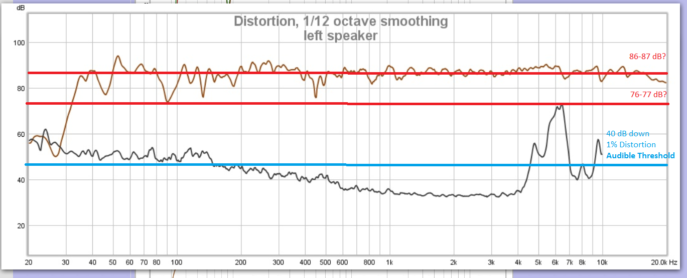

I took a few measurements, 0.5 meter tweeter axis.
Smoothed 1/12
While the frequency response does seem different like the dip around 5k, the distortion graphs for both the left and right is whats weird for me, any guesses?
Smoothed 1/12

Lastly, I just want to know, why is the distortion rising after about 5k in both my distortion graphs?
To elicit an answer to that question may require you to supply information about your tweeter, crossover, crossover frequency & measuring equipment.Lastly, I just want to know, why is the distortion rising after about 5k in both my distortion graphs?

The distortion peak and top end frequency response anomalies are from the dented tweeter. Those will need to be replaced. You can look up what the distortion on that tweeter should look like on Zaph's page. That high peak should not be there.
Even if true and not an artifact of something or other or the mic or the dent indirectly, I tend to be casual about 15kHz and supersonic distortion products around 1%, as the plot shows.The distortion peak and top end frequency response anomalies are from the dented tweeter. Those will need to be replaced....

That level is well above 1% and we don't even know if his plot is SPL accurate or what the measurement conditions were (unless I missed it). In the first of the two speakers distortion spikes to about 40% at 6 kHz.
If it doesn't bother you, then fine, but it is 99.99% unlikely since both don't show up at the same level and the profile and frequency anomalies look different. I would not personally be happy/comfortable with that and those tweeters aren't really that expensive so why not replace them.

Where did that "40%" figure come from?
C'mon now, in the zone that seems to have increased distortion, the results are mostly below 1% and are supersonic, eh. Except that if your piccolo player should have a harmonic sound falling in a tiny region around 7kHz, your dog might wonder who made that piccolo. But nobody else would notice or care.

The results aren't supersonic. First of all, supersonic is related to speed, not sound.Where did that "40%" figure come from?

Second, they aren't even ultrasonic. They have to be made up of of either second or third order distortion at that frequency otherwise you cannot capture them because distortion measuring programs don't measure distortion levels for products that would put the fundamental above 20 kHz. If it is second order (most likely) then it would be at 12 kHz for the biggest peak, which even for older people who have lost a lot of hearing, should still be audible.
Third, you do realize that 40 db down is 1% THD right? See attached picture. I was off slightly because I was eyeballing and guessing on what the total peak THD was there. It is actually 30%, not 40% at the peak.
Lastly, I don't see what ESL speakers have to do with anything here or what you are trying to infer. Why do you think they would have better "purity"? Have you ever actually seen a measurement of one?
Thankyou so much guys. I will be replacing my dented tweeters. It's now obvious to me they need to be replaced. I can even hear the difference abit now. Specially at higher volumes. And sadly, I was switching my tweeter from the center to my tower for audible difference, after being done when I was putting it back into the center, my screwdriver slipped and dented my center tweeter aswell LOL. So now I need 3 replacements.
