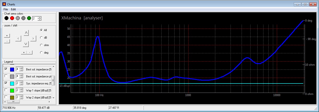

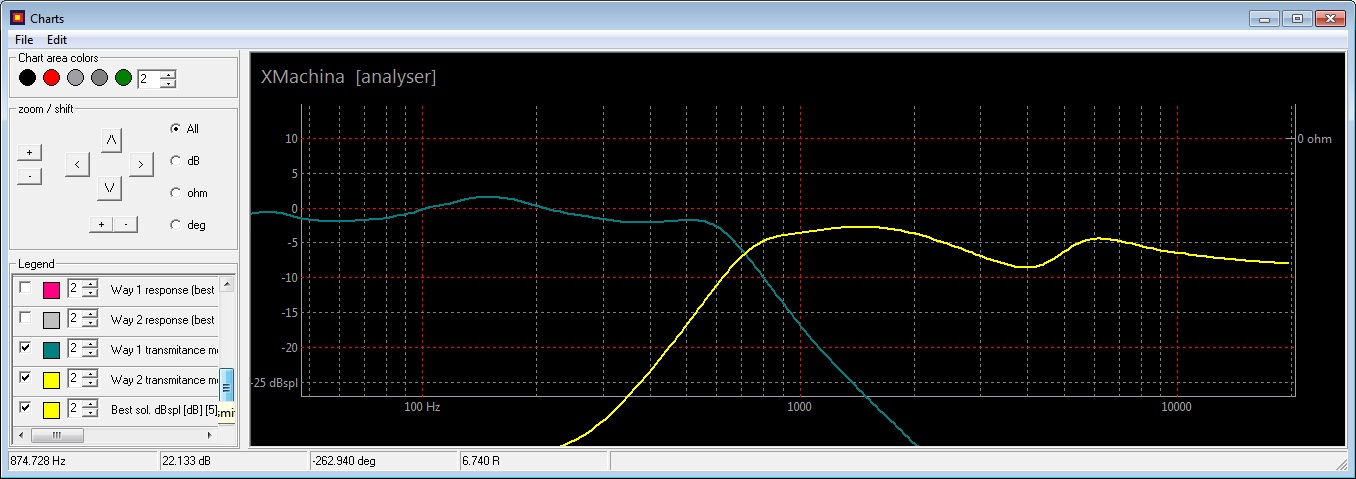

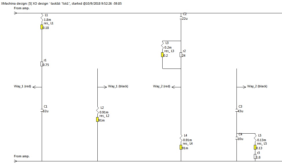

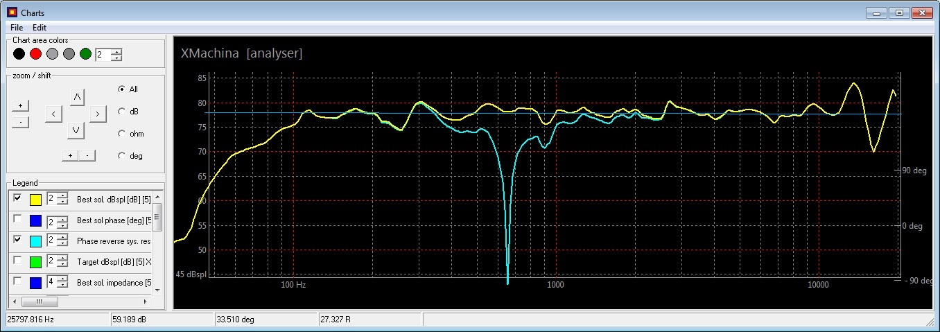

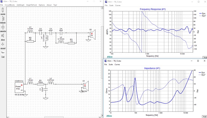

Interesting devices. Probably better for an active application but why not to try also a passive approach. No baffle correction nor box resonace calculations needed, everything is in the characteristics from datasheets. Just paste and design. fc=~650Hz, 12dB/oct. And the result: relatively flat response within 100Hz-13kHz band (+-2dB), f6: ~65Hz, sensitivity ~78dB. This doesn't seem to be attractive at first glance, but it has to be taken into account that this system is really microscopic (comparing to a typical 2 way).
FR:
attachment.php
Impedance:
attachment.php
Eletrical response:
attachment.php
Circiuts:
attachment.php
Circuits (transfered to XSim):
attachment.php
