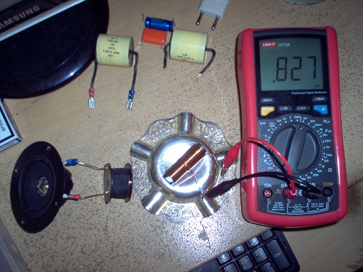

Take this or leave this, because I also use PCBs with substantial Earth planes, but thick earth planes produce measurable changes in inductance. This being a 1mH coil...
I would guess there might be crosstalk effects too. Only coils show changes. Capacitors and resistors seem immune. Thin foils like aluminium cooking foil produced little effect, it was the thick stuff that affected things. This is a silver ashtray for maximum conductivity.
Thus my preferred layout is point to point:
