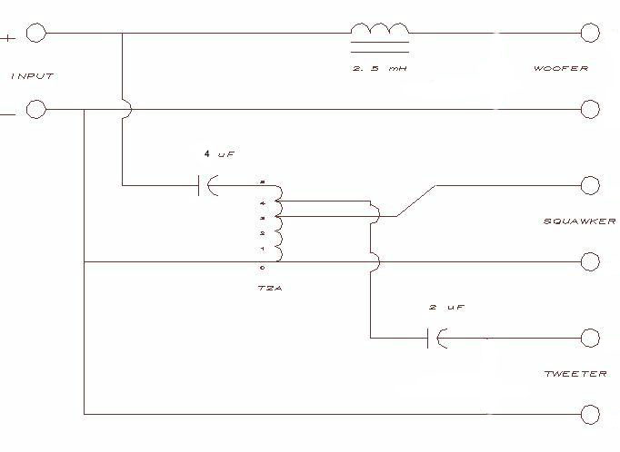

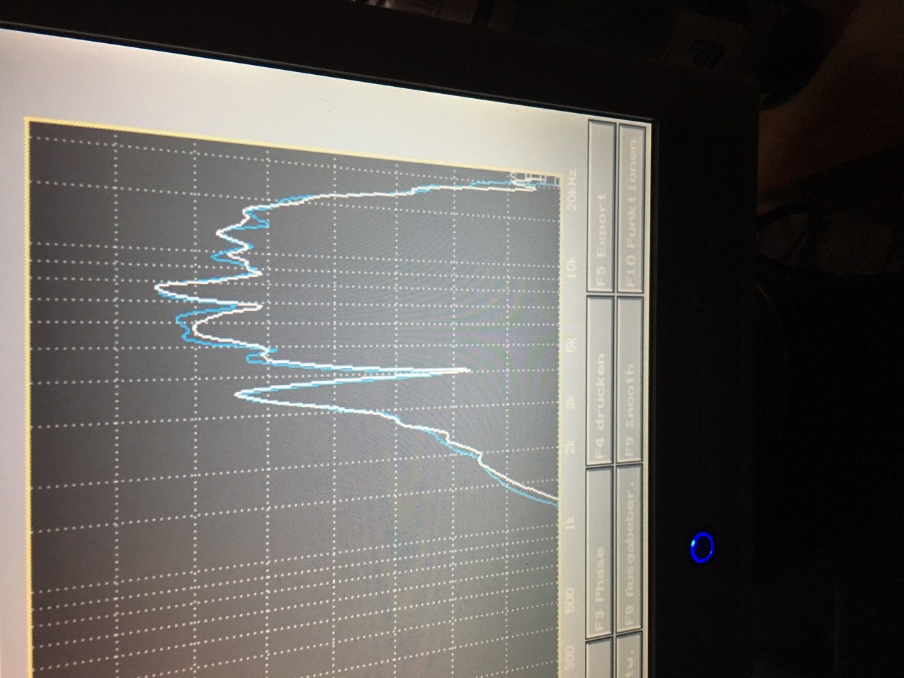

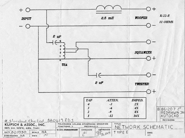

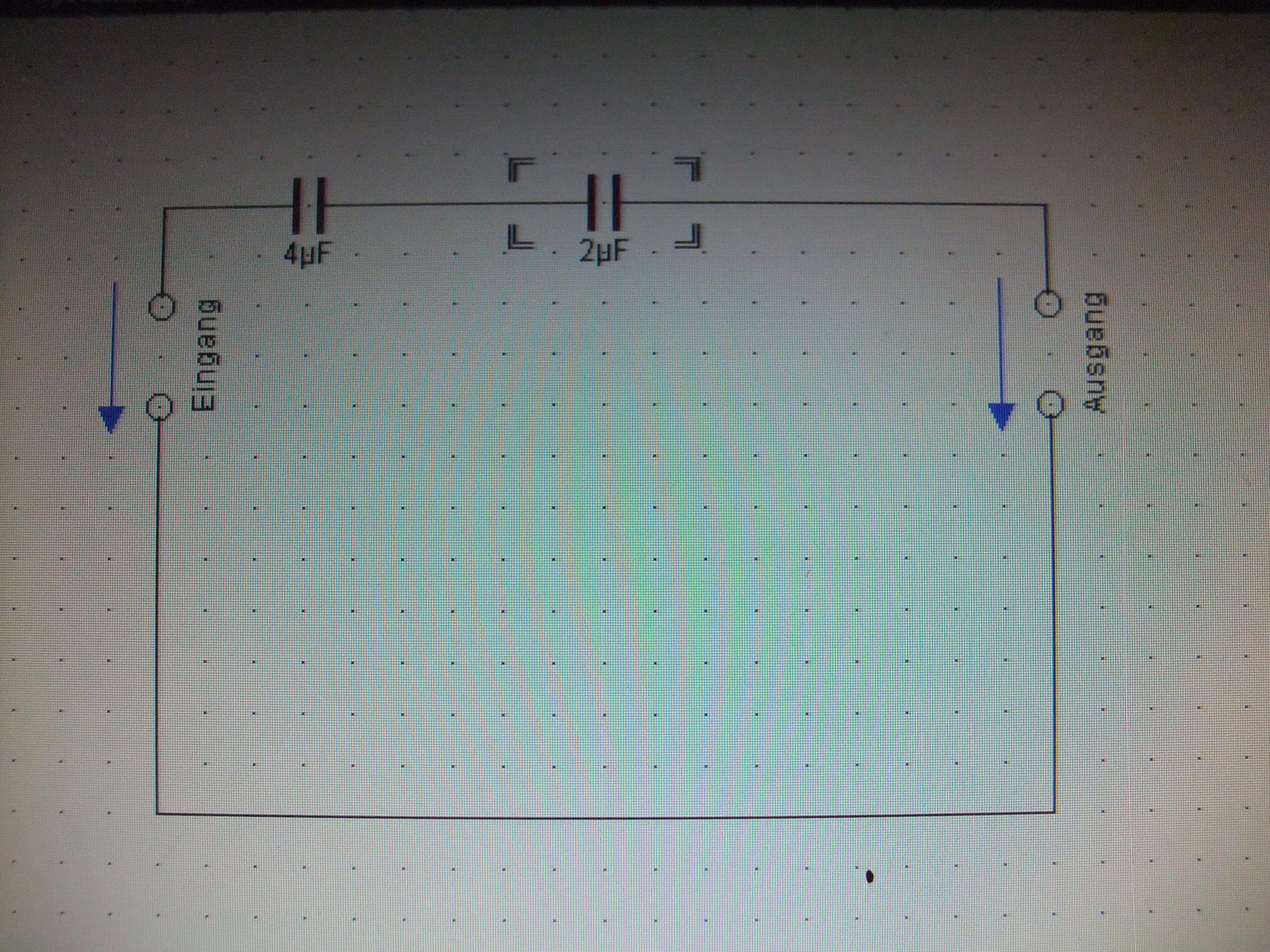

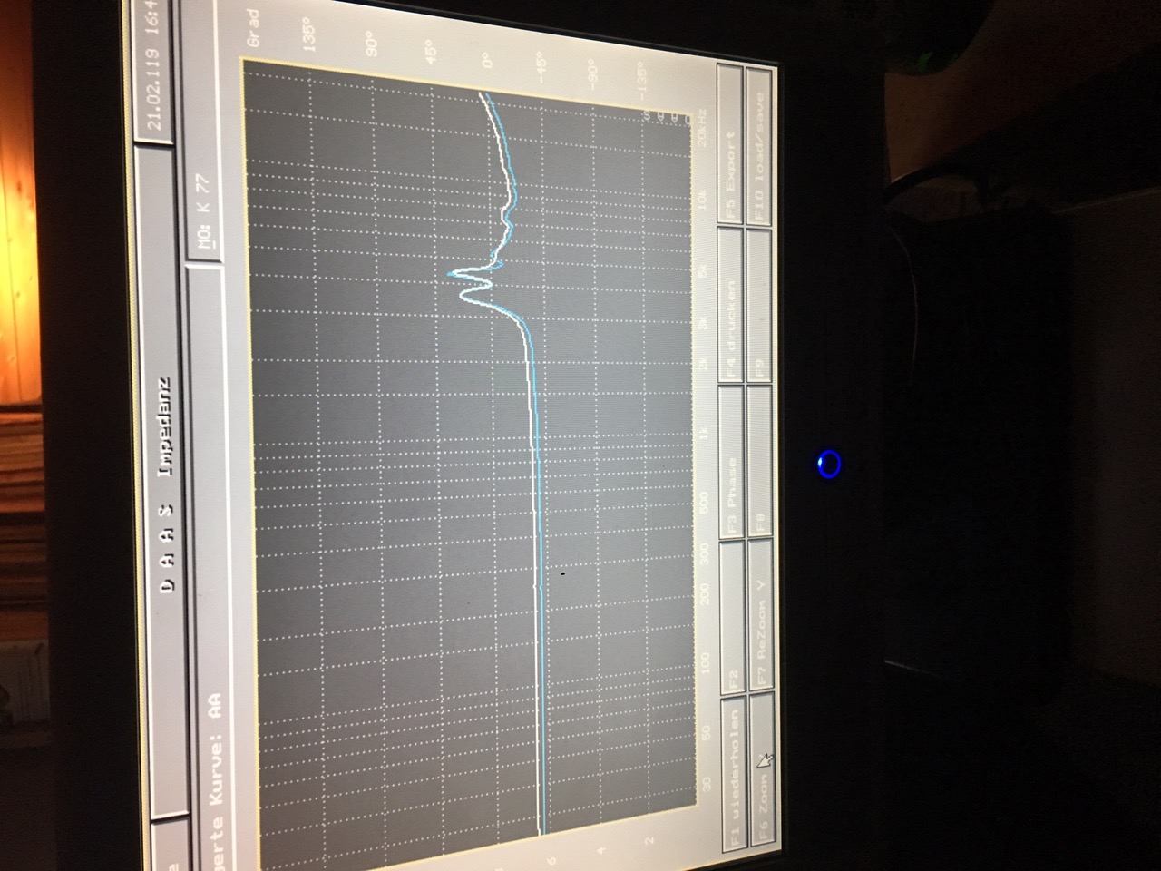

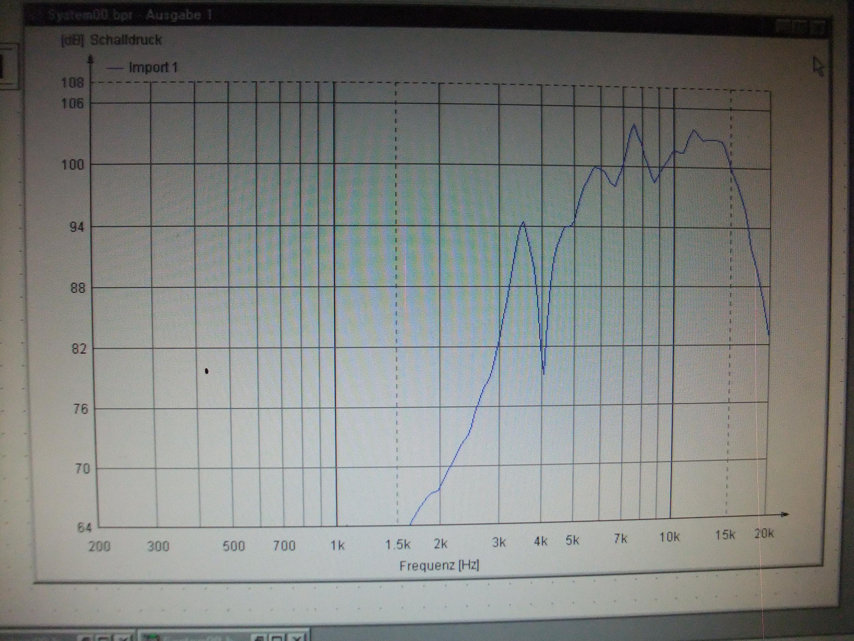

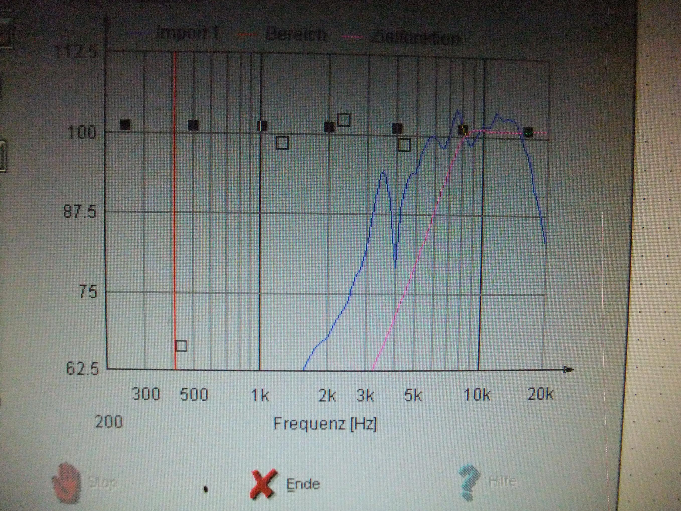

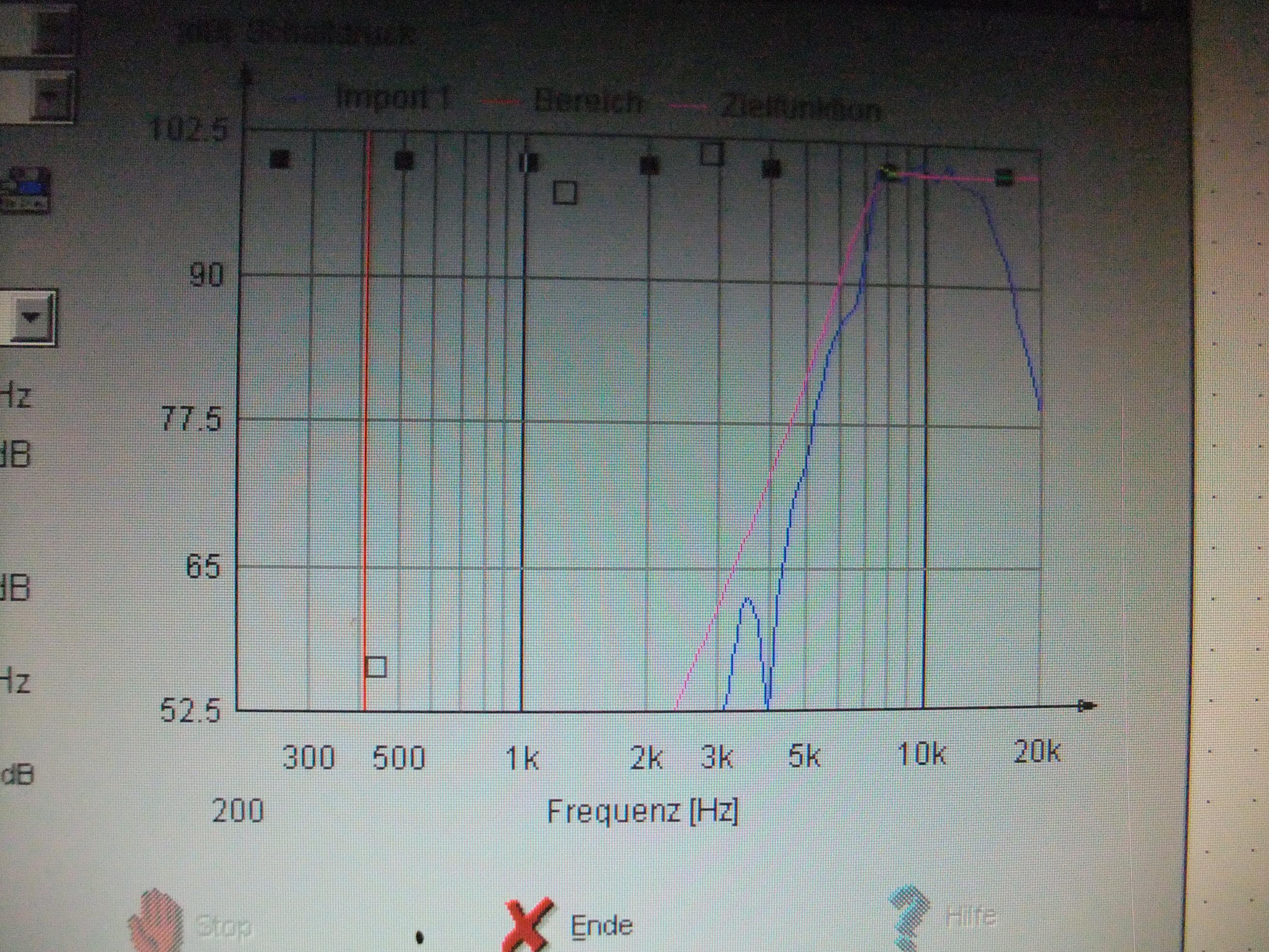

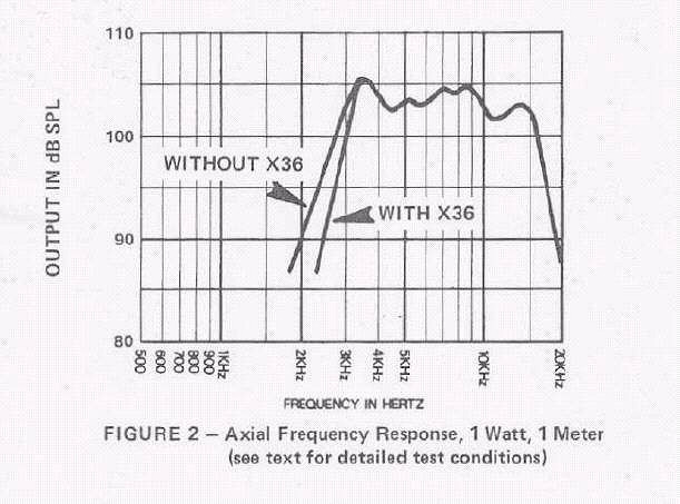

In the attached images you will find schematics of crossover networks and responses as follow:
1) Frequency response from T35 Datasheet without crossover network
2) Frequency response from T35 Datasheet without and with X36 module (12db/oct)
3) Frequency response from T35 in Klipsch Cornwall from 1979 without crossover network - own measurement (L+R-Ch)
4) Frequency response from T35 in Klipsch Cornwall from 1979 with and without crossover network - own measurement
5) Impedance from T35 in Klipsch Cornwall from 1979 without crossover network - own measurement (L+R-Ch)
6) Klipsch Cornwall crossover network, 6db-oct 4µF - Attenuation-Inductor - 2uF
7) Klipsch Heresy crossover network, 6db-oct 2µF - Attenuation-Inductor - 2uF
8) Electro Voice X36 crossover network module, second version, 12db-oct 6µF 0,37mH
9) Electro Voice X36 crossover network module, 12db-oct 2,84µF 0,727mH
None of the circuit topologies uses a correct design, because in all cases the voice coil must convert too high levels in the low-frequency range into heat. That is the main reason for the well above average failures, so I think.
Only one capacitor as a crossover network (electrical only 6db/oct) is known to be particularly unfavorable.
But even with the second order filter, the possible variations (especially those caused by voice coil temperature) can totally ruin the sound - regardless of the quality of the components or care in making the crossover.
In my opinion two capacitors and two inductors are necessary to reach an acoustical LR-IV high pass filter slope with 24db/oct with an overtaken frequency of approximately 5KHz (-6db).
Only this step ensures sufficient attenuation and lower temperature increases in the lower frequency areas and better sound at the same time.
The question is, who know such a circuit for a pasive high pass filter.
Best thanks for advices.
P.S.: Another feature is noticeable:
Already without a passive high pass filter in front of the tweeter the frequency response looks like there is already a high pass filter with a 6db character present (slope at whole = 18dB/octave - usual are 12db/octave without additional electrical crossover network parts) What is therefore the reason ?

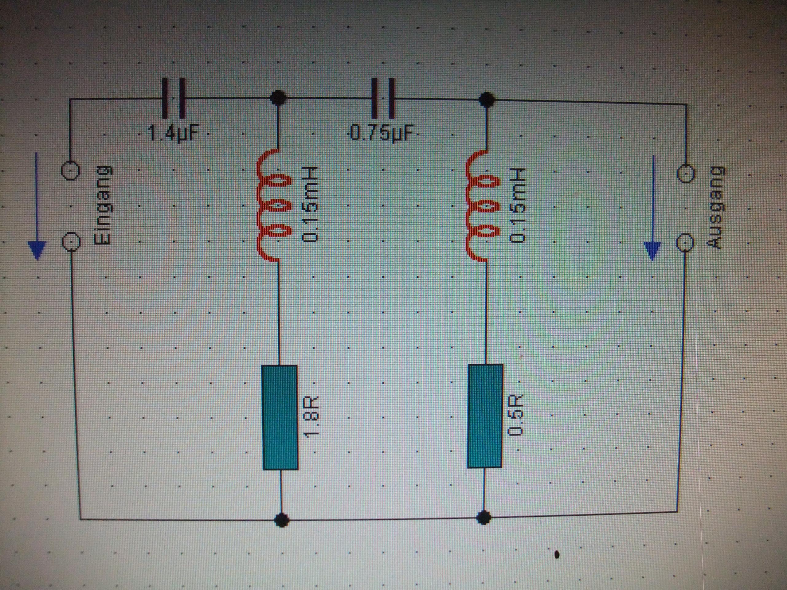

I use for such applications the CAD program "BASSYST" - go to
Beschreibung BASSYST
unfortunately the instructions for operating are only in German available.
Here my results (a listening test has not yet been performed):
EV T35 schematic genuine crossover Klipsch without Autotrafo.jpg1,021.3 KB · Views: 218
EV T35 simul frequency response + ideal CH-IV genuine crossover.jpg1 MB · Views: 198
EV T35 simul frequency response + ideal CH-IV new crossover.jpg1,021.2 KB · Views: 166
