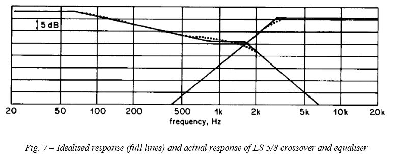

There is also a link to a document BBC RD 1979/22 containing detailed info.

The BBC PDF has the filter slopes at least.
You should be able to get close to that with a sim of electrical response using a passive network on a similar 12" bass, here polypropylene. 2kHz crossover?
Start with 2mH and 10uF shunt. Maybe 6.8uF and 0.2mH on the tweeter and resistor to attenuate.

Always a worry that the tweeter might not go loud enough on a passive equivalent. But I think that big Audax will be OK.
The BBC might have added a 7.5R and 10uF Zobel to the bass. A bass tank notch at around 2.5kHz might help too. Just can help with a cone resonance.

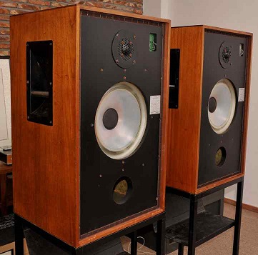

Hi everyone -
I have 6 months ago acquired (allegedlyà) the real BBC Rogers LS 5/8, ex BBC. How can I be abslutely sure that they er not the domestic version of the same speaker ( PM 510 ) ? . I have with them the Quads BBC modified with the filters inside.
Any help welcome

Could you post some pictures of them?
