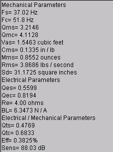

heres the woofer tiele-small params

Ilianh said:heres the woofer tiele-small params
Re= 4 ohms would imply a nominal impedance of 6-8 ohms.

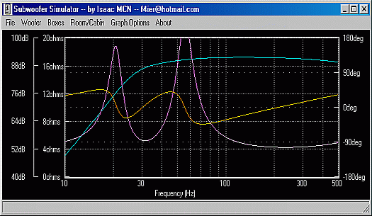

Simulation with an Re of about 4. The 3.8 Ohms reading will change this only marginally.
Forget about the low impedance near 200 Hz. Your crossover components will riaise that. Your inductor is probably about 4.7 mH or so.
The impedance vaalley at the tuning frequency is probably just a bit higher than shown. It is a rule of thumb that the impedance at the tuning frequency of a bass reflex is between 1 and 1.5 ohms higher than Re. However, most of the time it measures a bit higher.
I would say that you could probably hook these up as they are. To be safe, I would consider an 1 ohm resistor in series. It will cut your midpoint sensitivity by 2 dB, but will put you safely over the 6 ohm line. You could even consider parallelling two 1 ohm resistors to give a 1/2 Ohm value. That would cut midrange sensitivity by less than 1 dB.
Here is the chart.
The light blue line is your response on 2.83 Volts. I watt for an 8 ohm speaker, 2 watts for a 4 ohms speaker.
The purple line is the impedance.
The yellow line is the impedance phase angle.

Thanks for the help guys, i'll go get some mega 1 ohm resistor now.. i hope i can find one.... or i'll par some others...
