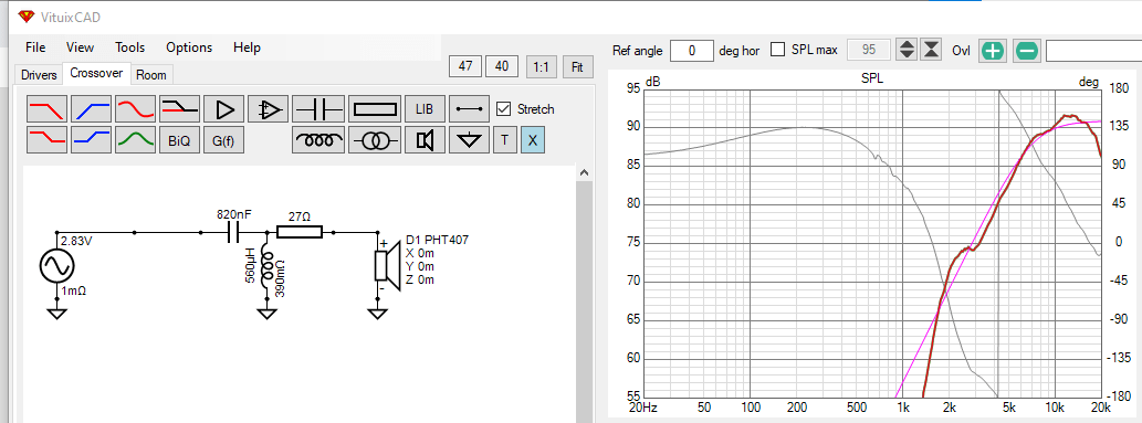

You're best to model in something like VituixCAD rather than just use generic calculators, as that way you can take account of all of the frequency response and impedance curve, not just a nominal value.
Unfortunately for this to work, we'd need a frequency response and impedance curve for the woofer as well, preferably in the enclosure. Are you able to measure those too?
For crossover purposes, you'd be able to get away with measuring from a couple of hundred Hz on up, which simplifies measuring indoors as you've less concern about reflections forcing you into too much gating.
Here's a quick attempt at getting the HF part to match a textbook 7kHz Butterworth 12dB HPF, which is what I'm assuming you used in your earlier digital tryout.
I've tried to match it to the nominal 91dB sensitivity you mentioned for the EV8L, but that doesn't account for bafflestep, so may need padded down further.

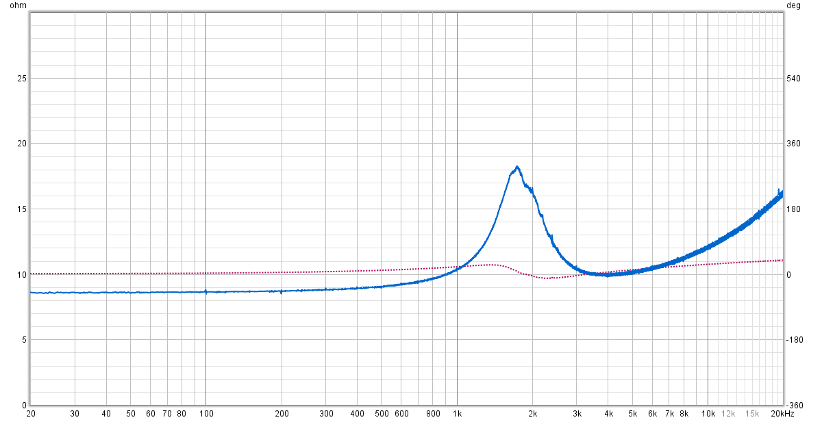

Sorry for my late reply. Work... However, I should be able to measure the impedance and frequency. Just got my hands on a used EMM6 measuring mic. First and foremost I will do some educating (e.g. watching YouTube) on how to measure with REW. When I'm confident I get somewhat decent results, I will get back and see how the measure need to be done.
I could in theory do the measure outside, but its -10 C here at the moment, and it will probably stay around that for a while. From what I believe most calculations and such are normally done around indoor temperature, 20 C, so it might be off...
Indoor measure it is then.
As said, I will get back, thank you so much for both your advice and the calculations so far!

No worries about the timing, take as long as you need.
Not sure how much you know about measuring, but one of the factors that complicates full range measurements indoors is that it's really hard to separate out room reflections as the wavelength is so long.
In your case though, we only need enough of the midrange included in the measurements to get a sensible idea of the average level there, so you can afford to gate your measurements which should help avoid that problem, so no need for sub zero expeditions 👍.
Hi!
Yeah, I know about all the problems reflections can cause, both dips and peaks. I do understand what your'e after. Measuring only a small part of the spectra should give the oportunity to exclude reflections both in time and frequency I guess.
At least I have calibrated my microphone and soundcard (using a Yamaha AG06, a small mixer), and will now attemt to do some measuring. Found som "articles" and yes, videos, on the subject so I will try to see if I can make it work.
I'll be back 😎
I'll be back 😎
