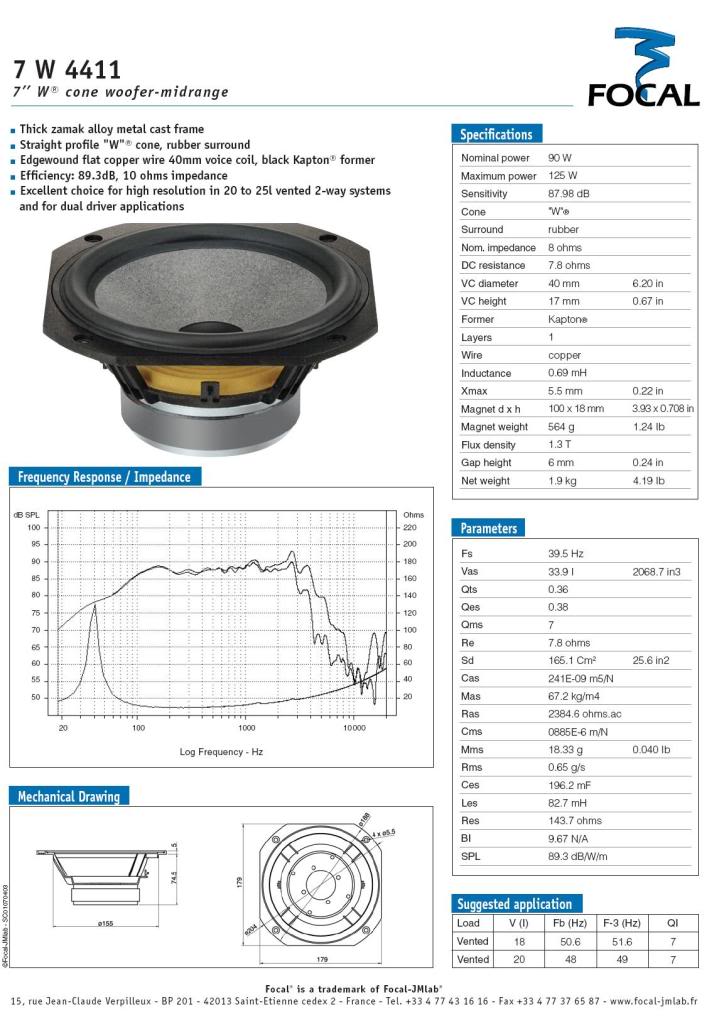

FOCAL 7W4411 (pic)

If you later want to use them, or DIY, probably new box needs to be simulated also for the right interior volume with new woofer FOCAL 7W4411.Ok, thanks guys
