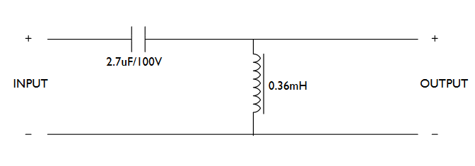

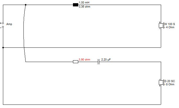

Here's a detailed answer. 🙂
Your HP crossover, below, is purely for the tweeter. You need to work on the bass too IMO.
These might do it:
Dayton Audio XO2W-3.5K 2-Way Speaker Crossover 3,500 Hz
HW 2/70 NG - 8 Ohm
All a bit rough and ready. The first order circuit sound rough IMO.
The second order is better. You will need to attenuate the 88dB tweeter too to match the 83dB Fullranger, with a resistor. Usually a 2-3 litres box for a 4" bass. Hard to say really, it's Qts around 0.9, like a car speaker, which hardly needs a box at all.

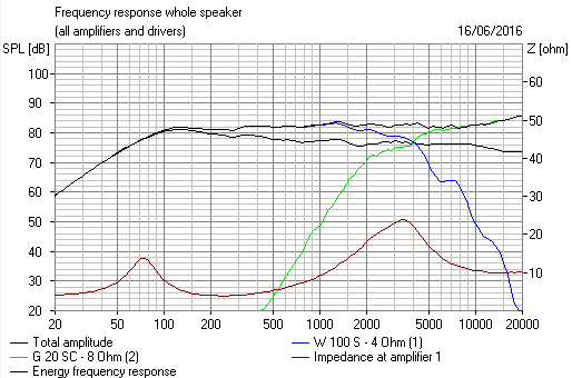

The second order is better. You will need to attenuate the 88dB tweeter too to match the 83dB Fullranger, with a resistor. Usually a 2-3 litres box for a 4" bass. Hard to say really, it's Qts around 0.9.
Awesome!! Thank you so much my friend. That seems easy enough to build, I may just have all the parts minus the resistor (hopefully radio shack has it) and I should be able to pull it off this weekend.

I think the concern about the impedance difference is no worse than the guessing you are doing to begin with. I mean that constructively. The woofer response might be a little recessed up at the crossover but it can be worked around and it might even be beneficial.
Say for example you bring down your tweeter level until you have balance at the crossover. This leaves you to work on the bass. Unless you can measure, this is your lot. Just remember that many designs bring the woofer upper response down a little anyway so you might get lucky.
