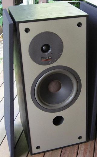

I need a crossover design for a two way design with a vifa D25 tweeter and dayton DC200 8" woofers. I got a pair of Energy ESM 2 with no crossovers and the woofers were changed to the dayton. Can anyone recommend a design?

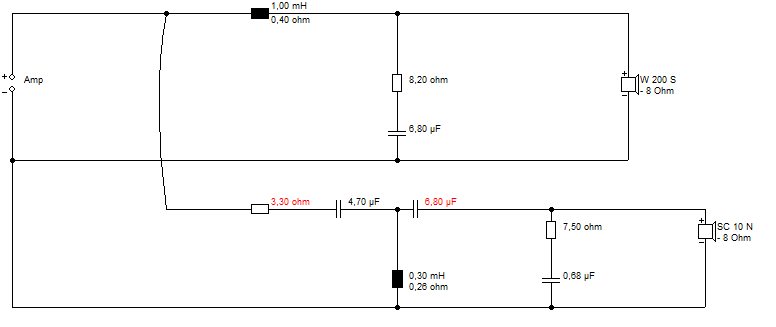

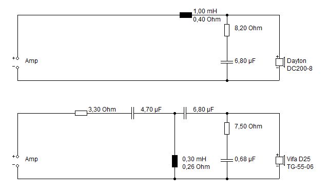

I'd try the near 2.5kHz circuit below, with or without the second 6.8uF capacitor on the tweeter. The 3.3R gives you some level adjustment. Every ohm changes level by a dB. But it must be near right anyway. Good project. Sort of thing I like doing myself.

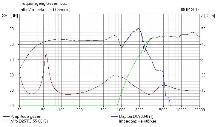

This puts me at about $50 total for the crossovers, this is doable. Not going to blow $100+, these are what they are. Worth $200 in original condition.
I plan to use them for cottage speakers. The paradigm 7se were way too boomy on the wood floor with the dual 8".

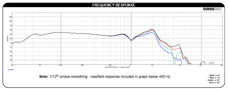

  • It's just a crossover proposal based on a simulation
  • Your tweeter may be different from the D25TG-55-06
  • The Dayton DC200-8 is not really suited for a 2-way speaker

I'm not convinced that Dissi is on the right track here at all. Sorry.
That's just a 2kHz notch around 6dB deep. It does nothing else. Everything I know about 8" bass tells me you need some rolloff to reduce cone breakup around 5kHz. Otherwise it sounds harsh.
I build this stuff with any woofer and tweeter I have lying around.
599660d1487267698-restoring-monitor-audio-r300-bookshelf-speakers-monitor-audio-r300-md-resurrected-cabinet.jpg
This is a sort of second order bass (well, just some impedance correction on a bass coil filter) and third order tweeter.
599663d1487267698-restoring-monitor-audio-r300-bookshelf-speakers-monitor-audio-r300-md-bw3-filter.png
Your Dayton DC200-8 is not suitable for this one. It needs 2.5kHz XO and it's high inductance. But I see nothing in the Dayton that will sound terrible. Especially off-axis, where dispersion falls off around 2.5kHz. Sure it will rolloff rather sharply, and you might hear that on some female vocals, but I really think my circuit will work better.

I'm not fond of notches. When they break up, they break up very horribly. The thing in audio, is we all like simple circuits, but really the drivers dictate what works well. Without some substantial impedance correction, at the price of complexity, as in the Rogers LS5/9, Rogers Loudspeakers › LS5/9, I think you won't do better.
If I really want to expend some effort, I think 4th order tweeter and impedance corrected second order bass is the best you can do with 8". But it's a monster to build. 😀

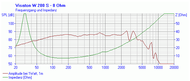

For comparison is a remarkably similar Visaton W200S which has given me a good time. And don't fret about exact crossover values at all. 10% is good enough.

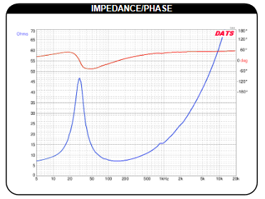

Oh, I forgot to show you the crossover. Whatever I have lying around really... 😱
It really doesn't matter much if you use a 1mH or a 1.2mH bass coil, for instance. Tiny differences.
I think I'd try your circuit then...
Are the DCR inductor values particularly critical? Will half an ohm make a difference for the 1mH inductor?
What difference does that second 6.8uf capacitor you said was optional make?

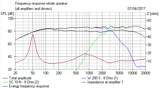

What software are you using? I should buy a program, if not for this project for my next one (Tannoy 3828 crossover build). Then I won't have to ask how much difference something makes.

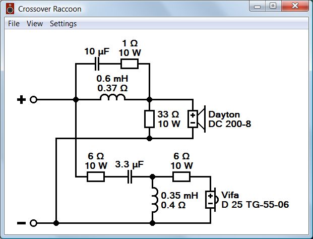

Steve is using Boxsim, a free speaker simulation program from Visaton: Downloads
And if he would use the software correctly, he would see how bad his crossover proposal actually is. But he prefers to do fictional simulations using wrong drivers. I have given up all hope.

Attached is a zip file that contains all driver data files and two Boxsim projects (crossover System7 and Dissi).
