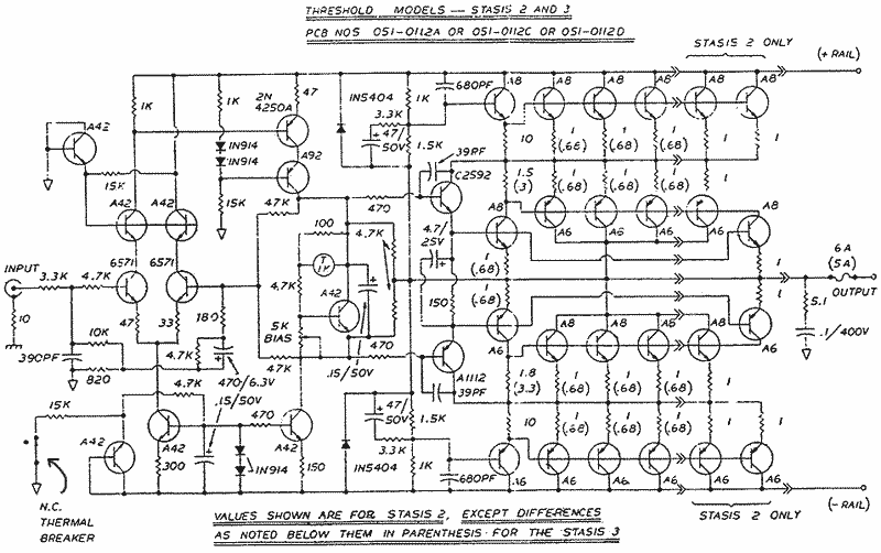

But I don't understand this Statis2-3 schematic. There are 2pcs of 4K7 R attached to the output at VBE multiplier.
I try to route it with many ways, but I still cannot relate this 2 R's for "non switchoff" function.
1. What is this 4k7R for?
2. In Statis2-3, the output stage still turn off, not like threshold 400A-4000?
