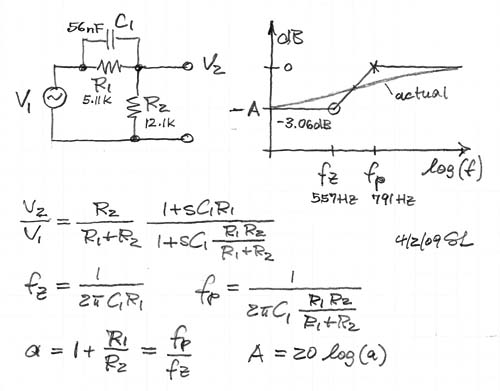

Here is a tweeter I like the look of but it starts dropping off at 15k: https://www.morelhifi.com/wp-content/uploads/2019/12/ST1048.pdf
At 18k its about 88db which is what I'm aiming for
Is it possible to design a passive high-pass filter that leaves 15k onwards alone and just attenuate everything below 15k? I want to cross it over at 2k.

Use an L pad on the tweeter, and bypass the series resistor with an appropriate value capacitor
(with a resistor in series with the capacitor if needed).
I believe the term for the circuit described by Rayma is a 'passive low shelf filter'.Is it possible to design a passive high-pass filter that leaves 15k onwards alone and just attenuate everything below 15k?
It is placed between the crossover components and the tweeter.
Yes, and if the tweeter's top end is too much, add a resistor directly in series with the capacitor.
