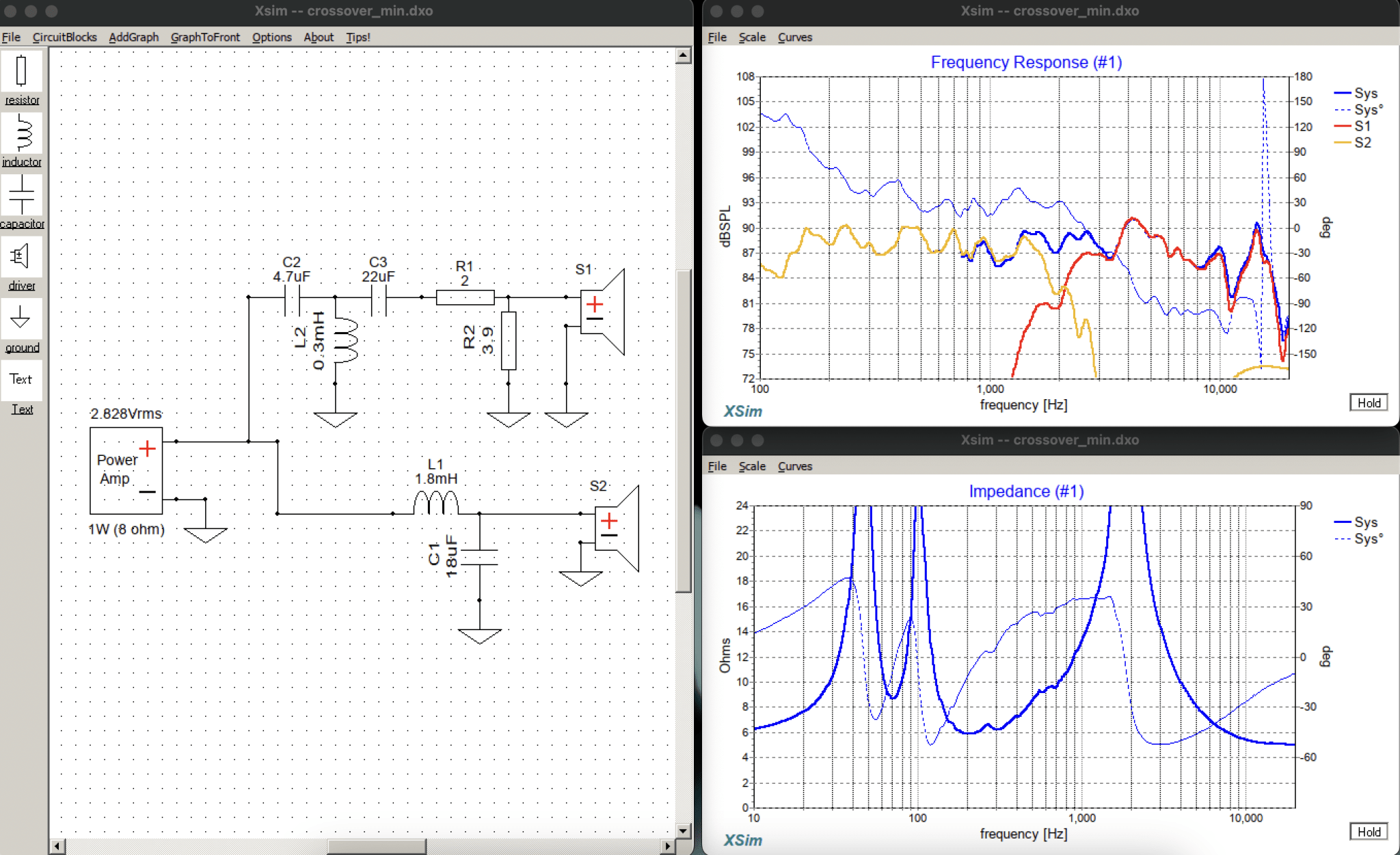

Hello,
I'm trying to make a budget crossover for my PA tops.
I am including the speaker measurements (REW, frd, zma) and the crossover design.
Does what I designed look correct? Have I made some serious mistakes? Or maybe I made the measurements incorrectly?
Thank you 🙂
