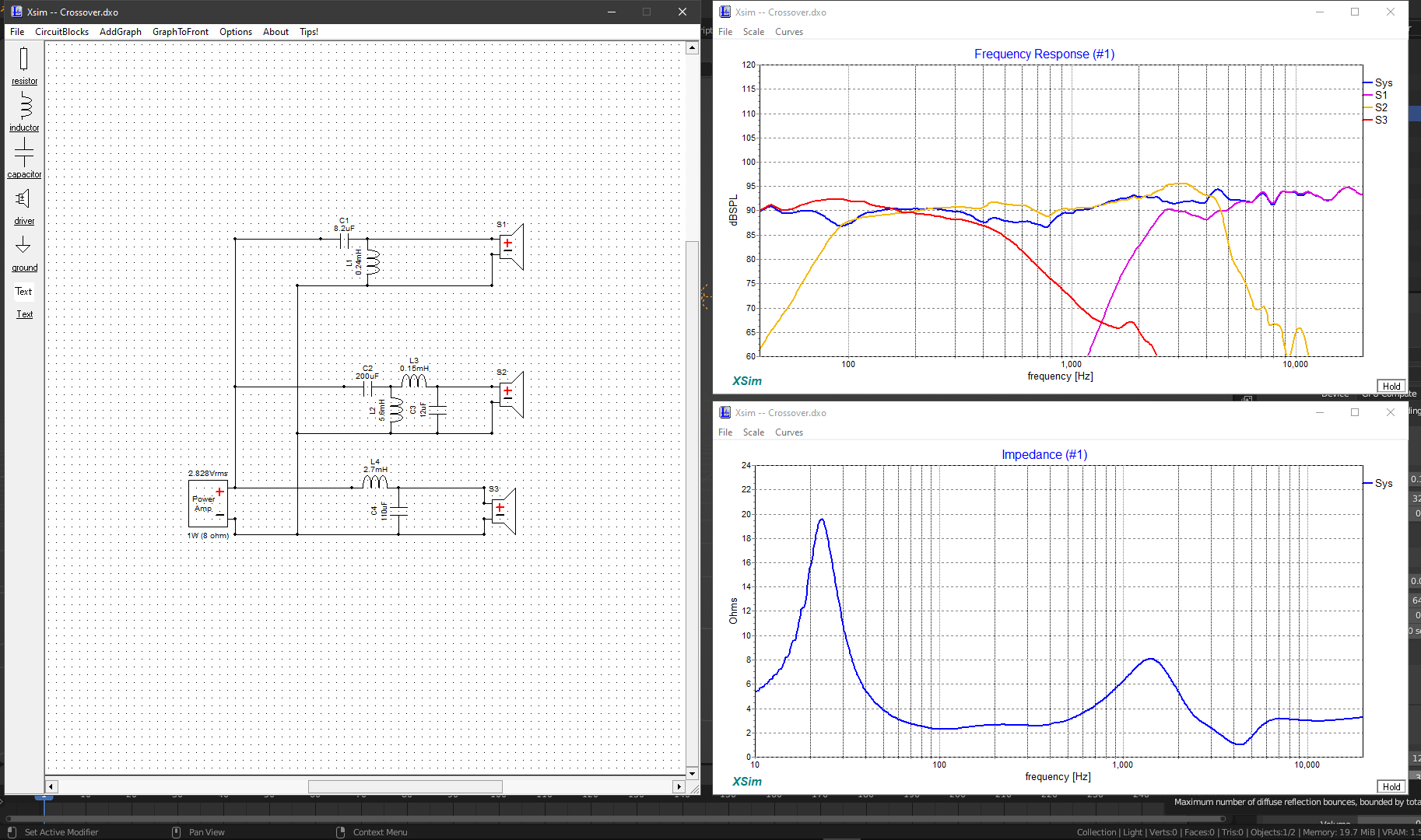

Hello, Not sure if this is the right place to post this but I am designing a 3 way crossover for my first diy audio project.
I am completely new to this so I don't really know what I'm doing.
The drivers I'm planning on using are:
Sub: Dayton Audio SD270A-88
Mid: Dayton Audio SIG180-4
Tweeter: Dayton Audio ND16FA-4
I have come up with this design and the system curve looks reasonable to me but again I have no Idea what I'm doing so I would love some feedback!
Btw the way I came up with this is by using a crossover calculator online and then tweaking the values to get a better response curve

A few initial thoughts:
crossover design is hard, I don't pretend to understand it, but three way crossovers are much harder to design than two ways, and either type of crossover needs experience, measuring equipment and expertise in how to do it all. Ideally, the drivers should be measured in the cabinet you intend to use.
your design looks like it doesn't have "Baffle Step Compensation" so would sound bright with less bass than you would like
the ND16 tweeter has a stated 'resonant frequency' of 2125Khz, so you don't really want to cross it below twice that, i.e. about 4200. The SIG180 - which looks like a nice driver - starts to 'roll off after 3kHz, so it might be hard to get the woofer and tweeter to work together. A 1'' tweeter might be preferable, it can cross lower.
as all your drivers are 4 ohms nominal, your impedance plot looks like it would be a '2 ohm' nominal speaker, which will kill your amplifier; and
lastly: you're much, much better off using a proved project by a noted designer which you know will work well.
I know this sounds negative, but you'll be spending a lot of Euros and a lot of your time and you want to be happy with your project. If you let us know things like your budget, room size, music taste and sources and desired cabinet size etc people will be pleased to help you with some project options.

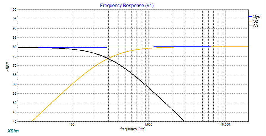

Part of what is driving impedance down is the excessive overlap between drivers. For a 300 Hz crossover at 12 dB/octave, target curves like this are more typical:
I agree with several of the points above. But if you really want to learn, it's not an insurmountable problem. As long as you expect a lot of intricacies and want to put in the effort, it's doable. It often comes down to whether you enjoy the hobby or are just looking to build one nice pair of speakers. Your performance expectations are also important. Some people enjoy the building process and aren't looking for perfection in their projects.

We can make your 3 way work in your first post, but it requires knowing the baffle design and driver placement on the baffle. The reason for this is we can apply the baffle step and diffraction response to the manufacturer curves which gives a closer approximation to what the drivers will actually do in your enclosure.
We'll want to aim for a crossover that presents no less than 3 ohm load at any point to the drivers, this is especially important in the bass frequencies (greatest current demands) and very high frequencies (no "shorts" leading to ultrasonic oscillation).

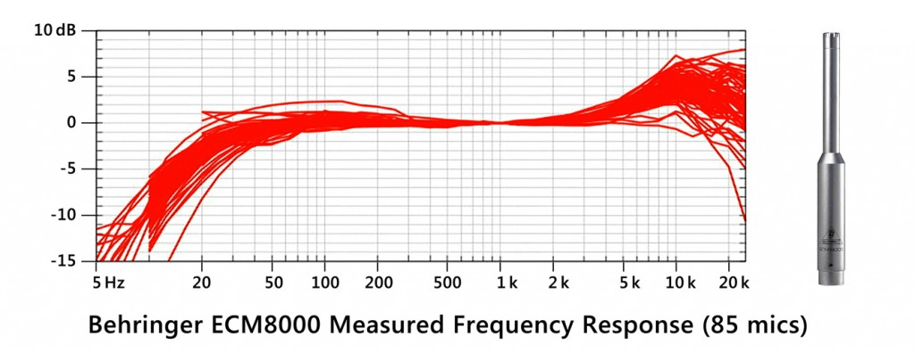

Yes the mini DSP umik-1 is fine. I personally have one. I'm not sure how much better the umik-2 is. My mic was usd$100 incl. Shipping to NZ from memory. Use with Room EQ wizard (REW) which is free, but donation recommended
GeoffMillar, the Behringer ECM8000 non-USB mic seems to be widely available in Australia for $72.
It requires phantom power, which can be DIY into a cable for the cost of a few 9V batteries and a few simple components. Otherwise it needs no special interface, just the regular line in on a computer. There are those who buy an additional interface just for the simplicity of it.
The only problem with the ECM8000 is no calibration file. You'll need to perform a version of self calibration. That along with buying / making an XLR -> single ended cable plus phantom power supply (+48V), I'd recommend the UMIK-1 as something that would possibly be cheaper overall.
Calibration has long been talked up by proponents of USB mics (present company excluded). Crossover work is relative, so you go ahead and use the same mic for all measurements.
I've said this before. Image stolen from the net. My own personal ECM800 follows a similar pattern, but not the drastic +/- 5dB of some of these mics:
Whilst agree the ECM8000 is likely accurate around your typical crossover points for a 2 or 3 way, it could create mis-leading data when wanting to apply DSP / LT to adjust bass response or "false" attenuation of high frequencies / misunderstanding of tweeter or diffraction ripple.
Having a mic with some sort of linear +/- 1dB response is preferable (to me anyway) than one without any calibration at all.
