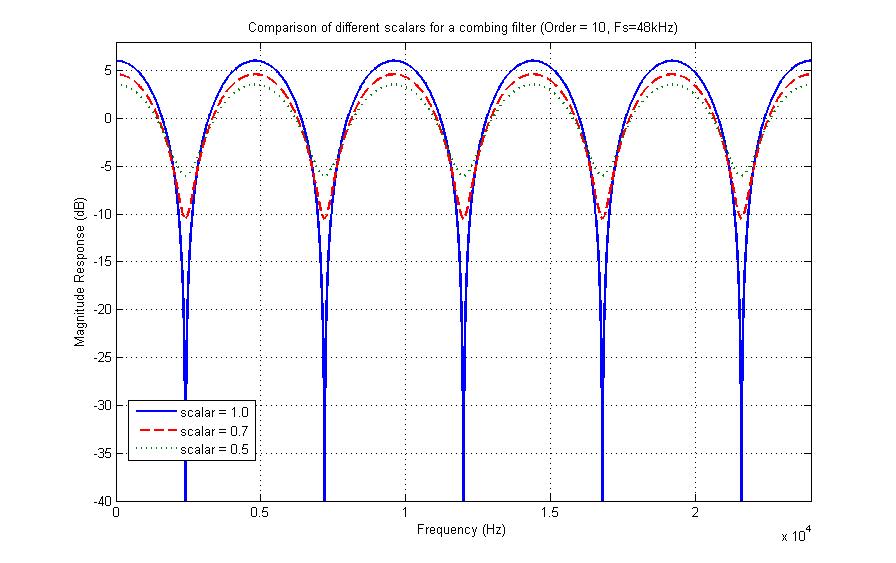

Matching phase to high precision is, in itself, fairly pointless.
Plot the response of two sources up to a cycle of separation. The broadest region with the least variation is centred around 0 degrees.
Allen, I don’t know enough about it to present an argument but if you were to explain why not it might help shed some light?
A comb filter will show this. Using the blue trace, +6dB with 0 degrees separation, -∞dB with 180 degree separation. When nulling, the slightest change causes the greatest variation in level but when summing, the variation is least.

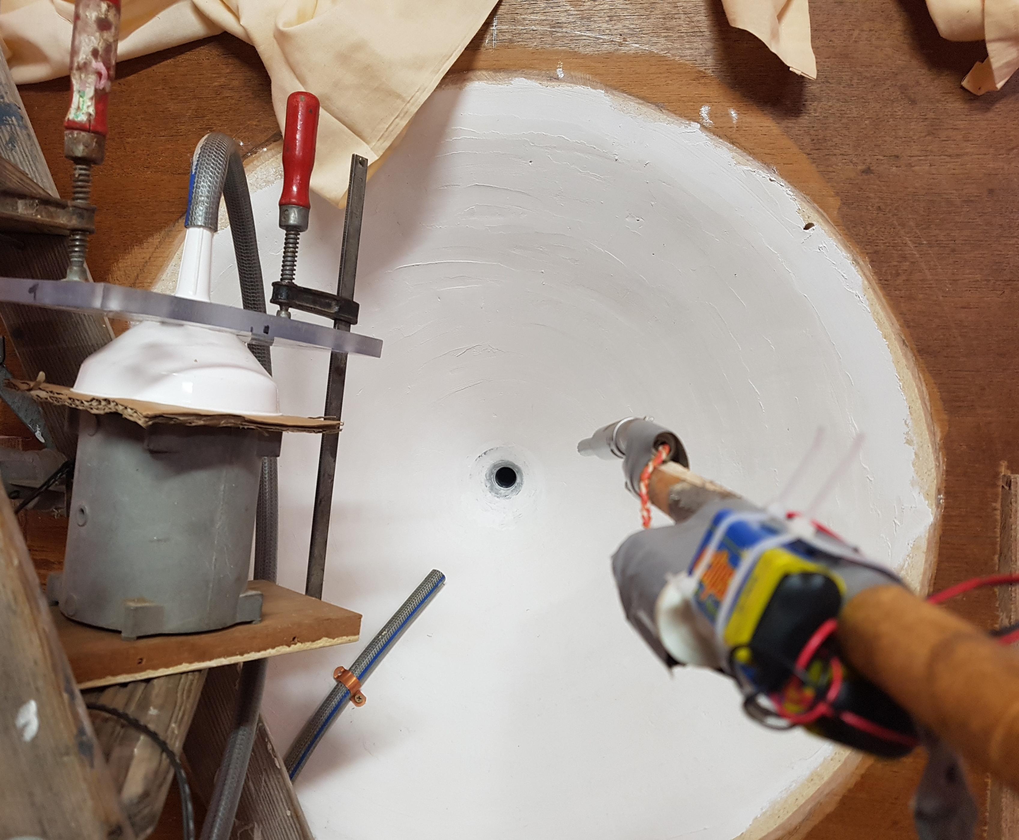

My bass waveguide prototype badly needs a revision that I can't settle on a solution to. So I'm sizing up my tweeter for a cross at 500Hz using multiple entry port/s.
Here, measuring the cancellation notch/location.
