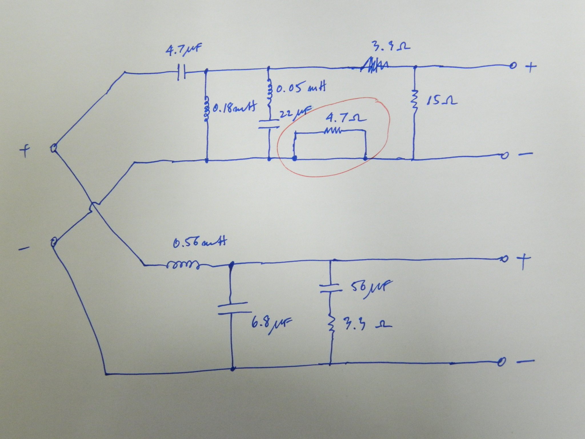

I'm in the process of building a small budget speaker using Dayton drivers, the TCP115-4 and ND25FA-4. I measured my drivers' raw responses and modelled my crossover using these measurements. I built the crossovers, but there seems so be something wrong.
The bass driver is almost completely silent. At first I thought it didn't do anything. The tweeter does make sound, but not very loud, and the TPA3116 amp switches of momentarily if I crank the volume up to about halfway (seems some built in protection).
Things I already checked:
I don't understand what's going on here. In the simulation software everything seems fine (though the impedance is quite low). Could anyone review my crossover and check it for errors?

It's possible that 56uF cap is shunting off most of your midrange, but it looks like polarized electrolytic as well. This the wrong kind of cap if it is, and needs to be nonpolarized. A zobel as normally used is not bigger than 20uF on a smaller driver, so this also seems really big.

Hmm, just looked at the dxo in Xsim and it does seem as though it should work. Maybe a short somewhere.
A variable frequency impedance meter would be useful as you wondered yourself, if the impedance is too low for the amp.

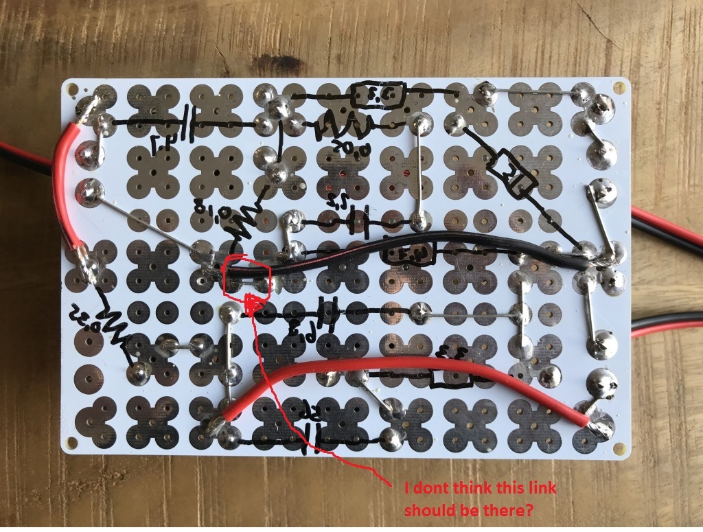

From you description of symptoms and the amp shutting down as you increase the volume it sounds to me like an almost complete short circuit on the input side of the crossover, like a single loose strand of copper in the input cable. I can't see one in the picture, but what about the other end not photographed - how is that terminated?
I don't think its the 4.7Ohm resistor (nice one for spotting the issue in that area though Tauntran) but the link back to the 2nd order inductor shouldn't be there? ...see attached file
Couldn't see why that would cause your issue but then added that link into xsim and noticed it drops the impedance above 15kHz down below 2 Ohms which the amps could be unhappy about?
If the crossover is actually built as the schematic shows the 4.7R isn't an issue, it's shorted out.Please check the 4.7 Ohm resistor.

The 4.7Ω resistor isn't shorted out, even though it seems it is on the photo. The bottom wire of the parallel coil in the highpass section connects to ground. This coil is drawn somewhat diagonal, but in reality it's placed vertically and the bottom wire connects to the same pad as the left wire of the 4.7Ω resistor. This pad had been dremel'd (hard to see), so that this wire of the resistor is disconnected from the ground.
Also, the 56uF cap in the zobel network is a Mundorf ECap RAW capacitor, which should be bipolar. The values for the zobel network ware calculated using the information provided in this article (Re=3.2Ω and Le=0.97mH).

Maybe the pad is dremel'd, but the black wire seems to connect (unintentionally) both part of the pad, causing the issue (impedance under 1 Ohm just before 20 KHz). To check if this is the problem, unsold one leg of your choice of the coil or cap of the notch (0.05 mH, 2.2 uF).

Will do.Maybe the pad is dremel'd, but the black wire seems to connect (unintentionally) both part of the pad, causing the issue (impedance under 1 Ohm just before 20 KHz). To check if this is the problem, unsold one leg of your choice of the coil or cap of the notch (0.05 mH, 2.2 uF).
You're absolutely right. This comes as somewhat of a surprise to me, I thought the XO point was around 3k. At 2k the tweeter will probably have considerably higher distortion and limited power handling. Knowing this, I might end up redesigning them altogether.The crossover has space for improvement, a 2KHz crossover is not really suitable to the tweeter
I think I'll disassemble one of the crossovers and rebuild them on a bench step by step to identify the issue. Even if I end up not using them, I still do to know what caused the issues.

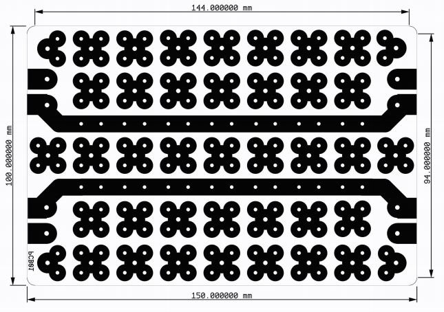

I think you are using the PCB wrong the single solder pads are actually connected together and covered by the white stuff. Therefore you are shorting some of your components, the two inner caps I think. See the Sound Imports picture.
Is the woofer itself working properly at all ? And is it properly connected ? Keep in mind that crossovers without drivers connected present a nasty load to a driving amplifier.
The woofer works fine when connected directly to the amp.
My goodness! I wasn't aware of that! That most likely explains all my issues.
