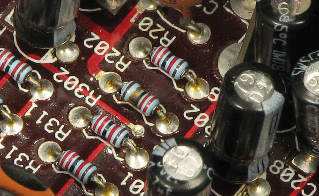

In the power supply, is that resistor between the primary and secondary grounds?
In the audio circuit, the photos I have, have the same resistor burned, but not as badly. I don't know if the multiplier band is reliable. Does it connect between the shield ground and the secondary ground?
The resistor in the power supply connects between primary and secondary ground
The resistor that is burned connects to the shield ground of the rca and the secondary ground
Back to this amp .
Replaced the resistors amp powers up and had audio but the left channel has very low output .
Any ideas on where to start looking ?
I cleaned all switches and it made no difference
Which terminal goes to ground? 1 or 2?
For the one that is NOT grounded, are the audio signals equal?
What's between the header where the signals are equal and that (muting) transistor, pin 1?
Is there a bad cap, an out of tolerance resistor or maybe a bad connection?
