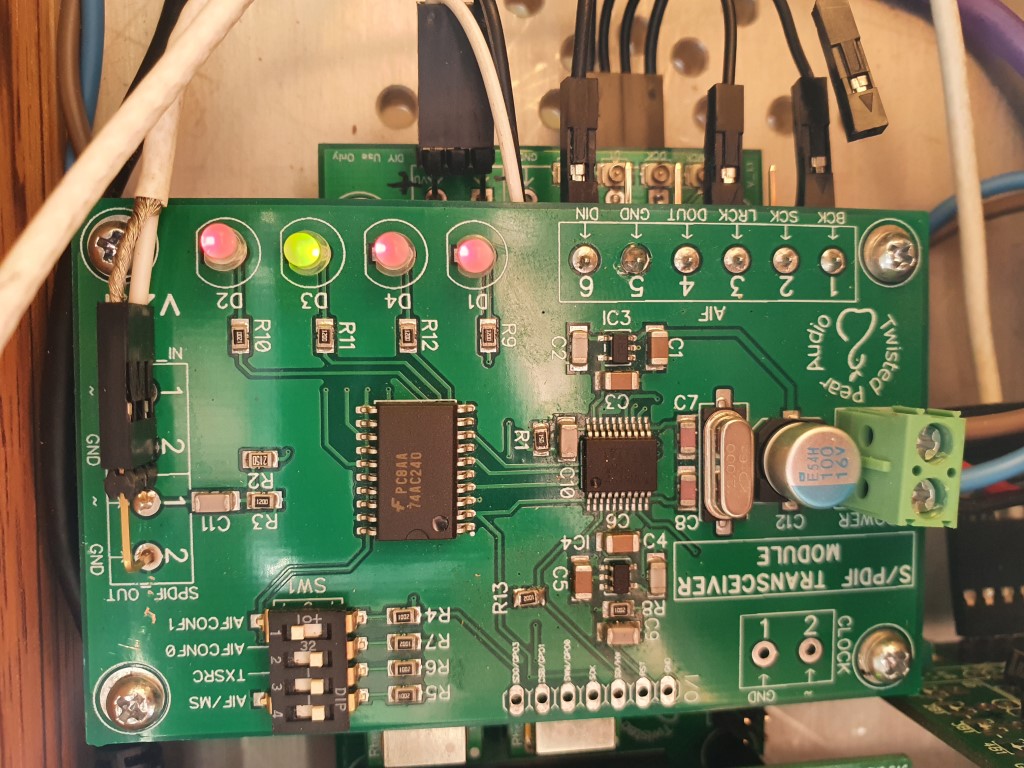

Hi, Can anyone help please I need to convert to SPDIF so I can insert a MiniDSP before my DAC
Old working setup:-
BBB Hermes Cronus i2s > Teleporter .......I2s.....Teleporter > Buffalo-IIIsePro28 (other S/PDIF sources working fine)
New Setup:-
BBB Hermes Cronus i2s > S/PDIF Transceiver......S/PDIF........ Buffalo-IIIsePro28 (no lock)

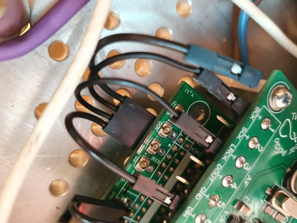

Cronus > Transceiver connections
DCL > BCL
D1 > LRCL
D2 > DIN
GND > GND (via p/s)
Switch settings see photo
The LED's on in the photo are the same with or without clock and data lines connected.
Can anyone confirm the connections and settings are correct please.
Cheers, Steve
