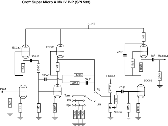

I’m planning to build a preamp according to the schematics of Croft super micro A. http://soundmovements.co.uk/diyaudio/Croft_preamps.html
Does the schematics look correct? It looks like some components are missing and I suspect the values of the capacitors in the riaa to be incorrect. What do you think? Can I build it with this schematics?
Also, I would like suggestions of a suitable PSU. Any comments on the project is appreciated. (The preamp will be used with Ortofon SPU#1E, Denon 103, Stanton EEE a pair of TD124, Denon AU-340, Quad II:s and stacked ESL57.)

I’m sure it sounds fine if it’s built from Croft’s schematics but I suspect the one I found is not accurate. How about the capacitors of the riaa? 330nF and 150pF looks odd if you compare with for example EAR834. But I have very little experience with electronics. I just want to make sure it’s correct before I start building.

I wish I knew how to calculate the riaa correction but hope to get a confirmation that it’s correct as shown in the schematics though I suspect it’s supposed to be 330pF instead of 330nF
Hi Alex. Thanks for your work with the schematics. I hope to get a confirmation from someone that it looks accurate. I can of course build it and listen but would appreciate if someone can see any obvious misreadings. Again, I wish I could calculate the riaa capacitors. They seem to have odd values.

You could enquire to @Tubekwk and others who modelled a phono preamp, not Croft though, in ltspice. It might also confirm if those values are off. For example: https://www.diyaudio.com/community/threads/rca-phono-preamp-and-reverse-riaa.393290/#post-7202634

If I still had the preamp I would be very happy to open it up and have a look to check the values. As I mentioned earlier, though, I sold it a few years ago. And unfortunately Glenn Croft isn't around any more to confirm one way or another
If you had access to a Spice simulator, it would be worth putting all the component values in and checking the frequency response.
Looking at my website, I see I included the HT regulator circuit in the schematic for the Super Micro 3, though I'm not sure whether the HT voltages are the same for the two preamps, and again I can't confirm the values are correct.
