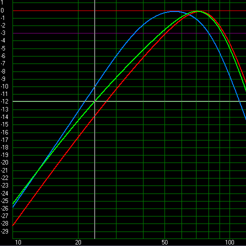

Out of curiosity I did a comparison of the XLS-car vs home audio version vs the DPL, all in a 28L sealed box.
The XLS drivers had a low Q in a box this size, 0.6 for the car version & 0.5 for the home version. The DPL wants a bigger box and has a Q of 1 in a box this size. The transient performance is likely to suffer.
Looking at the response, both the XLS car and home audio version are very similar. In fact, it seems the real advantage of the car version is that it has a lower impedance, hence it will make better use of the amps power. The DPL has a slightly sharper rolloff which occurs lower.
Consider that cabin gain will typically be 12db/octave below 60 - 80 Hz. Below 50 Hz the XLS subs rolloff at about 8 - 9 dB/octave. The DPL rolls off below 35 Hz @ about 12db/octave. As a result, the DPL will have a big boost around 40 - 60 Hz. The XLS looks likely to be a better match with cabin gain IMO.
The tiny difference in xmax between the XLS vs the DPL of 1.8mm is nothing to speak of. It amounts to less than 1db!
Of course, if you really did want the DPL, then you can use eq, which is probably a good idea no matter what driver you chose. You change the Q with a Linkwitz transform, but I doubt this would be as good as using a driver that has a lower Q in a small box in the first place.
If the XLS doesn't have enough output for you, then there is always the Brahma!
Here's the chart, with gain applied so that the F3 of each can more easily be seen.
Red - XLS car
Green - XLS
Blue - DPL
