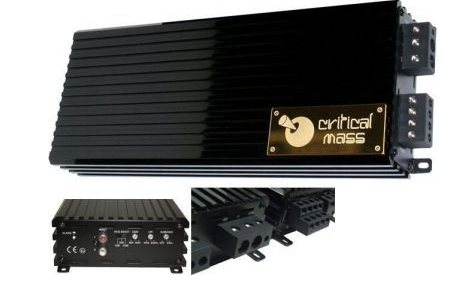

critical mass ul-a2500 v2 amps are crap
from the start with 4 gauge wire the cm amp would overheat and go into protection within 20-30 seconds. i was assured my setup would be fine by the sales associate i dealt with.
so, it is my impression that these critical mass ul-a2500 v2 amps are not truly 1ohm stable. i upgraded my alternator from a 150 to a 180amp. i upgraded the big 3 with 0 gauge and ran 0 gauge (replacing my 4 gauge) to the rear kinetik 2000 amp battery and to the amp per critical mass to fix the overheating issue. NO CHANGE. in one ohm with a steady 12.2 volt running to the amp it would over heat and go into protection within 20 seconds. the amp ran just as hot running at 2 ohm but never shut off. so you can buy them all day on ebay for around $600 but IMO they are worth maybe $200-250 for what you get out of them. the amp is poorly crafted. it looks like a $200.00 amp. this company is all hype, and their tech support is worthless. the box it ships in is a joke and the "manual" was literally 4 8x10 pages printed off on a black and white printer and stapled together. i also found that american bass makes an identical amp, the phantom ph4000md. google it... its the same chassis, the same side panels and connectors and very similar specs. this amp sells for $250-300. see the pics i uploaded.

from the link I posted, the Soundmagus' DK1800 is about the same size as your UL-A2500. Comparing the power rating, the DK1800 is 1800@1R and 1000@2R which is just about your estimate so I'm guessing they are the same amp. In other words, CM probably over inflated their published power ratings. :no:

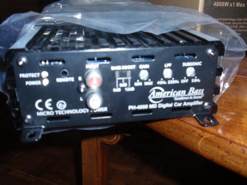

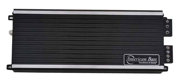

i dont know why u posted the american bass ph4000md is not anything like the cm amp i had the cm it was junk, i am now running the 4000md at 1ohm with 4 gauge power wire to 2 12 inch american bass xfl subs and the amp has been tested pushing 2,100wrms @1ohm.amp does not even get warm i have played it on a 3 hour trip last week not a issue.i would tell any one to get the american bass audio stuff is sweet and not high in price. i have had every kind of amp u can think of from sundown to ppi.hands down the best for the money
