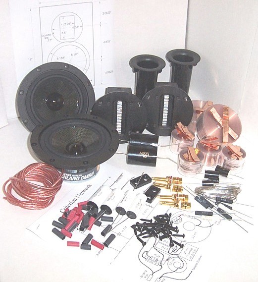

Well I finally Picked my project for my aleph 2’s now I have a question for these. Here is the link to what I’m building.
http://www.creativesound.ca/details.php?model=CRITERION
My question is should I put them in a tower configuration. Using the same volume to spec. I like the tower idea because then I don’t have to build stands and worry about speakers height and ect ect. Anyone post there thoughts. ?

I dunno... If you want to, I guess...
The only thing I can think of is that they aren't very big speakers and you would lose some flexibility in you ability to place them.
You should email Bob (creative) at www.creativesound.ca or Al (RAW) at www.rawacoustics.ca
They will be able to tell you about any possible problems with turning those into floorstanders.
PS did you check out the Alpha LS at creativesound?

Well I can say that the Criterion is a smooth design done for CSS by GR.
Email Danny and he can asnwer any questions about the Tower idea.
I will not comment on it.
There is a MTM coming soon.Danny has it on his boards but not up on line yet.
http://www.audiocircle.com/circles/viewtopic.php?t=1628
This will fit a larger cabinet.
Bob and I are working on Flat packs for the Criterion.
I have switched to Lock miter cabinets for resale as it makes assembly a snap and a set can be assembled in minutes with only DUCT TAPE.Clamps would be better but this tape will work.
The Criterions is tricky as the cabinets are 1.25" thick and there is only one BIT in CANADA OR THE USA that will cut lock miter for the small shop .
And if you cut a large 3/4" radius on the corners it cuts deap into the lock miter and this means filling.
Not a lot but still enough.
So we are thinking out the assembly of the Criterion to do it once only.
Over all you will love them.I was stunned the first time I listened to them.I have built 2 designs of the Criterion.The first used the M130 driver from GR.But Danny seen the EATON as a 100% improvment over the M130 and I agree to a point.

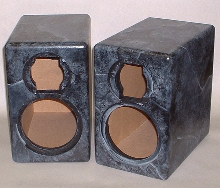

I'm going perchase pre maid Boxes. so that way i dont ahve to build them. i like the marble ones alot. im going to buy the speakers pritty quickly. What do you mean the flat pac.?? what is the. difrent x-over design.? Should i keep the x-overs in the boxes, or make them external.

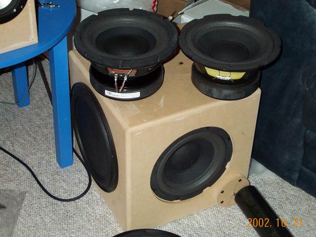

You have these drivers on your webpage. Do you reccon them for sub's. I would like to know where you get them and how much. i would like 4 of them. i need 4 for my subs that will be going with my Criterions. that or ill buy 2 x 10" subs. i like bass some times and i also want drivers that can pack a NICE punch and handle some beef.
http://quicksitebuilder.cnet.com/wrnch2/id11.html
Falt pack means that the cabinets come un assembled.
Bob at CSS is getting me to finish a few sets of the Criterion MTin the following weeks.
These will be in Maple veneer.
But yes the Marble look from Brian is neet lookin.
The drivers you see in the above photo you seen on my DIY site are the TB and MCM 8" drivers
TBW8-740C
MCM 2421
I have done a lot of testing with these and if you look in the older files you can find alot on these.
But I will make a few more newer comments.
I have used these 8" subs in a few ways.
All tests were done in a 12" cube
SEALED will only work with a small AMP with boost in around 35hz, out put well modest to say the least.Nothing special.
Ported 2" X14" still port noise that can be used as your girlfriends blow dryer!!
With a single PR that MCM sent to test with these.
Not recommended as the XMAX is only 6-8mm and that is it.
Twin MCM PR
MCM sent me 2 do test and the single just can not work and the output using the 2 is still very very limited.If you are going to use the MCM PRS get 4 of them.
Lastest tests
Using the RCM PR with 50MM of XMAX.Yes 50MM of XMAX
http://www.creativesound.ca/details.php?model=BXP10
These are unreal PRs.
a single PR weighted starting around 250g is were I am now and these 8" drivers are a sub.Albe darned😱
The drivers need a high excursion PR with a stiff compliance.Well the RCM is just that PR.
Twin RCM PR's
Well the MCM and TB 8 will get to the 25 range and that is about it.Well I mean these are on 8" drivers correct.What else you going to get out of them.
At the last test using the twin RCM pr's I was getting the cabinets 3 sides loaded with 1.5" peak to peak foam and the TB is the one I have installed at this time and even Bob from CSS that just listened yesterday was stunned by the output of the TB and the TWIN pr's.
But in the real world I am going to be finishing this up in the next few weeks with a single RCM pr as that is what most will be done.
I just got the 2 PRs from MCM and CSS to do test with these 8" subs.
IF I had to pick of the TB and MCM.Well the TB is a stiller compliance over the MCM.Th MCM has better venting over the TB.The MCM has a rated XMAX higher over the TB.
But in the end they are very very close to being the same output.
So it is just a cost issue.
$20? from MCM $30? from the Canadian company.
AL
