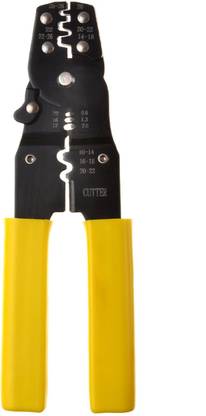

I have a few projects where I'd rather use crimpers instead of soldering. Any recommendations for a pair of ratcheting crimpers that are under $50? I used a pair of Harbor Freight ones years ago and when everything was lined up perfect they worked well, but I hated the fact that once you hit the first click on ratchet there was no release so you had to waste a connector if misaligned.
Will be using these AMP connectors mainly.

The no-release thing is a feature to stop muppets under-crimping.
Yeah, I figured. Have a suggestion for some decent crimpers? They are not something I'll use much, but I do have a couple projects that will require them.
They are called crimping pliers, see in your area.
I’ve never had good luck using those type of pliers. I’d be especially leery using them on high voltage connections.
I like the Thomas & Betts "Crimping Pliers A, B, C, PT Noninsulated Terminal & Splices" WT111M; similar (if not identical) forged pliers are available under other brand names including Klein. But there's a cheaper "imported" version by Pico, 365-11 which might be just fine. These have long handles for better pressure and control and forged steel for no flex.
I use the same crimp type for insulated and non-insulated terminals; there's a prevailing misconception that the "INS" position is for insulated terminals, but it was originally intended for terminals with a sleeve that crimps over the insulation. There's not much added risk in penetrating the insulating sleeve since these things are usually right next to exposed terminals.

Another vote for the Thomas & Betts. I’ve used their crimping pliers with two sizes of crimpers and a cutter, for 35 years. They’re made to last a lifetime of normal use. Bought mine from either the Snap-On or Mac Tools truck around ‘85.
Remove the sleeve before crimping. Take it up on the wire, and slide it in place after it is done.
$4 here, and the spring type tools are $12 and up, depending on lug or cable size.
These are handier and faster than the spring loaded crimpers, at least I think so.
