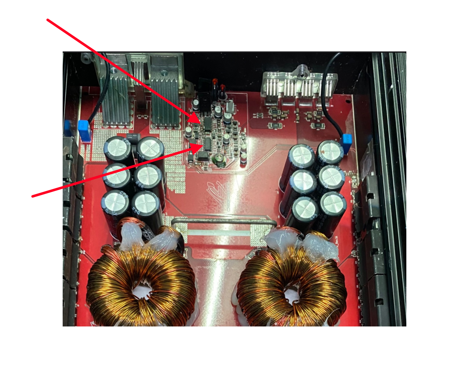

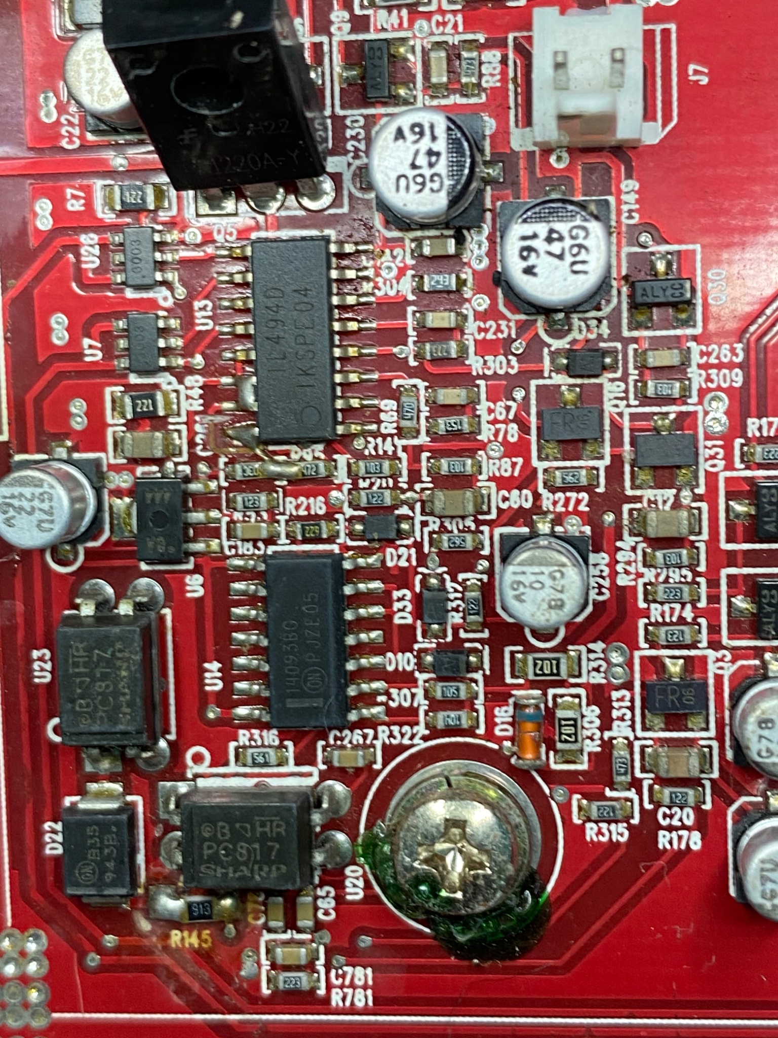

The CSD is referenced to pin 6. Black meter probe on 6. While you're there checking pin 5, check pin 1 as well.
Is it precisely 6.20v on both driver ICs?
Photo of area around the driver ICs? Preferably good enough to read the values of the various resistors.
