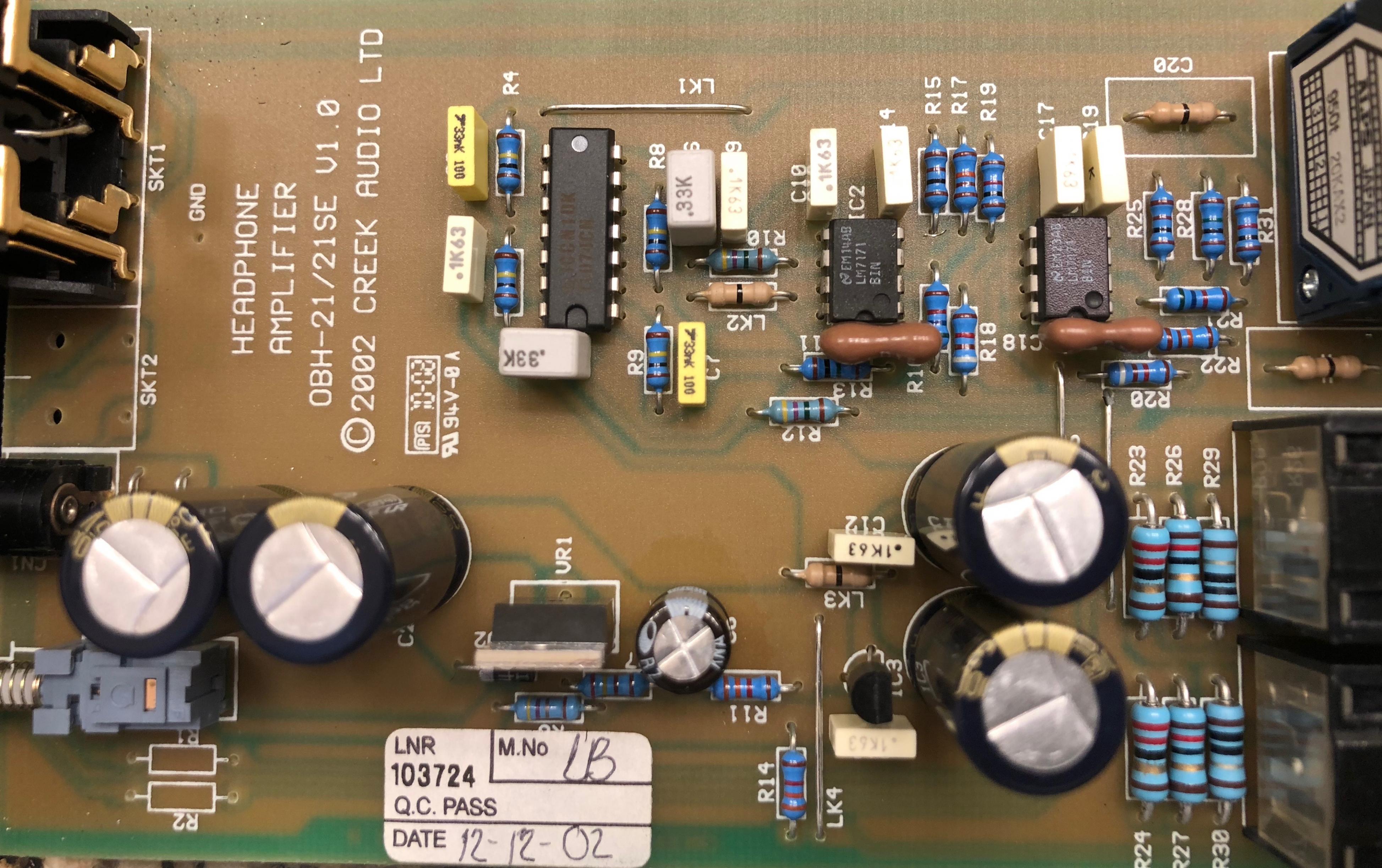

Creek OBH-21SE doesn't power up after I've connected the DAC output during music playing to the headphone amp's output (RCAs). What did I do?! Could you help me please?
photo of the circuit board below
P.S: Creek's engraved msg on the back of the amp: "No user serviceable parts inside" is very discouraging.

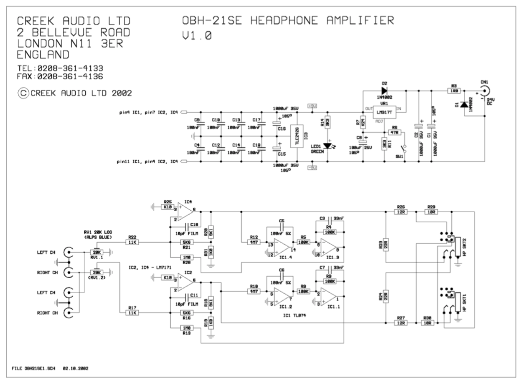

Merlin, thanks for your help so far. Unfortunately I don’t have the schematics.
The first advice I got outside the forum: “Likely, you've cooked the op amps for the input circuit, and depending on their failures maybe other parts in series as well”
I've measured the DC voltage from ground to Vcc+ and the Vcc- of the 14-pin TL04CN chip and there are completely dif values. As far as I understand the two voltages should have the same magnitude (within a tenth of a volt).
Is this correct?
Is this correct?
I've been trying to troubleshoot the 14-pin TL074CN.
Please let me know if I'm doing it correctly. Thank you

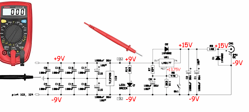

Measurements without power aren't necessary. It seems the power doesn't arrive to your IC, have you checked the voltage regulator VR1 as I said in post 4?
Sorry, I did and I found the following values:
DC Power on:
Ground to Vin: 0.48V
Ground to Vout: 0.49-0.51V
Ground to Vadj: 1.15V
DC Power on:
Yes, The DC source puts out 24V. I’ve measured it with a meter.
What value should it be, at Vin to ground is 0.48V?
What's your voltage regulator: LM3XX LT3XXX?
If powered ON you have 0.48V there is something broken between the input DC and the voltage regulator, first I check the diodes because I didn't see nothing burned.
