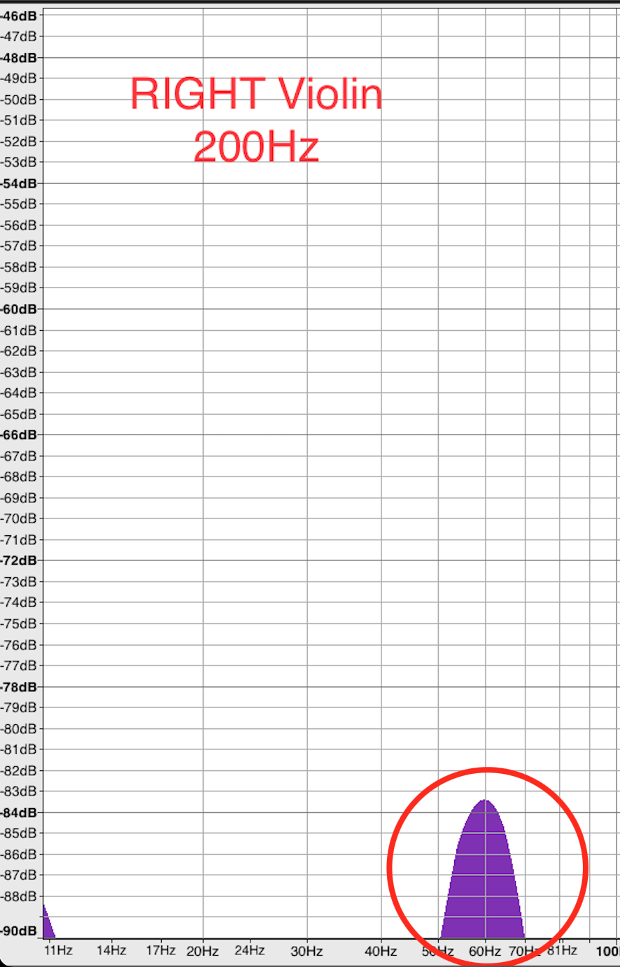

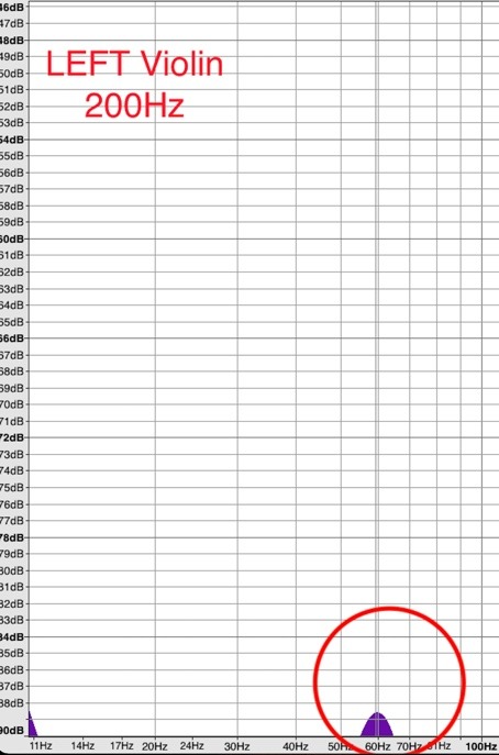

I just remembered the right channel has more 60Hz noise! In the FFT spectrum of harmonics I sent in the other post. There’s a 6dB difference between R and L channels. That’s a 2:1 voltage ratio. Could that be the cause of issues 1 and 2? The issue is more pronounced in the right channel? And 60hz can be attributed as system noise? It seems the question is what type of issues are acceptable per design in this amp?
