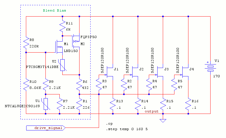

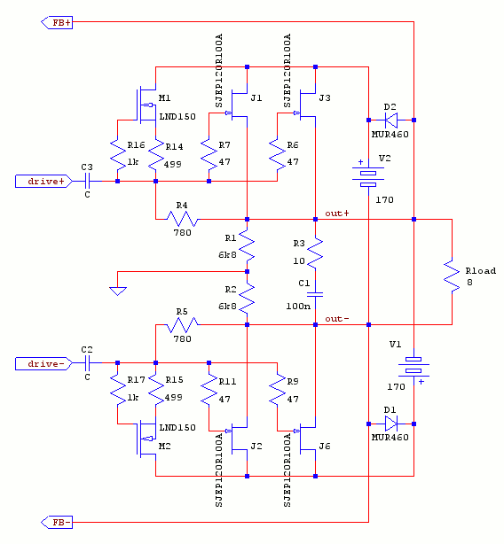

I'm planning a high power mono amplifier (~1.6kW@8ohms) for bass guitar using a direct-coupled floating bridge (circlotron) output stage to use with the new SemiSouth SJEP120R100A power JFETs.

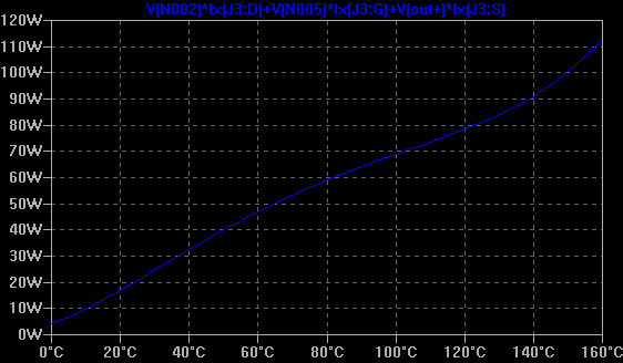

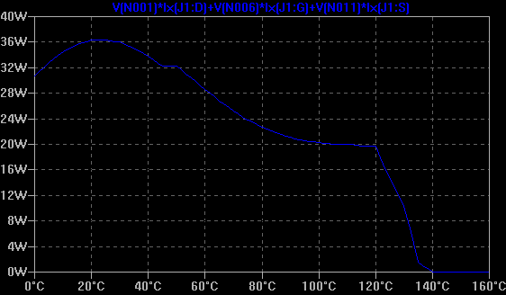

Now armed with an accurate spice model of the device, the device that I don't yet have in my possession, I see that gate threshold voltage drops with increase in temperature making it draw more idle current when it gets hotter.
I missed seeing it in the specs originally and assumed it had a neg tempco from the conductance curves. frack! That first chart is scary.
So I came up with this rather complex network around the bleed CCS (see below). Am I just fooling myself that this level of complexity using an NTC and a PTC will accomplish stable idle/overlap/bias current?
I know the real world will be different. heatsink temp a few cm away at the sensors will be different and I'll have to tune the circuit...
But just cause it looks exactly how I want it to behave in the sim, is this complexity too fragile even after tuning and build-to-build as I'm probably going to make four of these amps?
I think I need a topology where the bias current runs a separate path so I'm not assuming a given voltage will equal a given output current. inter-stage transformers are expensive, sigh..
