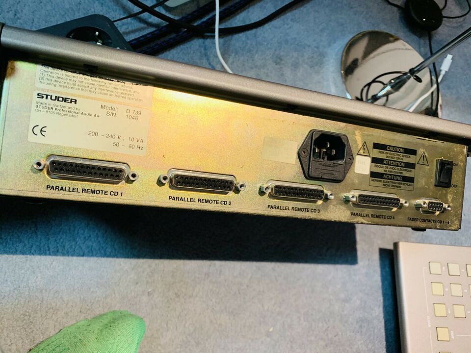

hi MAACO, no option for different voltage settings for the remote, you need a special order 120v transformer that gets installed in place of the 220v one... studer says these are not available any longer
leadbelly, heres a pic of theback of the remote
I welcome dissenting opinion, but I can't imagine a problem if the step-up transformer has isolation to the secondary.
To be extra conservative/cautious, you could power the remote without connecting interface cables and check for excessive leakage currents between the two chassis before committing to interconnection.

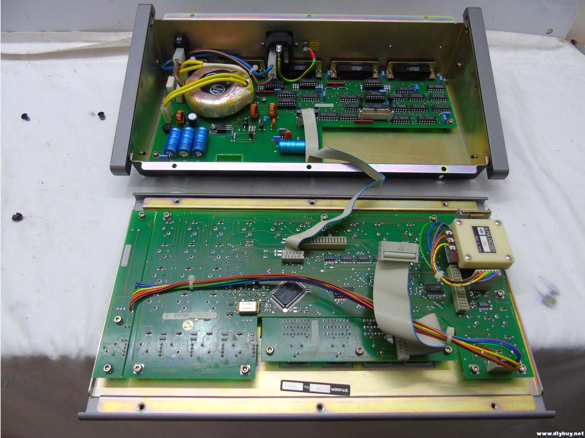

astouffer heres an inside view of the remote
like I was saying I'm probably waaaayyyy over thinking this, it has to work with a single stepup on the remote.... that parallel connector can't have any AC voltages on it that would be crazy! @leadbelly LOL! thanks fellas I'm gonna do it!!

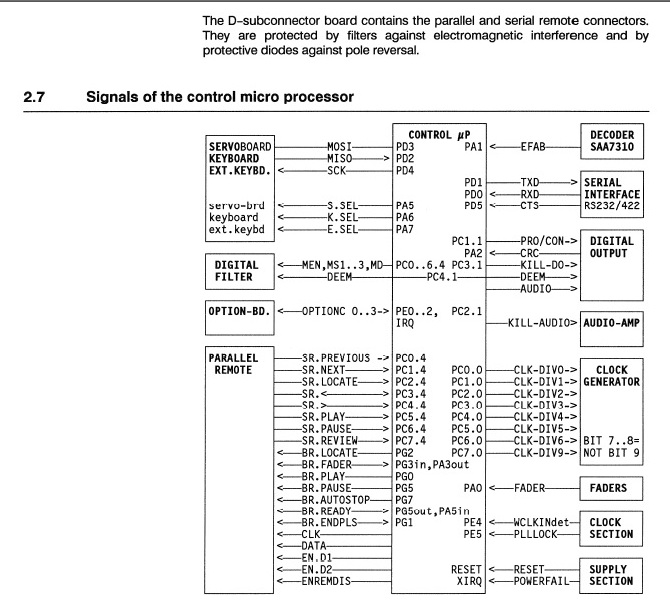

I found this in the player manual
It looks like an ordinary 9 volt secondary isolating transformer feeding a 5 volt regulator.
The types I normally see in UK have two 115V primaries that can be wired in series or parallel for operation on 115/230V.
There is a resin plug in the middle with a couple of threaded inserts for the fixing screws.
Just measure the two wires going into the board to confirm the voltage and buy a new transformer locally. There appears to be a 1 amp bridge rectifier next to the board header so you could use a smaller transformer. It looks a bit over rated.
It will be a lot cheaper than a step up unit and will save desk space.
Refugee1, googling around I see numerous replacements available (I didn't know they were so readily available, I really should go this route thanks) I'd still need to power it up at 230v so I could measure the secondaries 🙁 and I'd like to use her ASAP lol 🙂
