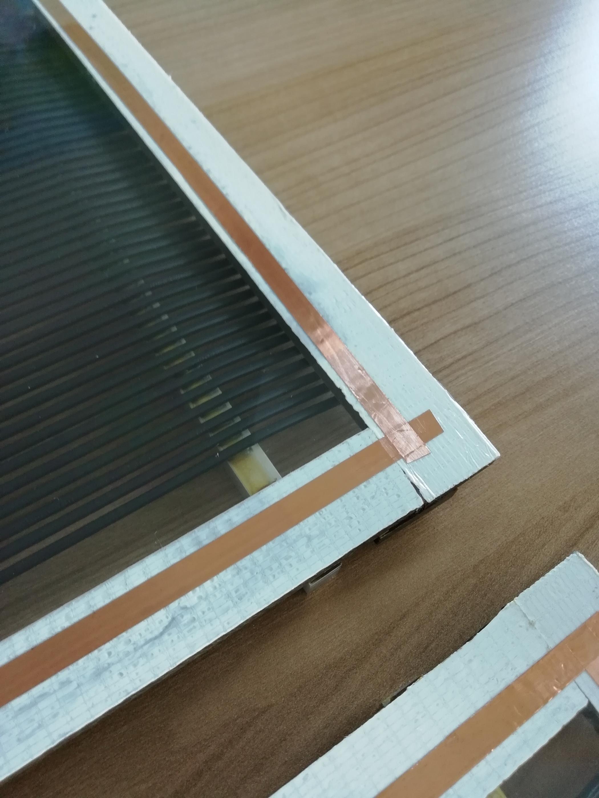

- Can you isolate where on the panel the crackling noise is coming from?
- What type of coating did you use, and what method are you using to connect the HV to the coating?

Yes there are 2 main places were the crackles seem to be coming from when i listen and look at the mylar.
Please see attached photo's of how i did HV connection.
I used ER coating in the right dilution. On the parts with the copper tape i used the coating undiluted to get the best contact between copper track and mylar. I didn't go over the edges of where the pertinax stops and i left the mylar in the corners free of coating.

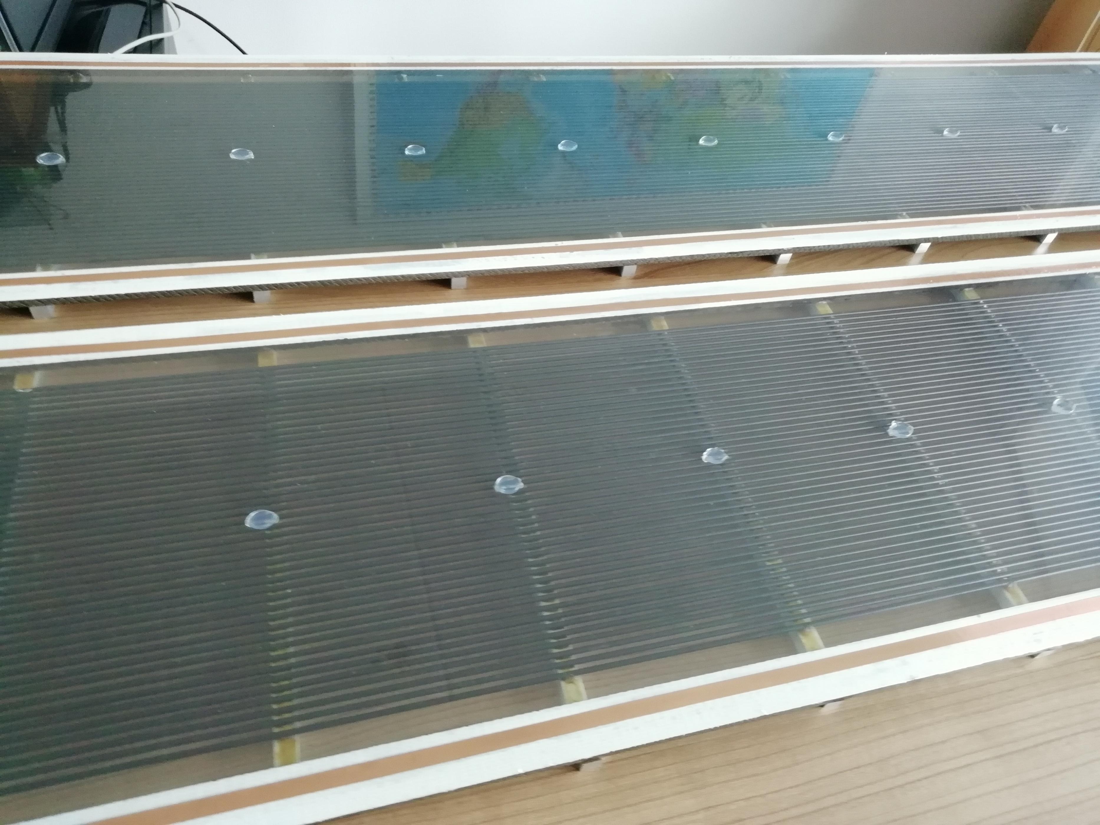

I did tension mylar with sticky tape and springweight-measure. After that i did new silicone dots.

Can it be that your film lost some tension and is sucked to the stator? That can be one of the reasons you hear a crackling sound from specific parts.

Are the 2 places causing the crackles out in the middle of the diaphragm? or around the perimeter or edge of the diaphragm near the copper tape. If out in the middle, MJ Dijkstra's suggestion of a diaphragm collapse to stator from loss of tension is probable. If around the edge, the contact between the copper tape and coating may have deteriorated in those places. I have had better luck using copper tape with conductive adhesive for higher bias voltages like the Audiostatics rather than try to bridge the gap from the sharp edge of the tape to the coating with another layer of undiluted coating.Yes there are 2 main places were the crackles seem to be coming from...
I used this copper tape wich has conductive adhesive, i guess that's the right tape to use?
3M™ EMI Copper Foil Shielding Tape 1181 | 3M United States
The crackling was coming from the side of the panel. Meanwhile i have started to dismantle the panels and do new mylar. I see no other option. It's not so much of a problem, i like this hobby 😀
I wanted to let you know that i finished repairing my ES 100's. They have 2um mylar now and i think it's an improvement in sound which is more fluid now (don't know a better word to describe it). Voices seem to have more of their own space.
The reason i started this, was the crackling and that is completely gone 🙂
