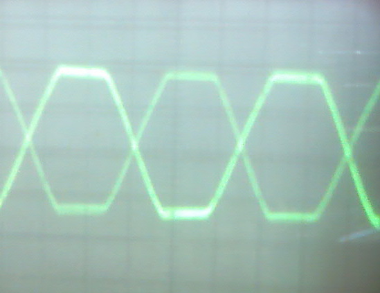

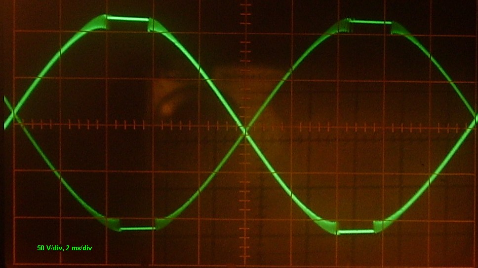

Attached an output waveform of a dedicated bass amplifier (at 50 Hz).
Hysteresis-based self oscillating amps suffers much more on this problem.

My 5 cents for cracling problem 🙂 During hard clipping, the power capacitor for high side driver does not becomes charge, so it can fully discharge and high side mosfet will close. Next cycle the capacitor becomes charge, but amplifier is still in clipping and the process repeats... So, try to increase high side power capacitor saying to 470 mf. In UCD prototype it is in position C5.
Alex
