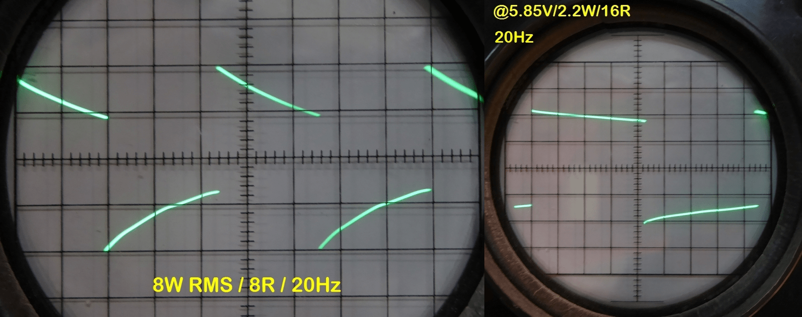

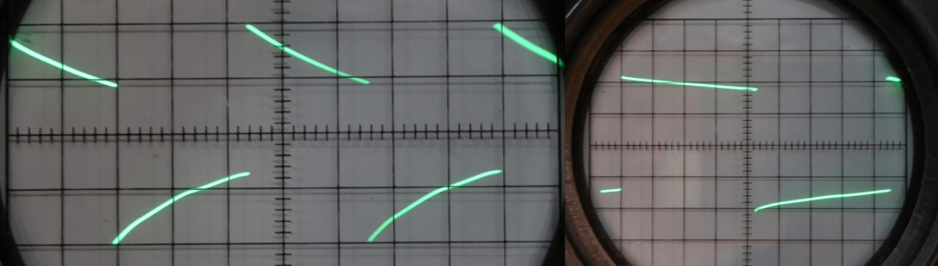

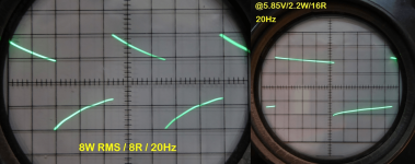

Even if Fc=1/2PiRC, the maximum µF is the best - assuming of course that the amp stability is not affected, or if you don't need to fight any rumble effect of some kind that would damage your speakers. A look to square waves will show you the benefits.As an example below, on an Audio Research SP3A1 preamplifer, at 20Hz, difference between 1µF and 4.7µF output capacitor :
Below, the coupling caps from phase inverter to power stage on my U-OTL amp are increased from 1µF at left, to 10µF at right. Output waveform @20hz/8R :
