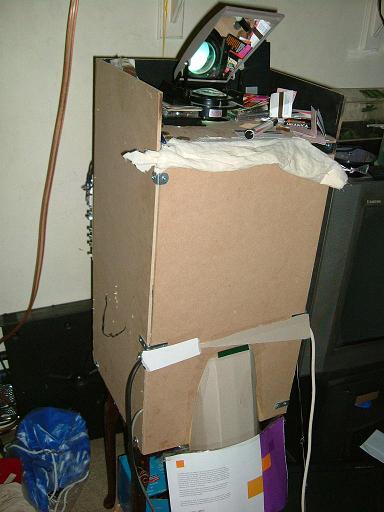

i have just learned something so i though i would share. i got a 15" pj with a vario triplet and i realised that the height of the triplet and the vario focal setting can have a dramatic impact on the screen size and quality. what i mean is..my pj is a standard type box have a look at the pic and what i did was to remove the triplet from its fixed position and raise it slighle by 5 cms or so..then when i adjused the lens the image on the wall got smaller and more birghter basically i made it long trow. before the screen was un-necessaryily massive.. also the same setup but reversed can obviously do the opposite.

this ones a bit mad so bare with..i was using a 250 w and condensor and the bulb was at a distance from the fresnel as normal.. but what i did was remove the condensor and move the light closer to the fresnel and build a refelctor out of tinfoil and tested the results.. i was quite shocked..its a bit hard for me to explain but i do alot of experiments and after months of testing this setup for me worked the best. any thoughts?
