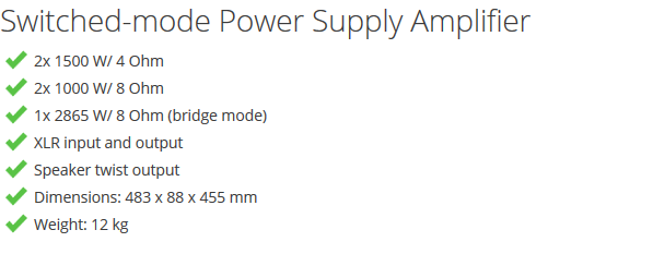

So far the T.amp TSA 4000 looks to be the best option (The only options for a new amp really being between T.amp TSA 4000, T.amp TSA 4-1300 & Behringer NX 6000), giving 2x 1000W 8ohm, 2x 1500W 4ohm or 1x 2865W to bridged 8ohm and weighing 12kg.

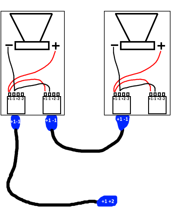

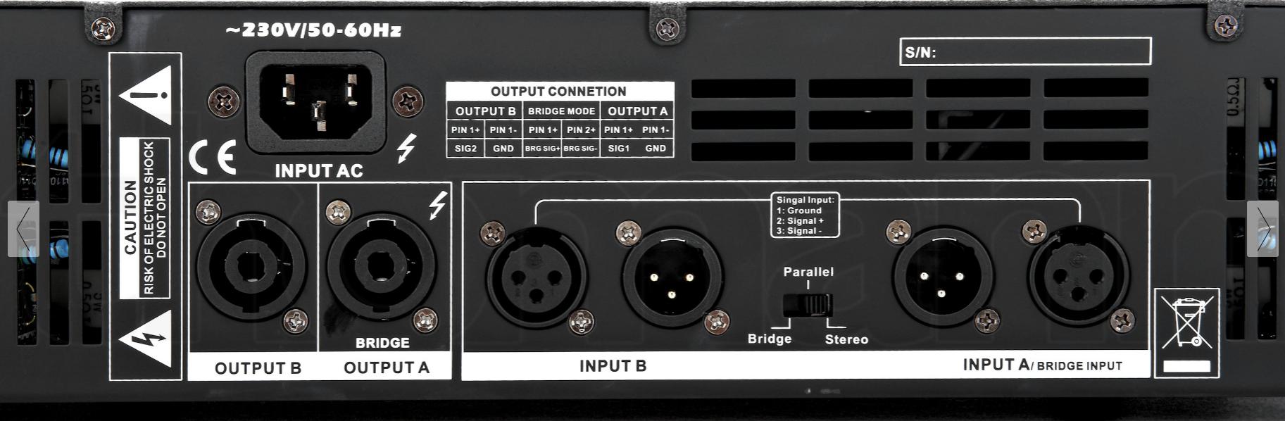

Wiring: A lot of amplifiers ask for a +1 & +2 connection when bridging. I've only used +1 & -1 cables so far. Do I only need to switch the end of one of my speakon cables (making it a +1 & +2 to a +1 &-1 cable, like in the first picture) for everything to be alright? Or would I have to re-wire the cabinets aswell.
TSA 4000 and bridging; The bridged option says to be 8ohm. My drivers are 8 ohm each, i've placed two speakon sockets on the back of each cabinet to allow for a parallel connection, making them 4ohm each when connected to each other. Will there be problems if I try to connect this 4ohm setup to the 8ohm bridge mode?
Since I want a bit more power than the rated RMS, How would I go about connecting these two cabs to either get a bridged connection or to get the 4ohm per channel to be able to receive 1500w @ 4 ohm per cab?
I am not really sure how to switch between the 8 and 4 ohm options from the amplifier, is it the parallel option?

Yes correct, but if you do that you should mark that end with some colored tape of something for easy identification. There are other ways to accomplish the same thing too such as make up a short adapter cable or add a patch panel to the amp rack.Wiring: A lot of amplifiers ask for a +1 & +2 connection when bridging. I've only used +1 & -1 cables so far. Do I only need to switch the end of one of my speakon cables (making it a +1 & +2 to a +1 &-1 cable, like in the first picture) for everything to be alright?
No they aren't 4ohms each when connected together they are 4ohms total.My drivers are 8 ohm each, i've placed two speakon sockets on the back of each cabinet to allow for a parallel connection, making them 4ohm each when connected to each other.
You can't, your only options are 2x 8ohms or 1x 4ohms or 16ohms.Since I want a bit more power than the rated RMS, How would I go about connecting these two cabs to either get a bridged connection or to get the 4ohm per channel to be able to receive 1500w @ 4 ohm per cab?
You don't, the load the amp sees is determined by the individual speaker impedances and how they are connected together.I am not really sure how to switch between the 8 and 4 ohm options from the amplifier

Bridge mode would not be suitable - you need a 2 ohm per channel rated amplifier for that.
If you want more power I would say buy a different amplifier with a higher 8 ohm rating.
Or buy 2 amplifiers.
Thanks for the answers, clarified some things up for me ! The TSA 4000 is definitely not the choice for me then, since its also quite important to keep my Behringer Ultradrives output slots to a minimum.
Glad to know I wouldnt have to change internal wiring for a bridged connection, but my drivers are definitely not suited for what I was trying to accomplish.
