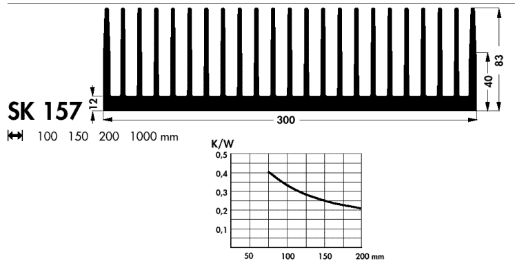

The k/w diagram of your heatsink is a little confusing.
Thermal resitance seems to drop near zero at 200 mm length.
Perhaps you might use this instead:
This was the alternative but with a much worse c/w, notice that the fins are ribbed of the sk271.
I read that the c/w curves are shown to be to optimistic (60 degrees above ambient)
But with a height of 150mm I should be able to get 0,20 C/W (hopefully

The cost of the Seifert KL-271 and de Fischer SK157 is the same, so (given the thicker base and the ribbed fins) the Seifert should be the better deal (I guess).

One should be enough for one channel of Aleph5 (about 70x2=140watts) even if you crank up the bias.
