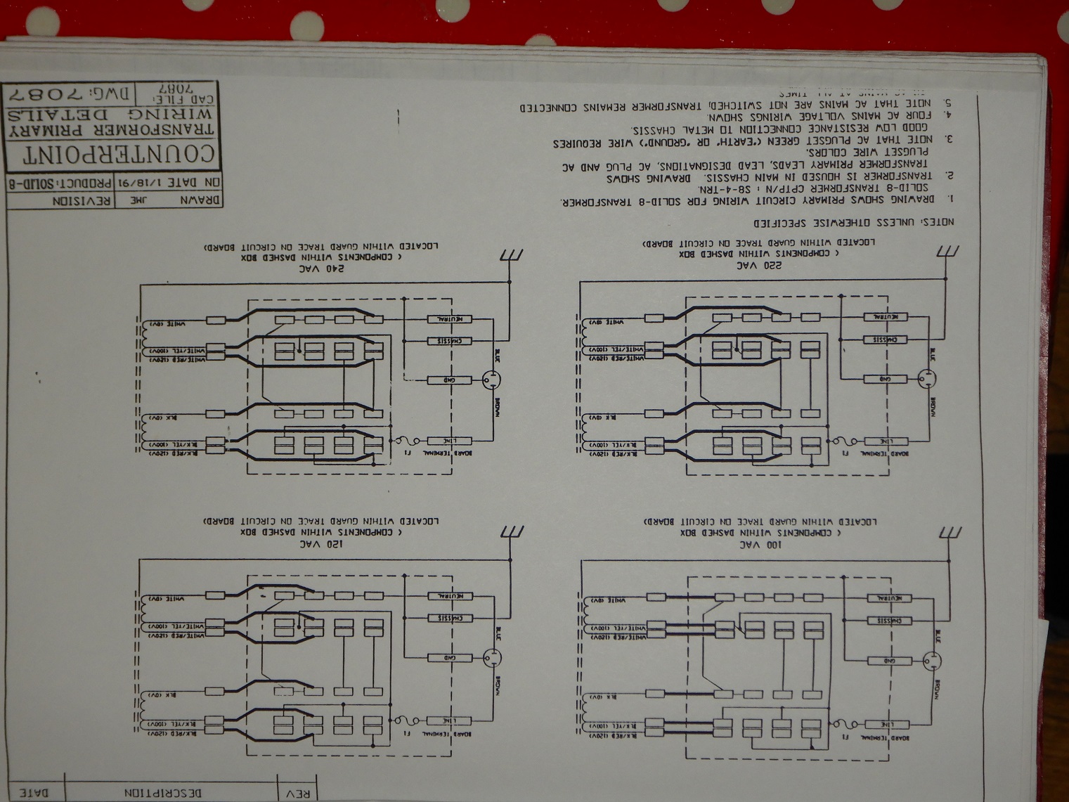

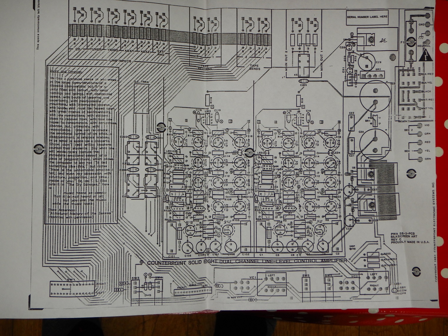

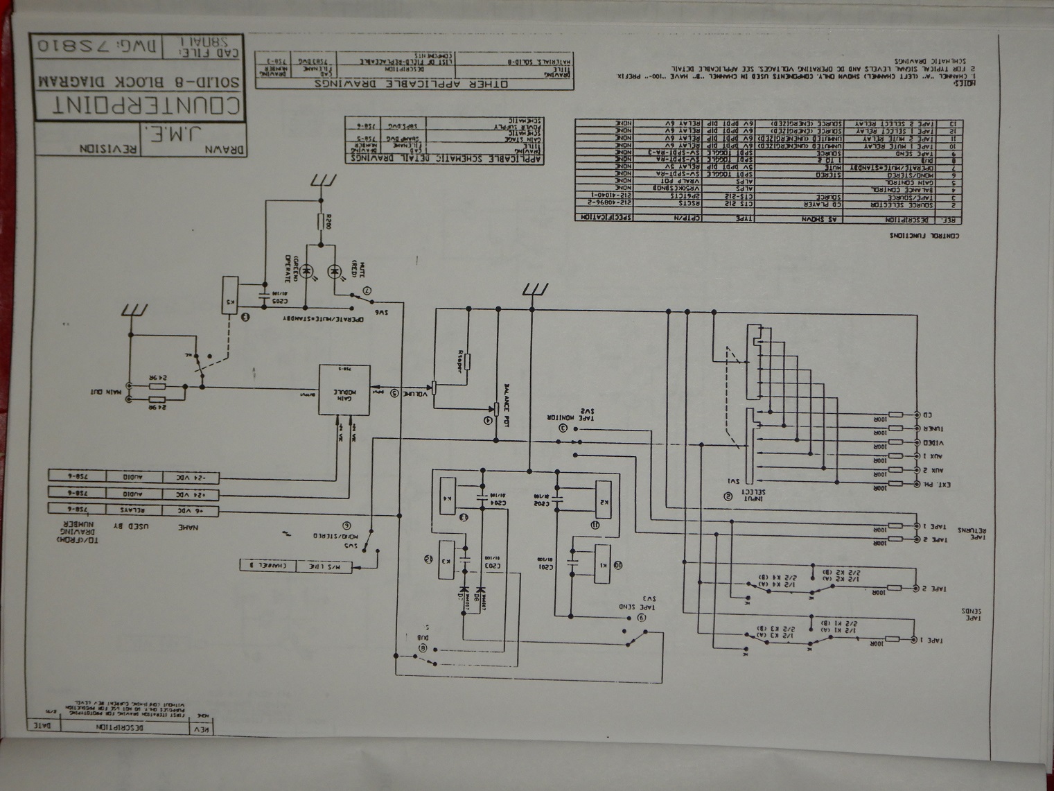

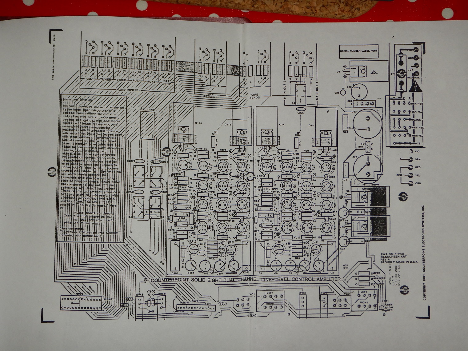

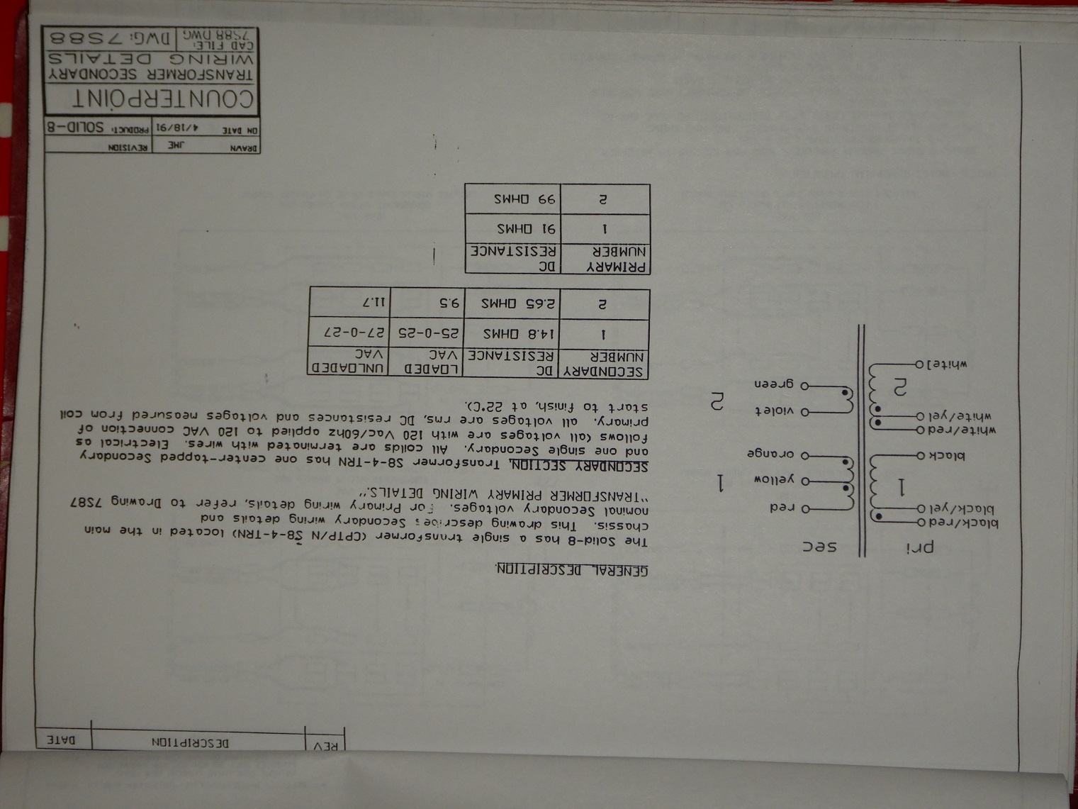

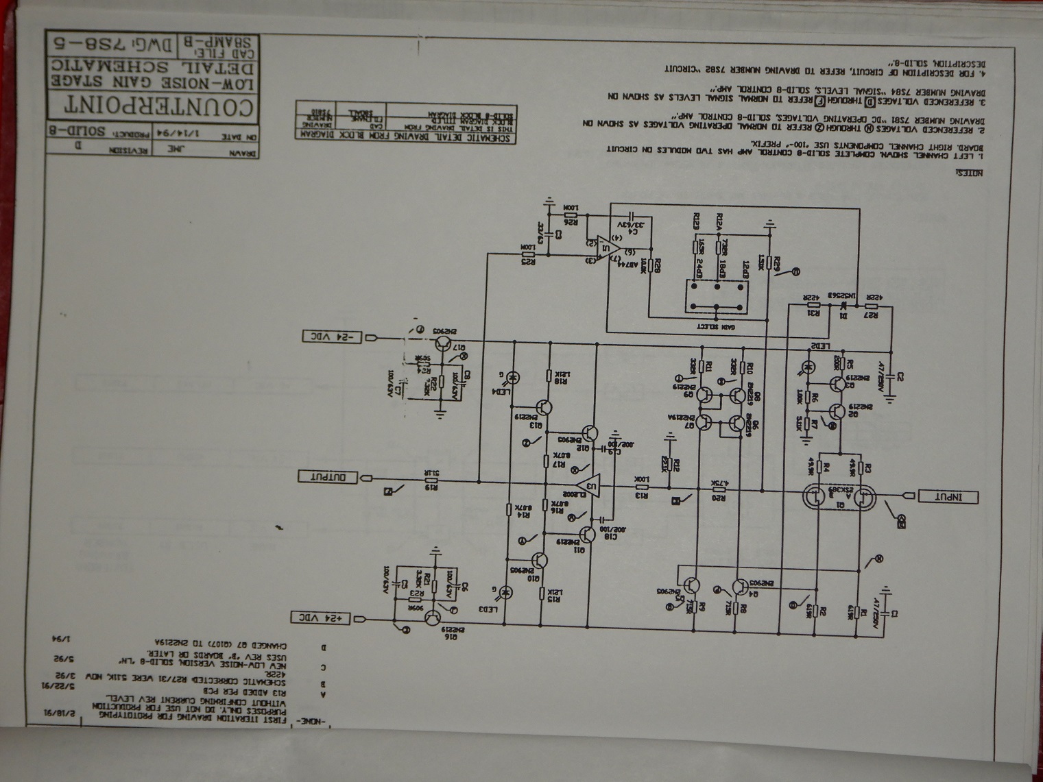

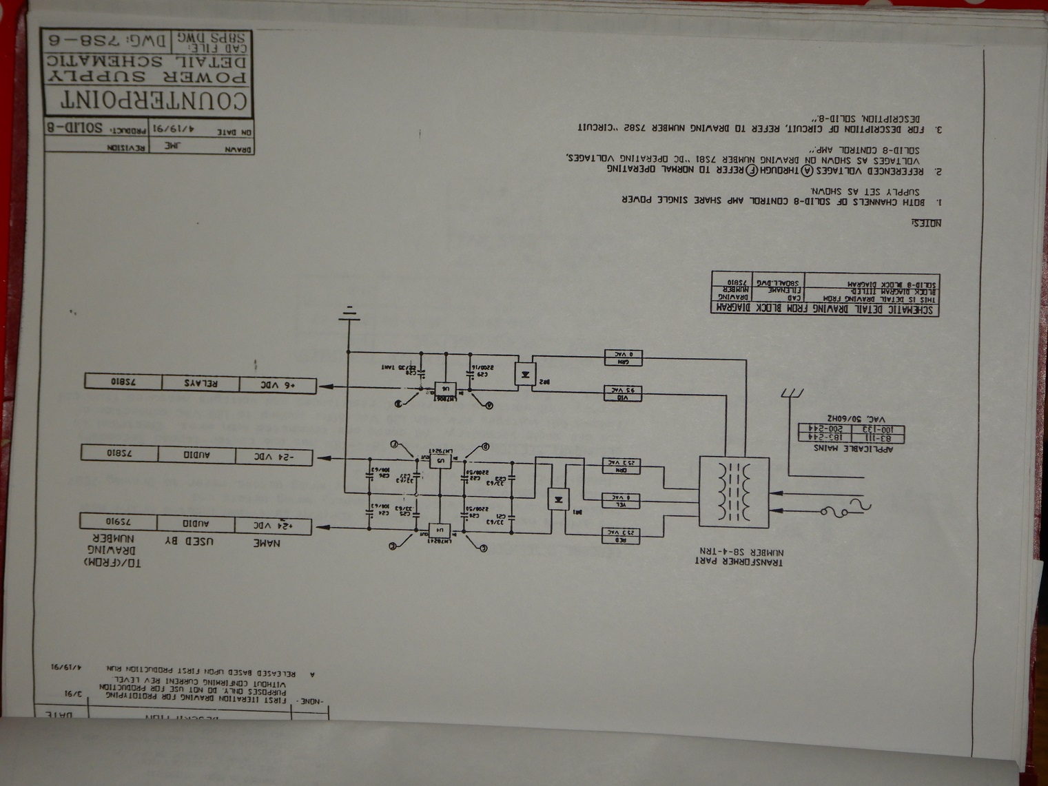

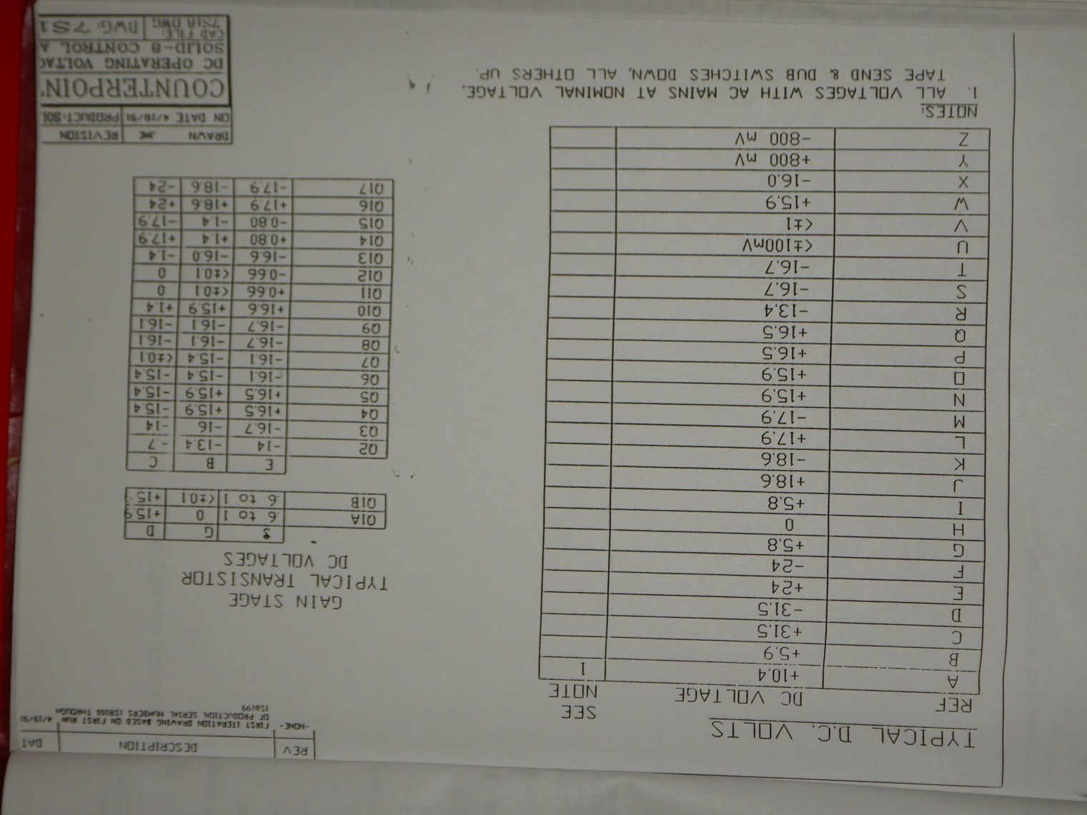

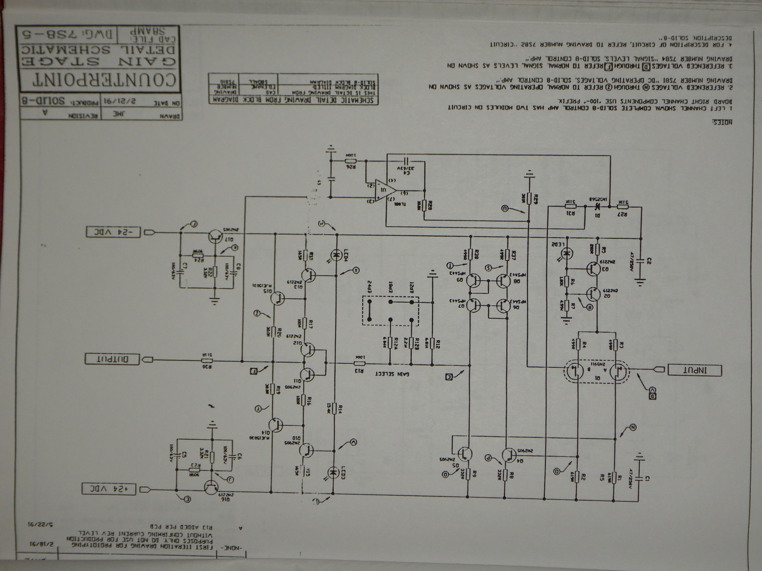

I'm the lucky owner of a Counterpoint HC818e. This is a multiroom preamp but based on the Solid 8.
My HC818e officially does not exist. The "e" stands for "export" and those units had encapsulated gainstages incorporated. My unit has completely open/naked boards (completely stuffed with goodies incl the opamps) and spare empty gainboard -PCB's for further experiments ? And…...a service manual of all HC818 things to know.
And in that manual are, because of its roots, also lots of Solid 8 knowledge.
I took pictures of those pages.
Hopefully this will help.
Sorry; a list of material was not included.
Please not the serial number of your Solid 8. (see my copied pages) as it wil hint if you're looking at Revision A or Revision C.
I changed three caps: one in the power section that drives the relays and two in the power section for the audio. But, I still get the random drop-outs. I monitored the voltage in the relay circuit over time, and, when the relays drop out, the voltage drops to zero for that circuit, usually for less than a second, but, sometimes almost five seconds.
I'm going to test the transformer to make sure it's operating properly. Next will be the bridge rectifier and voltage regulator in the relay power circuit. Seems odd behavior for a transformer, but, then, I'm not an electronics expert. At least the audio circuit seems good. The issues seem isolated to the relay circuit.
So - final post. Transformer was fine. Replaced the bridge rectifier and voltage regulator in the 6v circuit that drives the relays, and, no issues so far. Seems back to normal.
